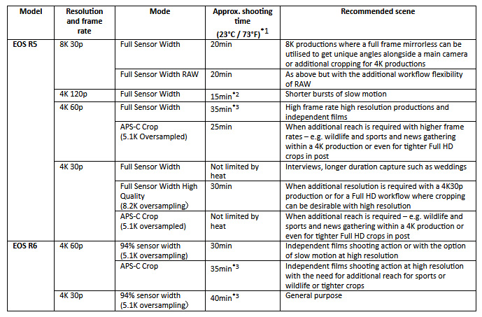

gt3rs Posted November 26, 2020 Share Posted November 26, 2020 34 minutes ago, dvcrn said: So I am doing some reading up on R5/R6 again (that time again :p) and saw that v1.1.1 apparently improved some of the issues on the r6. I have a few questions, So for 10bit, the cameras have to be in C-Log, right? Does C-Log have some weird limitations like on the EOS R, that you can't use certain modes such as aperture priority/shutter priority, or does that now work fine? The 4k crop on the r6 in 4k/60p mode, does it only apply to 60p mode? Are the other lower fps modes free from FF sensor crop or is it also slightly cropped? Also did anyone try to primarily use the r6 or r5 in aps-c mode instead of FF for video? I am curious how the overheating applies when in those sensor-cropped modes (if any overheating at all), and how the 4k (HQ on the R5?) looks. Wonder how EF-S glass would do on it, or maybe using a speed-booster 🤔 Then about the 1080p -- from what I read, there is no way to shoot 1080p @ 10-bit in either camera, also the 1080p is I think line-skipped and not so good? So probably going 4k and exporting to 1080p might be the better way here. Still don't fully understand the HDR PQ mode. Could you shoot in that internal and still export to rec709? Is 10bit HDR PQ still ok, or does it more compare to 8bit rec709? Also I completely forgot about this, but the eos r5/r6 still have the 30 minutes hard recording limit! How come I can't find this mentioned everywhere 🙀 I can only speak about the R5 as I don't have a R6 (I think there are to many limitations for video) 10 Bit CLog (apparently canon has promised to offer also CLog3 in a future firmware update, but I would count on it when I see it) does have one major limitation that Zebras are not available in CLog, other minors limitations: you cannot take a screengrab in the camera, starts at 400 ISO (is normal) but you can go down to 100 (loosing a bit DR). R5 crop mode does not overheats and yes you can mount an EF-S lens (you may have some vignetting with some lenses I think but I don't have any EF-S lens). I did use a couple of times the crop mode to gain reach and deliver directly the file, normally I prefer to use 8k and punch in as you have more freedom. Speed-booster should work too. The Canon official one is not official supported on the R5. But the 4k LQ is still very good so really not sure why people are making such a big fuss about it. Yes compared to 4K oversampled is less sharp but point me out another camera at any price that has the same sharpness as 4k oversampled on the R5.... not even the C500 II has the same sharpness... 1080p never used and I don't plan to use it so I have no idea 30min limitation is on all DSLR/Mirrorless of Canon, and yes this is a true cripple hammer for sure as the European tax does not exist anymore. dvcrn 1 Link to comment Share on other sites More sharing options...
dvcrn Posted November 26, 2020 Share Posted November 26, 2020 Found this chart here that has a comparison for the different modes (I think it's from Canon?) It looks like there is overheating after all in APS-C mode, just not when using the LQ mode, hmm.. Also seeing overheating in crop modes on the R6 is a bit surprising. It doesn't even list a mode that is free from overheating Link to comment Share on other sites More sharing options...
gt3rs Posted November 26, 2020 Share Posted November 26, 2020 4 minutes ago, dvcrn said: Found this chart here that has a comparison for the different modes (I think it's from Canon?) It looks like there is overheating after all in APS-C mode, just not when using the LQ mode, hmm.. Also seeing overheating in crop modes on the R6 is a bit surprising. It doesn't even list a mode that is free from overheating Not sure what you are reading? R5 does not overheats in 4k 30 LQ and 4k 30 APSC, there is no LQ in APSC..... The above table is correct. R6 is not surprising is there since day one..... dvcrn 1 Link to comment Share on other sites More sharing options...

Mark Romero 2 Posted December 13, 2020 Share Posted December 13, 2020 Maybe I am confused again 🤔 I could have sworn I read / heard somewhere that the R6 has a SIGNIFICANT crop when shooting 4K 60p (like 1.5X or something). But the chart posted a few posts up says you get 94% of the sensor width. Can anyone confirm??? And does anyone have any insight on the dynamic range (and low light performance) of the CLOG in the R6 compared to the VLOG of the Panasonic S1? Thanks in advance, and apologies if i am asking questions with obvious answers. 🙏 Link to comment Share on other sites More sharing options...
TheBoogieKnight Posted December 14, 2020 Share Posted December 14, 2020 7 hours ago, Mark Romero 2 said: Maybe I am confused again 🤔 I could have sworn I read / heard somewhere that the R6 has a SIGNIFICANT crop when shooting 4K 60p (like 1.5X or something). But the chart posted a few posts up says you get 94% of the sensor width. Can anyone confirm??? And does anyone have any insight on the dynamic range (and low light performance) of the CLOG in the R6 compared to the VLOG of the Panasonic S1? Thanks in advance, and apologies if i am asking questions with obvious answers. 🙏 Some YT tests of the R5 and R6 found the maximum under CLOG was 11 usable stops. The S1 if I remember rightly using the same parameters was 12.7 stops so a massive difference. The R5 does have the advantage of RAW and while there's actually less stops of usable DR, with noise reduction you'll almost certainly get more than you can out of CLOG although I haven't seen any tests investigating how much more. Mark Romero 2 1 Link to comment Share on other sites More sharing options...
