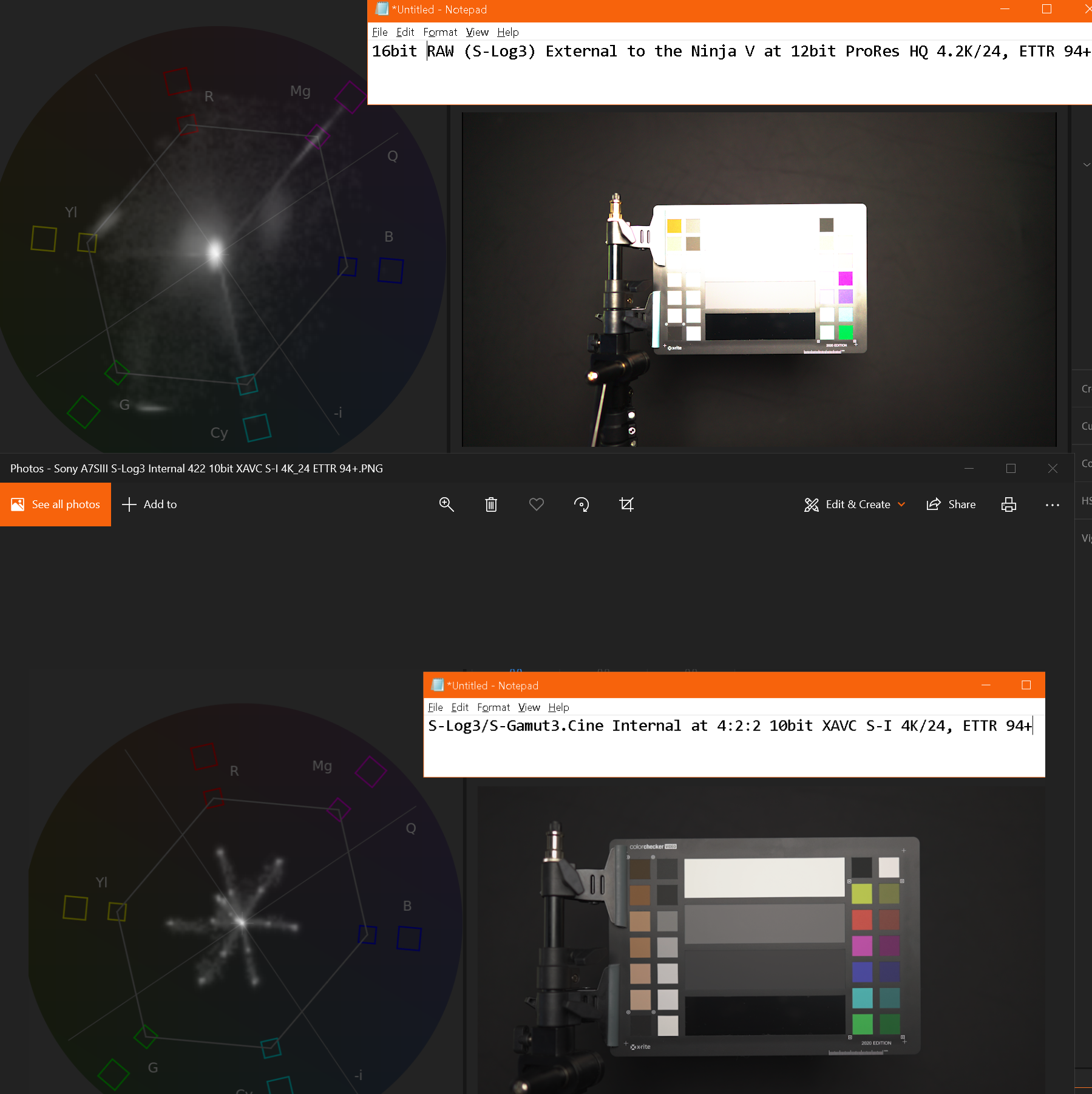

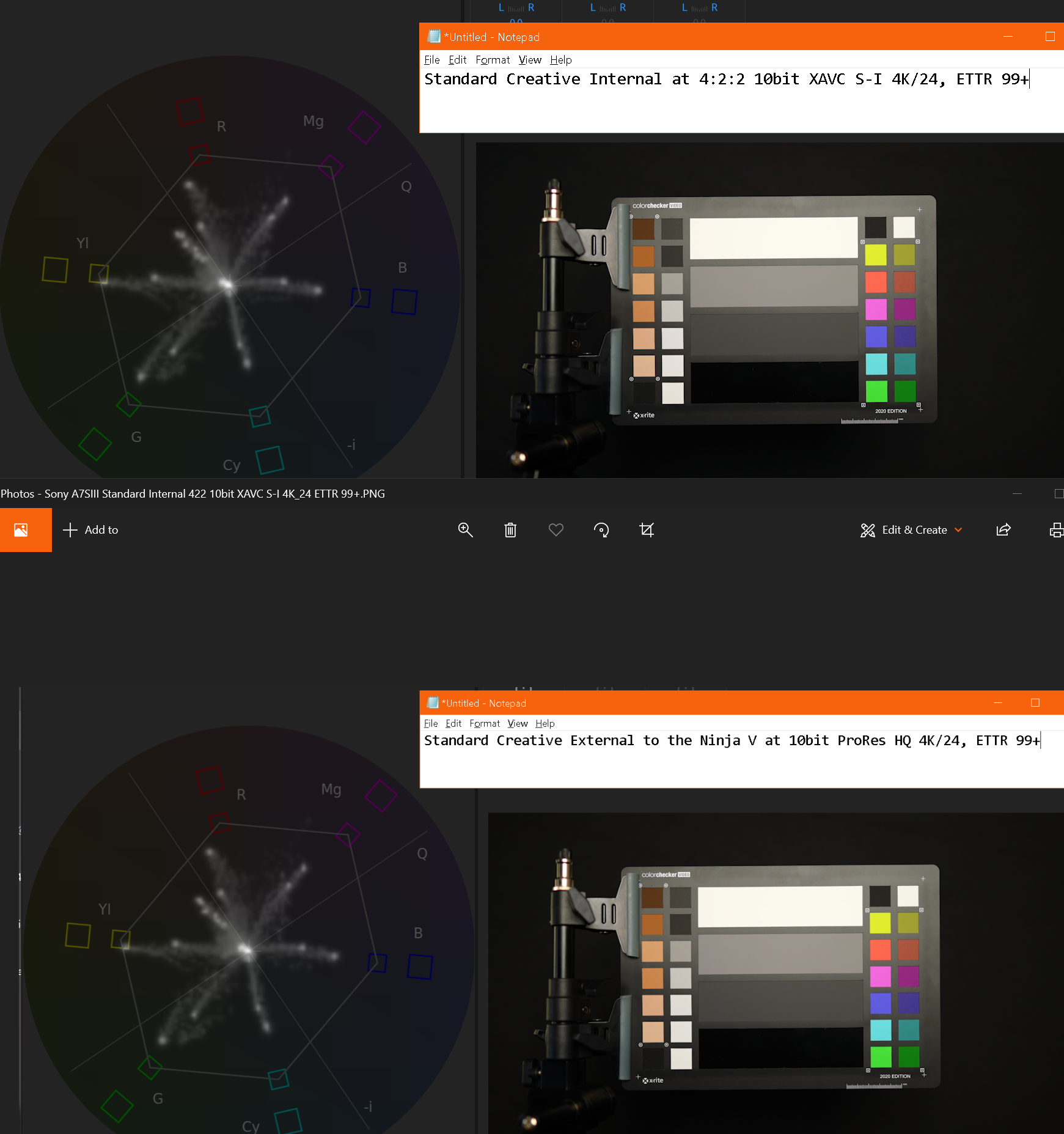

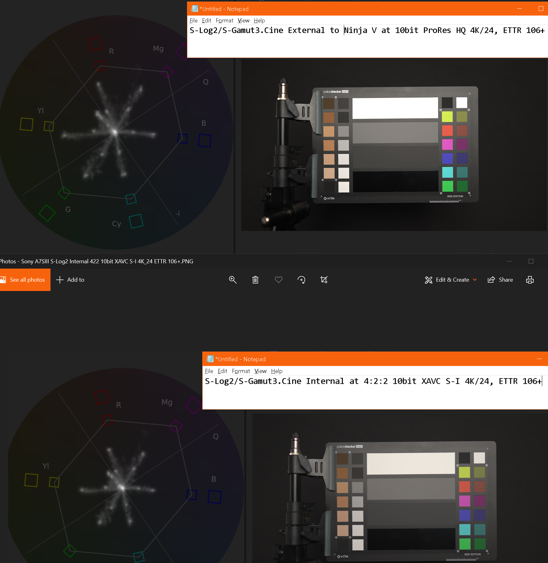

Hangs4Fun Posted September 29, 2020 Share Posted September 29, 2020 4 hours ago, Rob6 said: Are there any examples of Raw video out of the a7s3 yet? Is the quality in raw any more detailed compared to internal? Thanks! funny you mention that. I JUST finished testing the Leeming LUT's with S-Log3, S-Log2, and Standard Creative Look. In each case, I recorded internally in XAVC S-I 4:2:2 10bit and externally at 10bit ProRes HQ. I did one test with S-Log3 RAW out to ProRes RAW HQ. I exposed using Paul Leeming's latest recommendation of ETTR -1 from the already published numbers, so S-Log3 ETTR 94+, S-Log2 ETTR 106+, and Standard ETTR 99+. Something very odd happened in Premiere when using the RAW footage (using the latest Apple ProRes RAW drivers) and the S-Log3 Leeming LUT. In the Ninja V, the 16bit RAW from the A7SIII looked AMAZING (and was using the S-Log3 Leeming LUT for viewing). The internal footage came out the best of the bunch of above as far as dynamic range and color depth, but the RAW ended up being VERY over exposed. Now, I am sure it was just my inexperience working with RAW. Maybe there is something else I am supposed to do in Premiere and applying the corrective Leeming LUT made it worse. But considering the image looked so perfect on the Ninja V using the Leeming LUT as a monitoring LUT, and exposing exactly per instructions, I have to think it is something in how I am bringing it into my computer and/or Premiere? Any way, here is my results (I am starting a separate post with full details on the testing conditions and such, this is just a quick share) BTW, I also did some noise tests with lens cap and black velvet covering the lens to see the noise floor at 1/50, f/1.4, ISO 640 in the above 3 profiles In the photos below, the top is the external ProRes (one RAW HQ and the last 2 HQ) results and lower is internal XAVC S-I 4:2:2 10bit S-Log3 (top external ProRes RAW HQ, bottom internal XAVC S-I) S-Log2 (top external ProRes HQ, bottom internal XAVC S-I) Standard (top external ProRes HQ, bottom internal XAVC S-I) Juank 1 Link to comment Share on other sites More sharing options...

Llaasseerr Posted September 30, 2020 Share Posted September 30, 2020 22 hours ago, Hangs4Fun said: funny you mention that. I JUST finished testing the Leeming LUT's with S-Log3, S-Log2, and Standard Creative Look. In each case, I recorded internally in XAVC S-I 4:2:2 10bit and externally at 10bit ProRes HQ. I did one test with S-Log3 RAW out to ProRes RAW HQ. I exposed using Paul Leeming's latest recommendation of ETTR -1 from the already published numbers, so S-Log3 ETTR 94+, S-Log2 ETTR 106+, and Standard ETTR 99+. Something very odd happened in Premiere when using the RAW footage (using the latest Apple ProRes RAW drivers) and the S-Log3 Leeming LUT. In the Ninja V, the 16bit RAW from the A7SIII looked AMAZING (and was using the S-Log3 Leeming LUT for viewing). The internal footage came out the best of the bunch of above as far as dynamic range and color depth, but the RAW ended up being VERY over exposed. Now, I am sure it was just my inexperience working with RAW. Maybe there is something else I am supposed to do in Premiere and applying the corrective Leeming LUT made it worse. But considering the image looked so perfect on the Ninja V using the Leeming LUT as a monitoring LUT, and exposing exactly per instructions, I have to think it is something in how I am bringing it into my computer and/or Premiere? Any way, here is my results (I am starting a separate post with full details on the testing conditions and such, this is just a quick share) BTW, I also did some noise tests with lens cap and black velvet covering the lens to see the noise floor at 1/50, f/1.4, ISO 640 in the above 3 profiles In the photos below, the top is the external ProRes (one RAW HQ and the last 2 HQ) results and lower is internal XAVC S-I 4:2:2 10bit S-Log3 (top external ProRes RAW HQ, bottom internal XAVC S-I) S-Log2 (top external ProRes HQ, bottom internal XAVC S-I) Standard (top external ProRes HQ, bottom internal XAVC S-I) It looks like Premiere is interpreting the raw footage as linear gamma 1.0, which is correct, but Premiere isn't used to this kind of thing. On top of that, the LUT you added is expecting an S-log3 input image so it has only increased the crazy contrast. I've so far used Scratch to test out raw from this cam and it allows interpretation on ingest to a log format which naturally should be s-log3/s.gamut3., which is how the Ninja V seems to be displaying it probably because it recognises a flag in the footage that it's from this camera. To work with linear floating point wide gamut files, which are essentially HDR without a log transform to compress to a 0-1 range, you need to move to Nuke, Scratch or Resolve which have better colour management than Premiere. However, there may be some way to transform to log on import to Premiere. You need to add a LUT to transform the Raw file to slog3/sgamut3, then add your other LUT after that. It could work as expected after that. But from memory, Premiere can only work with Rec.709 primaries so there may be some gamut clipping. The good thing is that you have the internally recorded log version as a reference and the raw transformed to log should match very closely, but with more fidelity because it's raw. Meaning no chroma subsampling, 2 more bits and fingers crossed a little more dynamic range. Link to comment Share on other sites More sharing options...
