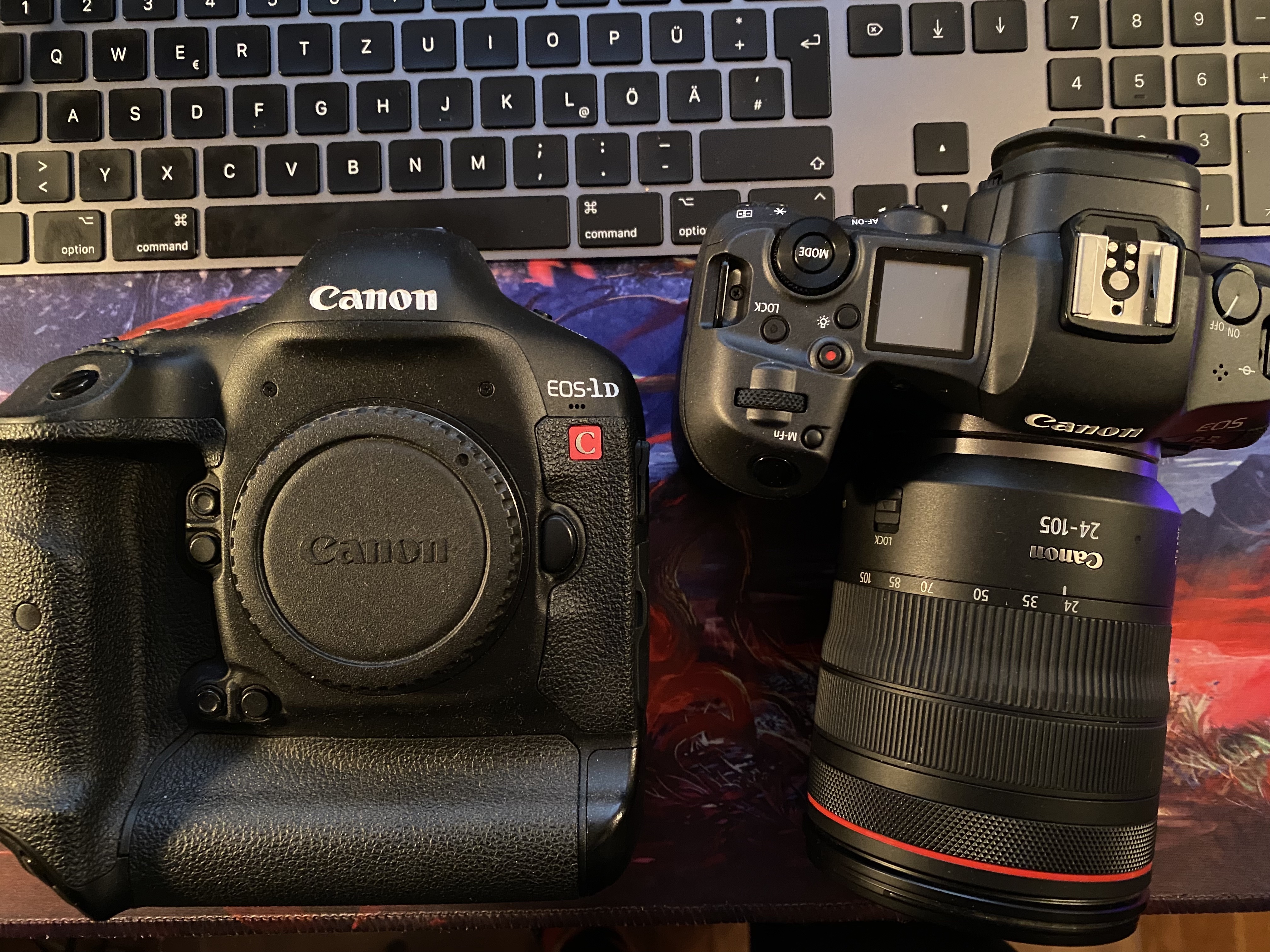

Administrators Andrew Reid Posted September 29, 2020 Administrators Share Posted September 29, 2020 I would do, but I left my 1D C in Berlin. Maybe some other time. I am pretty sure the colour science is very similar on both. PannySVHS, Rob6 and Juank 3 Link to comment Share on other sites More sharing options...

Administrators Andrew Reid Posted January 23, 2021 Administrators Share Posted January 23, 2021 Let's find out... Adept, Juank, Katrikura and 3 others 6 Link to comment Share on other sites More sharing options...
