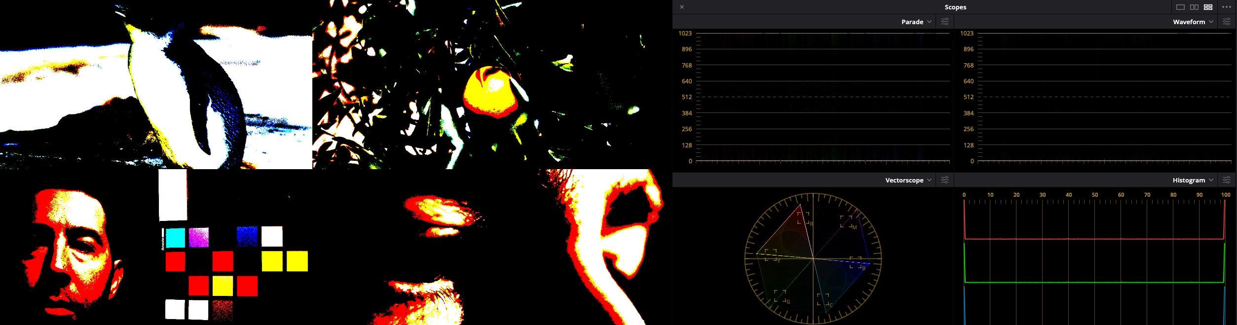

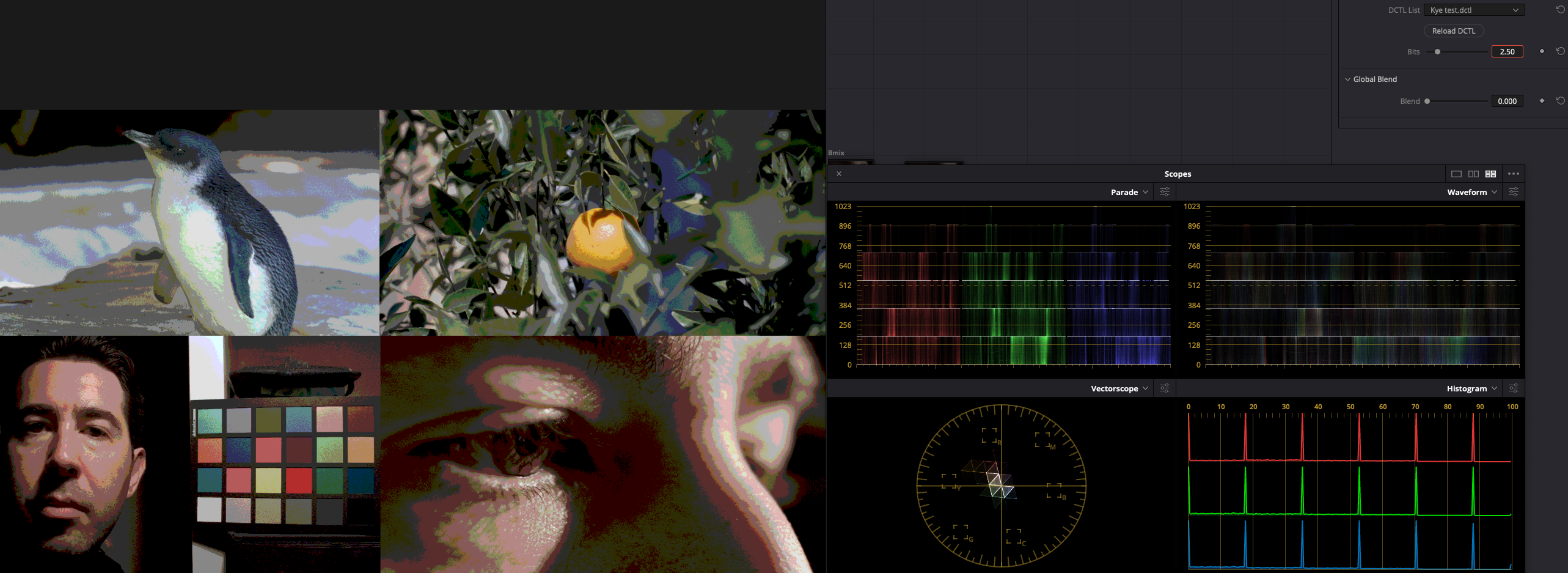

kye Posted October 11, 2020 Author Share Posted October 11, 2020 21 hours ago, kye said: Ok, what do we think about how thick these images are? vs vs vs No thoughts on how these images compare? It's not a trick.. Link to comment Share on other sites More sharing options...
kye Posted October 11, 2020 Author Share Posted October 11, 2020 or how about these... are these super thick? Link to comment Share on other sites More sharing options...
fuzzynormal Posted October 11, 2020 Share Posted October 11, 2020 3 hours ago, kye said: thoughts on how these images compare? Not for me, because they look the same, or are so similar to not matter to my eye. Maybe I missed something more obvious? Link to comment Share on other sites More sharing options...
kye Posted October 11, 2020 Author Share Posted October 11, 2020 2 hours ago, fuzzynormal said: Not for me, because they look the same, or are so similar to not matter to my eye. Maybe I missed something more obvious? That's what I thought - that there wasn't much visible difference between them and so no-one commented. What's interesting is that I crunched some of those images absolutely brutally. The source images were (clockwise starting top left) 5K 10-bit 420 HLG, 4K 10-bit 422 Cine-D, and 2x RAW 1080p images, which were then graded, put onto a 1080p timeline and then degraded as below: First image had film grain applied then JPG export Second had film grain then RGB values rounded to 5.5bit depth Third had film grain then RGB values rounded to 5.0bit depth Fourth had film grain then RGB values rounded to 4.5bit depth The giveaway is the shadow near the eye on the bottom-right image which at 4.5bits is visibly banding. What this means is that we're judging image thickness via an image pipeline that isn't that visibly degraded by having the output at 5 bits-per-pixel. The banding is much more obvious without the film grain I applied, and for the sake of the experiment I tried to push it as far as I could. Think about that for a second - almost no visible difference making an image 5bits-per-pixel at a data rate of around 200Mbps (each frame is over 1Mb). Ricardo Constantino 1 Link to comment Share on other sites More sharing options...

Geoff CB Posted October 12, 2020 Share Posted October 12, 2020 1 hour ago, kye said: Actually, the fact that an image can be reduced to 5bits and not be visibly ruined, means that the bits aren't as important as we all seem to think. A bit-depth of 5bits is equivalent to taking an 8-bit image and only using 1/8th of the DR, then expanding that out. Or, shooting a 10-bit image and only exposing using 1/32 of that DR and expanding that out. Obviously that's not something I'd recommend, and also considering I applied a lot of noise before doing the bit-depth reduction, but the idea that image thickness is related to bit-depth seems to be disproven. I'm now re-thinking what to test next, but this was an obvious thing and it turned out to be wrong. But those images were not captured in 5-bit, that is an indicator for final compression, it is NOT an indicator of quality of it as the capture format. Link to comment Share on other sites More sharing options...
kye Posted October 13, 2020 Author Share Posted October 13, 2020 8 hours ago, Geoff CB said: But those images were not captured in 5-bit, that is an indicator for final compression, it is NOT an indicator of quality of it as the capture format. The question we're trying to work out here is what aspects of an image make up this subjective thing referred to by some as 'thickness'. We know that high-end cinema cameras typically have really thick looking images, and that cheap cameras typically do not (although there are exceptions). Therefore this quality of thickness is related to something that differs between these two scenarios. Images from cheap cameras typically have a range of attributes in common, such as 8-bit, 420, highly compressed, cheaper lenses, less attention paid to lighting, and a range of other things. However, despite all these limitations, the images from these cameras are very good in some senses. A 4K file from a smartphone has a heap of resolution, reasonable colour science, etc, so it's not like we're comparing cinema cameras with a potato. This means that the concept of image thickness much be fragile. Otherwise consumer cameras would capture it just fine. If something is fragile, and is only just on the edges of being captured, then if we take a thick image and degrade it in the right ways, then the thickness should evaporate with the slightest degradation. The fact I can take an image and output it at 8-bits and at 5-bits and for there not to be a night-and-day difference then I must assume one of three things: the image wasn't thick to begin with it is thick at both 8-bits and 5-bits and therefore bit-depth doesn't matter than much it is thick at 8-bit but not at 5-bits and people just didn't notice, in a thread especially about this I very much doubt that it's #3, because I've had PMs from folks who I trust saying it didn't look much different. Maybe it's #1, but I also doubt that, because we're routinely judging the thickness of images via stills from YT or Vimeo, which are likely to be 8-bit, 420, and highly compressed. The images of the guy in the car that look great are 8-bit. I don't know where they came from, but if they're screen grabs from a streaming service then they'll be pretty poor quality too. Yet they still look great. I'm starting to think that maybe image thickness is related to the distribution of tones within a HSL cube, and some areas being nicer than others, or there being synergies between various areas and not others. tupp 1 Link to comment Share on other sites More sharing options...
