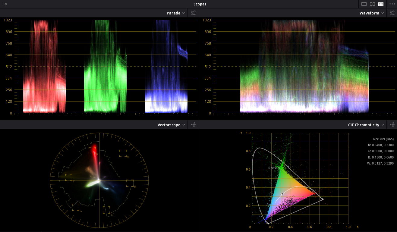

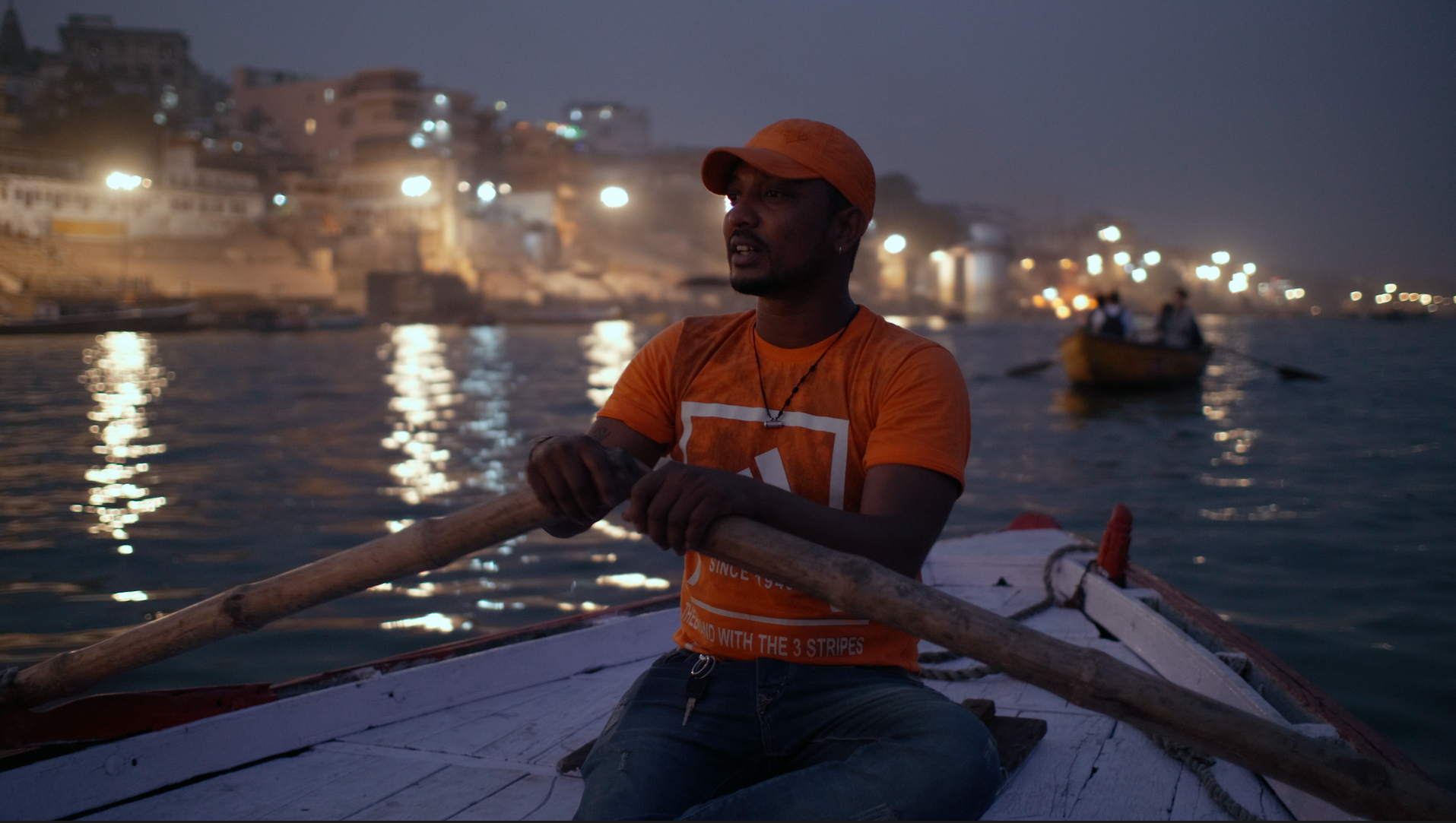

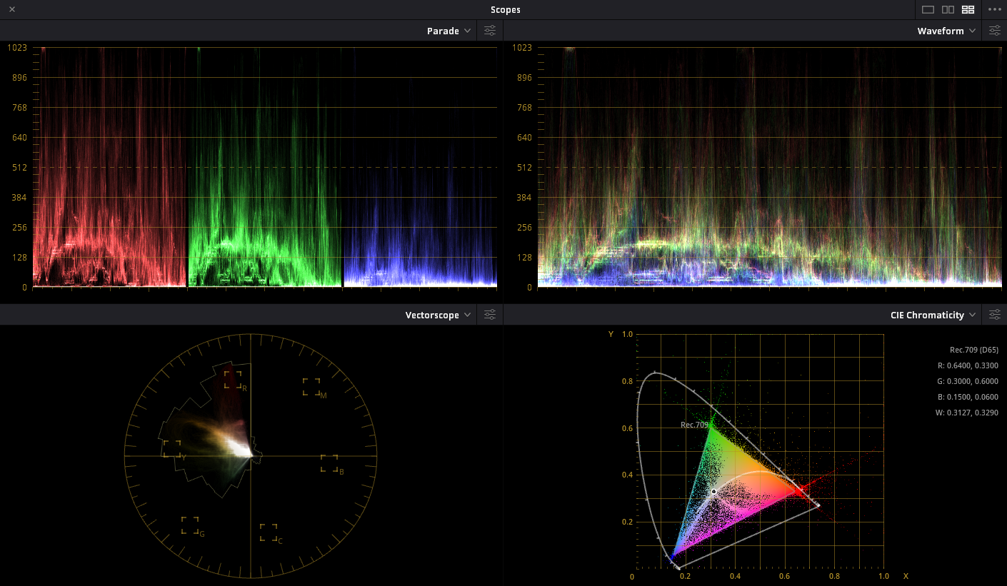

kye Posted October 17, 2020 Author Share Posted October 17, 2020 On 10/16/2020 at 1:14 AM, hyalinejim said: Don't forget about shadow saturation! It often gets ignored in talk about highlight rolloff. The Art Adams articles kye posted above are very interesting but he's only concerned with highlight saturation behaviour. Indeed.  Reminds me of this article: https://www.provideocoalition.com/film-look-two/ Art Adams again.  Long story short, film desaturates both the highlights and the shadows because on negative film the shadows are the highlights!  (pretty sure that's the right-way around..) On 10/16/2020 at 1:19 AM, Stab said: I definitely 'know' what you mean. When I see a good image, it's obvious. But most modern mirrorless can look awful and pretty good, but never have that 'pop' that 'real' video camera's have like BlackMagics, C300's, Alexa's, Varicams, etc. But is this the processing of the image? Or the sensor? Or both? I think it's the processing because almost all modern mirrorless camera's take damn good photo's in raw. And when you edit them in lightroom the color 'thickness' is definitely there. But in video mode that is different. So the fact that the same sensor can look great and 'meh' at the same time, should point to the processing part. But then again, I'm sure an Arri still looks better at 50 mbps than a GH5 with 10 times the bitrate. So where / when is the 'secret sauce' introduced? And are manufacturers themselves aware of this? And is that the reason they will never put their top of the line color science / processing in their 'cheap' mirrorless camera's? I definitely think it's in the processing.  I view it as that there are three factors: 1) things that simply aren't captured by a cheaper camera (eg, clipping) 2) things that are captured and can be used in post without degrading the image below a certain threshold (ie, what image standards you or your client have) 3) things that aren't captured well enough to be used in post (eg, noisy shadows beyond redemption, parts of the DR that break if pushed around too much) Obviously if you expose your skin tones in a range that is either completely lost (eg, clipped) or aren't in an area that can be recovered without exposing too much noise or breaking the image then there's nothing you can do. What I am interested in is the middle part, where a properly exposed image will put the important things in the image, for example skin tones.  Anything in this range should be able to be converted into something that looks great. Let's take skin tones - let's imagine that they're well captured but don't look amazing, but that the adjustment to make them look amazing won't break the image.  In that case, the only thing preventing the ok skin tones from looking great is the skill in knowing what transformations to make to get there. Yes, if the skin tones are from a bad codec and there is very little hue variation (ie, plastic skin tones) then that's not something that can be recovered from, but if the hues are all there but just aren't nice, then that should be able to be made to look great. This is where it's about skill, and why movies with professional colourists involved often look great.  OF course, ARRI has built a lot of that stuff into their colour science too, so in a sense everything shot with an ARRI camera has a first pass from some of the worlds best colour scientists, so is already that much further ahead than other offerings. Of course, many others aren't far behind on colour science, but in the affordable cameras its rare to get the best colour science combined with a good enough sensor and codec. On 10/16/2020 at 6:49 AM, KnightsFan said: I've certainly been enjoying this discussion. I think that image "thickness" is 90% what is in frame and how it's lit. I think @hyalinejimis right talking about shadow saturation, because "thick" images are usually ones that have deep, rich shadows with only a few bright spots that serve to accentuate how deep the shadows are, rather than show highlight detail. Images like the ones above of the gas station, and the faces don't feel thick to me, since they have huge swathes of bright areas, whereas the pictures that @mat33 posted on page 2 have that richness. It's not a matter of reducing exposure, it's that the scene has those beautiful dark tonalities and gradations, along with some nice saturation. That was something I had been thinking too, but thickness is present in brighter lit images too isn't it? Maybe if I rephrase it, higher-key images taken on thin digital cameras still don't match those higher-key images taken on film.  Maybe cheap cameras are better at higher-key images than low-key images, but I'd suggest there's still a difference. 11 hours ago, tupp said: Of course, a lot of home weren't properly exposed and showed scenes with huge contrast range that the emulsion couldn't handle. However, I did find some examples that have decent exposure and aren't too faded. Interesting images, and despite the age and lack of resolution and DR, there is definitely some thickness to them. I wonder if maybe there is a contrast and saturation softness to them, not in the sense of them being low contrast or low saturation, but more that there is a softness to transitions of luma and chroma within the image? In other news... I've been messing with some image processing and made some test images.  Curious to hear if these appear thick or not. They're all a bit darker, so maybe fall into the exposure range that people are thinking tends to be thicker. tupp 1 Link to comment Share on other sites More sharing options...

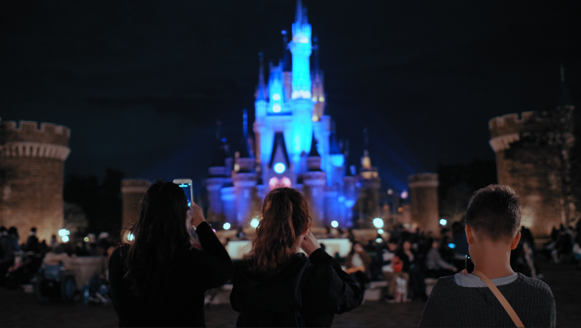

KnightsFan Posted October 17, 2020 Share Posted October 17, 2020 @kyeI don't think those images quite nail it. I gathered a couple pictures that fit thickness in my mind, and in addition to the rich shadows, they all have a real sense of 3D depth due to the lighting and lenses, so I think that is a factor. In the pictures you posted, there are essentially 2 layers, subject and background. Not sure what camera was used, but most digital cameras will struggle in actual low light to make strong colors, or if the camera is designed for low light (e.g., A7s2) then it has weak color filters which makes getting rich saturation essentially impossible. Â Here's a frame from The Grandmaster which I think hits peak thickness. Dark, rich colors, a couple highlights, real depth with several layers and a nice falloff of focus that makes things a little more dreamy rather than out of focus. And the scopes which clearly show the softness of the tones and how mostly everything falls into shadows. Â Â For comparison, here's the scopes from the picture of the man with the orange shirt in the boat which shows definite, harsh transitions everywhere. Â Â 8 hours ago, kye said: That was something I had been thinking too, but thickness is present in brighter lit images too isn't it? Maybe if I rephrase it, higher-key images taken on thin digital cameras still don't match those higher-key images taken on film. Â Maybe cheap cameras are better at higher-key images than low-key images, but I'd suggest there's still a difference. Perhaps, do you have some examples? For example that bright daylight Kodak test posted earlier here Has this scope (mostly shadow though a little brighter than the Grandmaster show, but fairly smooth transitions). And to be honest, I think the extreme color saturation particularly on bright objects makes it look less thick. aaa123jc, tupp and deezid 3 Link to comment Share on other sites More sharing options...
kye Posted October 17, 2020 Author Share Posted October 17, 2020 44 minutes ago, KnightsFan said: @kyeI don't think those images quite nail it. I gathered a couple pictures that fit thickness in my mind, and in addition to the rich shadows, they all have a real sense of 3D depth due to the lighting and lenses, so I think that is a factor. In the pictures you posted, there are essentially 2 layers, subject and background. Not sure what camera was used, but most digital cameras will struggle in actual low light to make strong colors, or if the camera is designed for low light (e.g., A7s2) then it has weak color filters which makes getting rich saturation essentially impossible. My images were all GH5, with the second one using the SLR Magic 8mm f4, and the others using the Voigtlander 17.5mm f0.95.  I don't think that anyone would suggest the GH5 was designed for low light, and the boat image is actually significantly brighter than it was in real life.  The floodlights in the background were the only lighting and we were perhaps 75-100m offshore, so the actual light levels were very low.  I was gobsmacked at how good the images turned out considering the situation, but they're definitely not the controlled lighting situation that they're being compared to. The scopes are very interesting and the idea that the good ones transition smoothly is fascinating, and is very different to the GH5 images. 44 minutes ago, KnightsFan said: Here's a frame from The Grandmaster which I think hits peak thickness. Dark, rich colors, a couple highlights, real depth with several layers and a nice falloff of focus that makes things a little more dreamy rather than out of focus. And the scopes which clearly show the softness of the tones and how mostly everything falls into shadows.  That is a spectacular image, and looks pretty thick to me! It clearly has some diffusion applied (I'd say heavily) and I wonder how much that plays into the thickness of the image.  Diffusion is very common in controlled shooting. Just for some experimentation sake, I wonder if adding Glow helps us thicken things up a bit? Original image posted above: With a heap of Glow applied (to accentuate the effect): Thicker?  It makes is look like there was fog on the water 🙂 I can't match the brightness of the comparison image though, as in most well-lit and low-key narrative scenes the skin tones are amongst the brightest objects in frame, whereas that's not how my scene was lit. 44 minutes ago, KnightsFan said: Perhaps, do you have some examples? For example that bright daylight Kodak test posted earlier here Has this scope (mostly shadow though a little brighter than the Grandmaster show, but fairly smooth transitions). And to be honest, I think the extreme color saturation particularly on bright objects makes it look less thick. No examples offhand, just more anecdotal impressions I guess. I must agree that the bright punchy colours in that image don't look the best.  The colours in these two also don't look the best to me either. I've been watching a lot of TV lately and the skin tones that I'm really liking seem to have a very strong look, but I'm yet to find what that maps out to in concrete terms.  I suspect that the hues are very well controlled between the yellow and pink ends of the spectrum without either going too far, and the saturation also seems to be very well controlled with lots of skin area being quite saturated but the saturation being limited, in that it goes quickly up to a certain point but doesn't go much beyond that. The skintones I'm used to dealing with in my own footage are all over the place in terms of often having areas too far towards yellow and also too pink, and with far too much saturation, but if you pull the saturation back on all the skin then when the most saturated areas come under control the rest of the tones are completely washed out. I am focusing a lot on skin tones, but that's one half of the very common teal/orange look, so the scene will be skin tones, maybe some warmer colours, and then the rest will be mostly cool in temp. I've been taking screen grabs whenever I see a nice shot and plan on pulling a bunch of them into Resolve and studying the scopes to see if I can see what is going on, and if I can learn from that. Link to comment Share on other sites More sharing options...

KnightsFan Posted October 17, 2020 Share Posted October 17, 2020 31 minutes ago, kye said: Thicker?  It makes is look like there was fog on the water 🙂 I can't match the brightness of the comparison image though, as in most well-lit and low-key narrative scenes the skin tones are amongst the brightest objects in frame, whereas that's not how my scene was lit. Yes, I think the glow helps a lot to soften those highlights and make them dreamier rather than sharp and pointy and make it more 3D in this instance where the highlights are in the extreme background (like you said, almost like mist between subject and background). I agree, the relation between the subject and the other colors is critical and you can't really change that with different sensors or color correction. That's why I say it's mainly about what's in the scene. Furthermore, if your objects in frame don't have subtle variation you can't really add that in. The soft diffuse light comign from the side in the Grandmaster really allows every texture to have a smooth gradation from light to dark, whereas your subject in the boat is much more evenly lit from left to right. 36 minutes ago, kye said: The skintones I'm used to dealing with in my own footage are all over the place in terms of often having areas too far towards yellow and also too pink, and with far too much saturation, but if you pull the saturation back on all the skin then when the most saturated areas come under control the rest of the tones are completely washed out. I assume you're also not employing a makeup team? That's really the difference between good and bad skin tones, particularly in getting different people to look good in the same shot. tupp 1 Link to comment Share on other sites More sharing options...

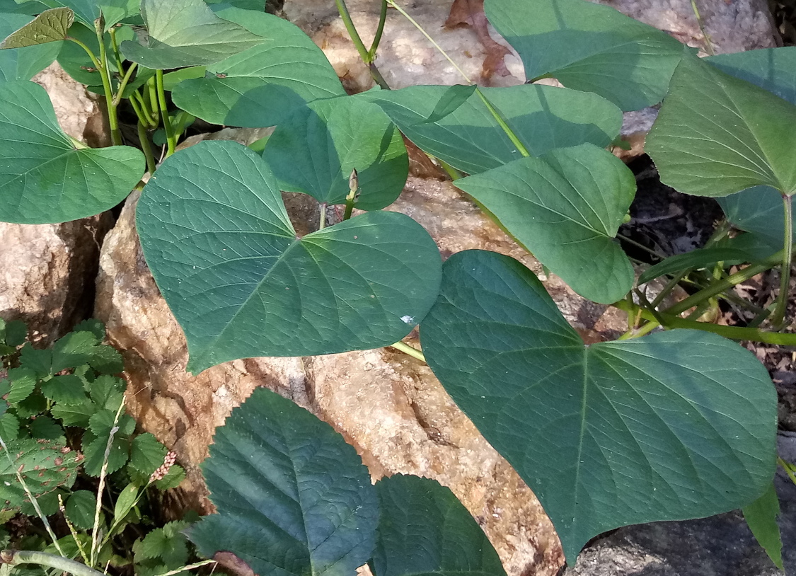

KnightsFan Posted October 24, 2020 Share Posted October 24, 2020 Quick demo of the effect of water on image thickness. Just two pics from my (low end) phone cropped and scaled for manageable size. These may be the worst pictures in existence, but I think that simply adding water, thereby increasing specularity, contrast, and color saturation makes a drastic increase in thickness. Same settings, taken about 5 seconds apart. Â tupp 1 Link to comment Share on other sites More sharing options...
