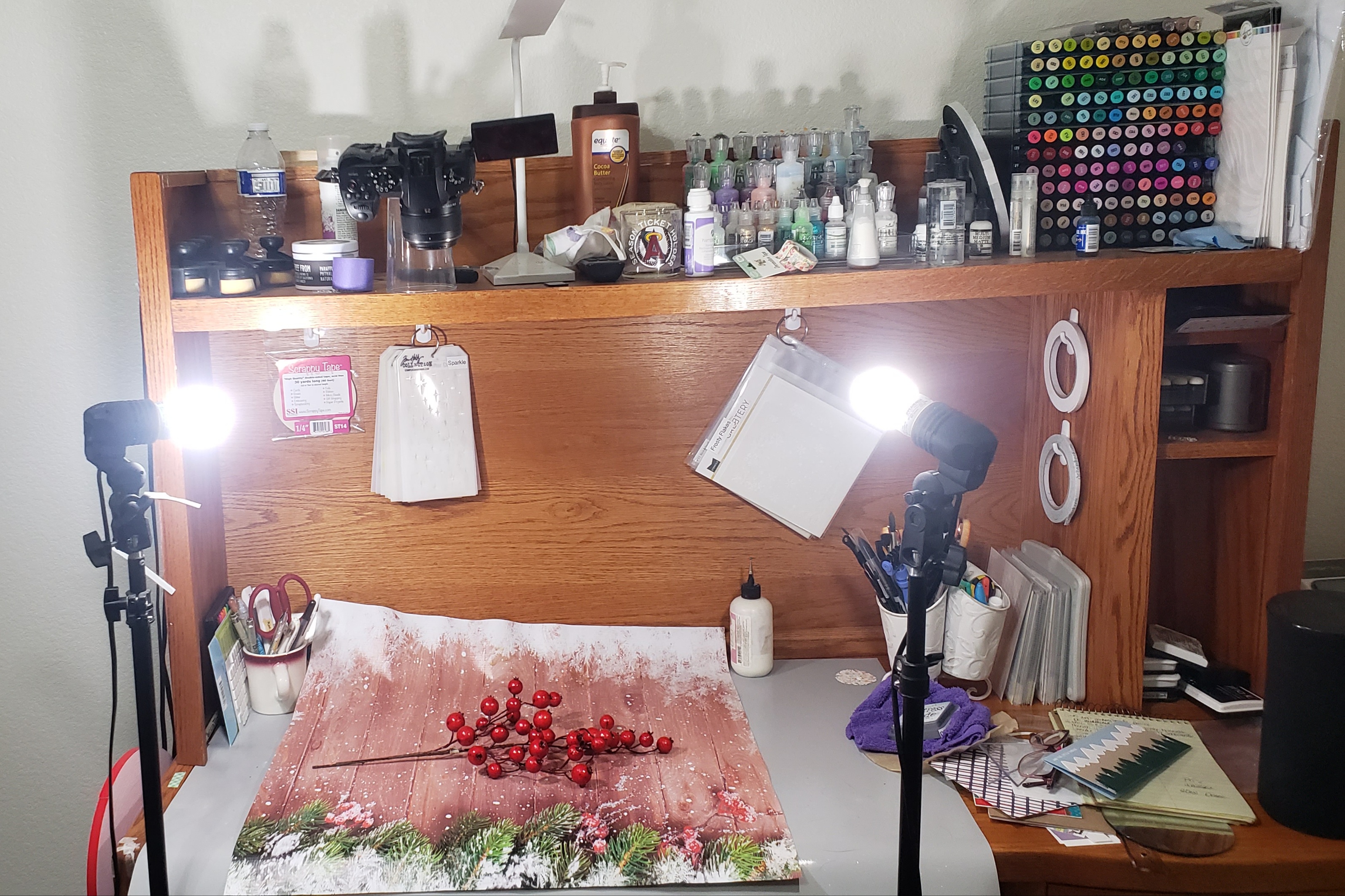

Marla Posted November 6, 2020 Author Share Posted November 6, 2020 Thank you for the camera suggestions and for the setting tips. Herin2020 I am going to start with your suggestions and see if I can get better results. Right now it really blurs if the object a piece of white paper to be exact is set down first. Crossing finger I can get the static focus. For perspective, I added a photo of how the camera is set up. I guess what is disappointing is my phone did a better job than this expensive camera. It simply doesn't have the storage capacity. Link to comment Share on other sites More sharing options...
herein2020 Posted November 6, 2020 Share Posted November 6, 2020 On 11/6/2020 at 12:03 PM, Marla said: Thank you for the camera suggestions and for the setting tips. Herin2020 I am going to start with your suggestions and see if I can get better results. Right now it really blurs if the object a piece of white paper to be exact is set down first. Crossing finger I can get the static focus. For perspective, I added a photo of how the camera is set up. I guess what is disappointing is my phone did a better job than this expensive camera. It simply doesn't have the storage capacity. Expand Any camera will go blurry if you put a plain white piece of paper in front of it, cameras need some kind of contrast to achieve focus. Cell phones aren't as obvious because they have really wide angle lenses but they would go blurry as well. For your setup my tips will work perfectly. Before putting that paper down, make sure there is something with texture and contrast like the desk or an object for the camera to focus on. Press the shutter button half way until it achieves focus, then flip the lens switch to manual focus. You will now be able to film everything and it will all stay in focus as long as you follow my other tips. Trust me, the GH5 is way overkill for this project, you just need to learn more about how to get the most out of it and how to set it up for this type of project. It will never be a point and shoot type of camera like a cell phone. The nice thing is, after you have it all setup, if you never move the GH5, all you will need to do is press record for future videos. Marla 1 Link to comment Share on other sites More sharing options...
