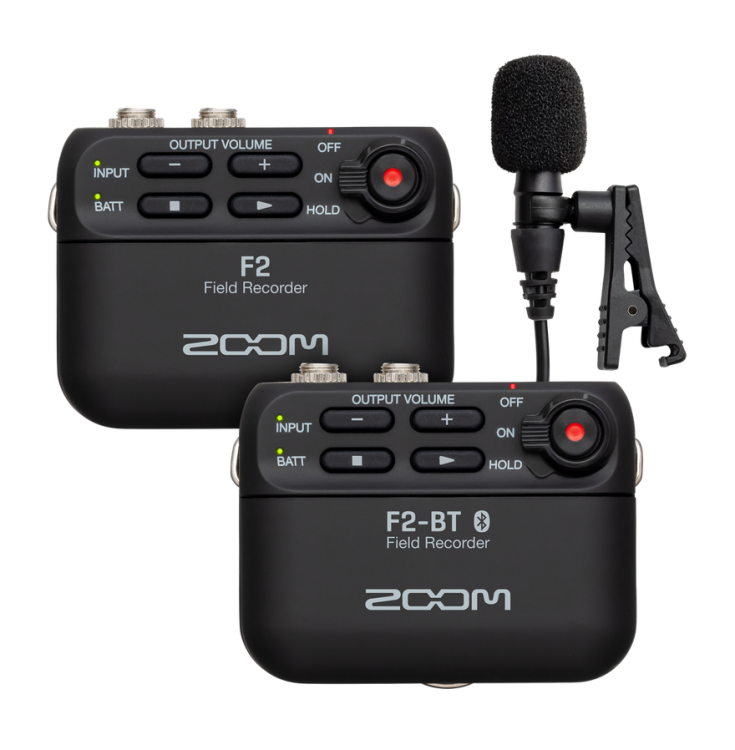

sanveer Posted November 10, 2020 Share Posted November 10, 2020 F2 FIELD RECORDER & LAVALIER MIC 32-BIT FLOAT TECHNOLOGY IN OUR SMALLEST, LIGHTEST RECORDER EVER BUILT FOR BIG THINGS For podcasters, videographers, bloggers, journalists and more, the F2 is the perfect audio solution for creators on the move. *F2 is available with or without Bluetooth AUDIO ON AUTOPILOT The F2 features 32-bit float recording technology, allowing you to record the loudest audio signals without worrying about clipping. It will also record the quietest signals in beautiful detail. And the best part is you don’t have to worry about setting the gain. Just plug in the lav and hit record. PLEASE HOLD Once you start your recording, use the F2’s HOLD switch to ensure you don’t accidentally stop recording. LOCK ‘N LAV Screw-lock connectors keep your lav plugged-in securely no matter the situation. ALSO AVAILABLE WITH BLUETOOTH CONTROL The F2-BT comes with built-in Bluetooth. And with the free Zoom F2 Control app the F2-BT can wirelessly start/stop recordings, display battery levels, adjust output volume, control lo-cut and more. You can also pair the F2-BT with a Bluetooth timecode synchronization device to receive and write timecode to recorded files. See Bluetooth Control features here. THE F2 EDITOR The F2 Editor for PC and Mac allows you to adjust settings, format SD cards and more. Simply connect your F2 or F2-BT via a USB cable and launch the editor. The USB connection also makes it easy to transfer files to your computer. See the F2 Editor features here. Narration and Voice Over Whether a stroll through your garden, or the whispers and shouts of a dramatic reading, the F2 provides crystal clear recordings. POWER The F2 can record up to 15 hours (14 hours on the F2-BT) with two AAA batteries. STORAGE Record on microSD, microSDHC, and microSDXC cards up to 512GB. LAVALIER INCLUDED The LMF-2 omnidirectional lavalier microphone has a low-profiled design, captures high-quality audio, and includes a windscreen and lapel mic clip. RECORDING FORMATS The F2 Field Recorder gives you the option to choose the recording format that works best for your projects. Choose from 44.1 kHz/32-bit float or 48 kHz/32-bit float mono WAV files. UncleBobsPhotography and John Matthews 2 Link to comment Share on other sites More sharing options...

KnightsFan Posted November 10, 2020 Share Posted November 10, 2020 This is cool. I was rooting for an F2 with 32 bit float on 2 XLR inputs and their new Zoom modules, more of a little brother to the F6. But this is a nice, cheap alternative to the Track E. I wonder if you can pair multiple F2's with the app and record them at the same time, maybe even in conjunction with the F6 which also connects to an app? Otherwise I can't see this being a useful replacement for lav mics, if each one needs to have the record button hit on each device individually. More useful for vloggers than filmmakers it seems. Link to comment Share on other sites More sharing options...
Thomas Hill Posted November 10, 2020 Share Posted November 10, 2020 1 hour ago, KnightsFan said: if each one needs to have the record button hit on each device individually. The Bluetooth version can start and stop wirelessly from the app. Link to comment Share on other sites More sharing options...
KnightsFan Posted November 10, 2020 Share Posted November 10, 2020 48 minutes ago, Thomas Hill said: The Bluetooth version can start and stop wirelessly from the app. Right, but what I was wondering is if the app can start/stop multiple F2's at the same time, or even a couple F2's and an F6 simultaneously? Because if not then it's fairly useless for a multi person setup. Link to comment Share on other sites More sharing options...

sanveer Posted November 11, 2020 Author Share Posted November 11, 2020 1 hour ago, Marcio Kabke Pinheiro said: Waiting for our sound specialist @IronFilm to give his remarks. 🙂 But really, no audio level monitoring needed? "Clipped audio could be recovered", is it real? (my interest is for record concert audio, high SPLs) I agree. @IronFilm will give us some insights we may have missed. I do with it had a fint little LCD. It makes me worried about battery life or some other things one needs to check. Probably which track is being played back or something else. Juank and Katrikura 2 Link to comment Share on other sites More sharing options...

newfoundmass Posted November 15, 2020 Share Posted November 15, 2020 I was actually blown away at how small this is when seeing a picture of it in someone's hand. This is gonna sell like crazy to wedding videographers, I think. Link to comment Share on other sites More sharing options...
