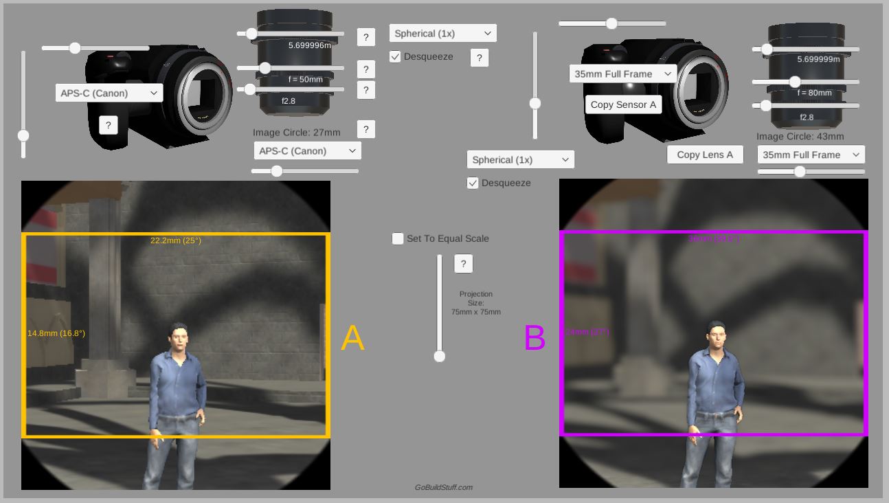

KnightsFan Posted November 20, 2020 Share Posted November 20, 2020 @herein2020Not to self promote too much, but I made a comparison tool a long time ago that you might find useful https://gobuildstuff.com/tools/CropFactor/index.html There's no way to change the distance from camera to subject in this tool at the moment, maybe I should add that. Link to comment Share on other sites More sharing options...

herein2020 Posted November 20, 2020 Author Share Posted November 20, 2020 25 minutes ago, KnightsFan said: @herein2020Not to self promote too much, but I made a comparison tool a long time ago that you might find useful https://gobuildstuff.com/tools/CropFactor/index.html There's no way to change the distance from camera to subject in this tool at the moment, maybe I should add that. That is a really cool tool. oh and my math was a bit off, 50mm with a 1.6x crop is 80mm. The tool confused me again though, it shows the background is more out of focus, whereas I think with the S5 the background bokeh stays the same with the crop. @MrSMW - are you sure, I thought the image circle in the crop sensor lenses for EF-S lenses needed 1.6x crop to not see the lens barrel. I need to test with and without the adapter. So much to test...but I guess none of it really matters when you are out shooting. Link to comment Share on other sites More sharing options...

KnightsFan Posted November 20, 2020 Share Posted November 20, 2020 1 hour ago, herein2020 said: That is a really cool tool. oh and my math was a bit off, 50mm with a 1.6x crop is 80mm. The tool confused me again though, it shows the background is more out of focus, whereas I think with the S5 the background bokeh stays the same with the crop. Thanks! Based on your screenshots numbers, an 80mm lens at f2.8 will produce shallower depth of field compared to a 50mm lens at f2.8. That's why in your screenshots the image on the left has more depth of field than on the right. That's also why (depending on what equivalence you are looking for), you also need to factor an aperture change into your crop factor equivalence calculations. Another aspect I tried to convey with the tool is that you should specify which dimension you are calculating crop based on. Typically people use the diagonal, but obviously with different aspect ratios that doesn't give the whole picture. A 16:9 video section of a 3:2 full frame photo sensor technically has a diagonal crop factor larger than 1. Just keep that in the back of your mind when comparing numbers as close as 1.5 vs. 1.6. Link to comment Share on other sites More sharing options...
