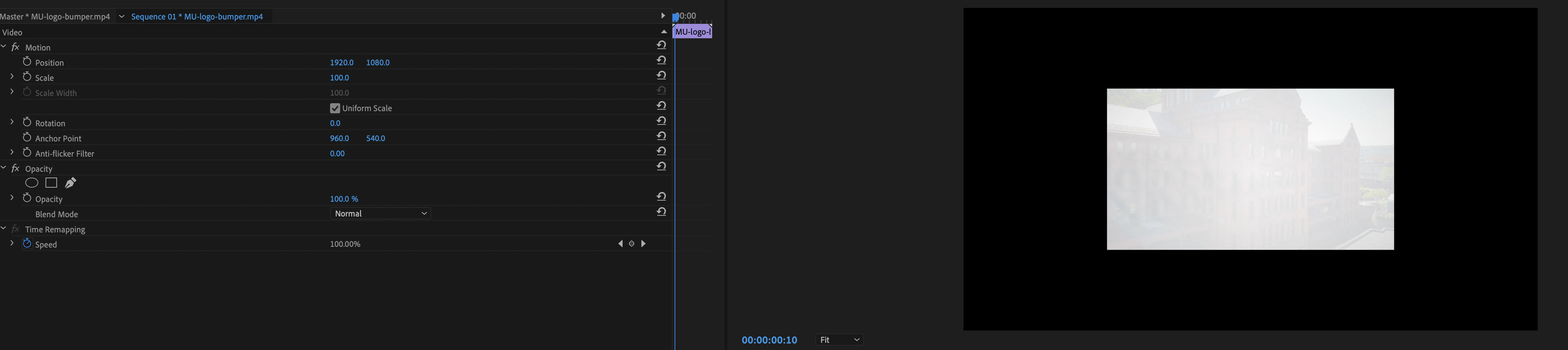

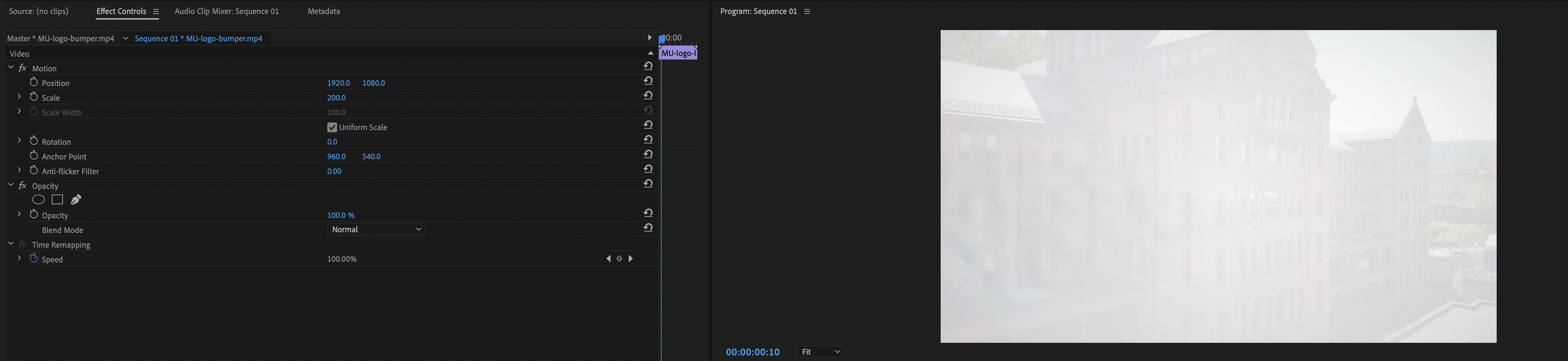

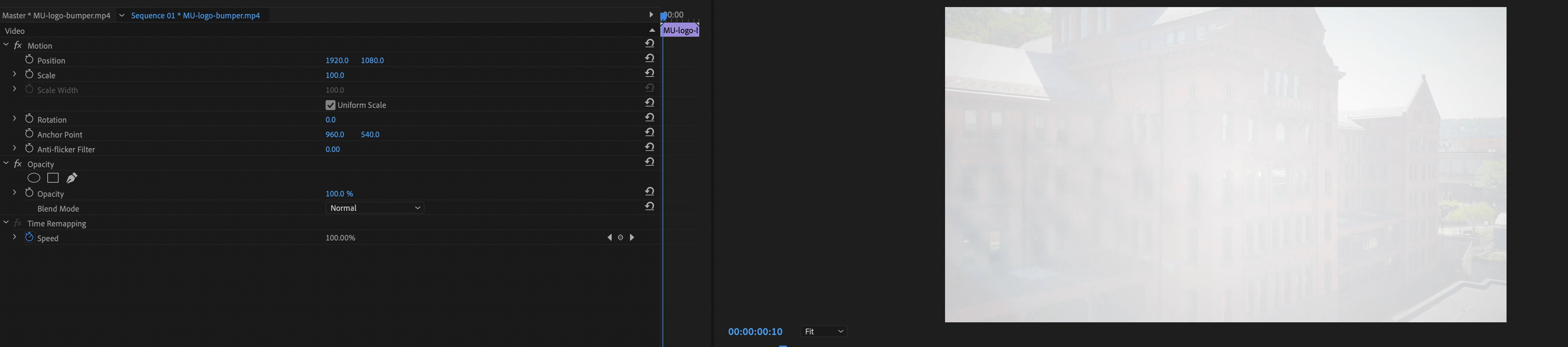

MurtlandPhoto Posted December 8, 2020 Share Posted December 8, 2020 On 12/7/2020 at 4:40 AM, Anaconda_ said: Is there a difference between Set To Frame Size and Scale To Frame Size? I've always used Scale In Premiere, scale to frame size does some calculations to best scale the footage to the timeline resolution, but it is not optimized for doing any sort of keyframe scaling afterwards. Set to frame size is much better for that. It's a confusing thing to explain, but basically if you're going to want to do anything beyond just filling the frame then it's better to use set. Original HD footage on UHD timeline. Notice the scale is at 100. Scale to frame size. Now notice the scale is still at 100. Set to frame size. Now notice the scale is at 200. Scale vs. set use different methods to interpolate the frame to the desired size. Scale uses a method that sort of locks the picture in and results in poorer quality should you deviate from the initial setting. Set uses a different method that better allows for flexibility of resizing later like for digital zooms and reframing. newfoundmass 1 Link to comment Share on other sites More sharing options...
