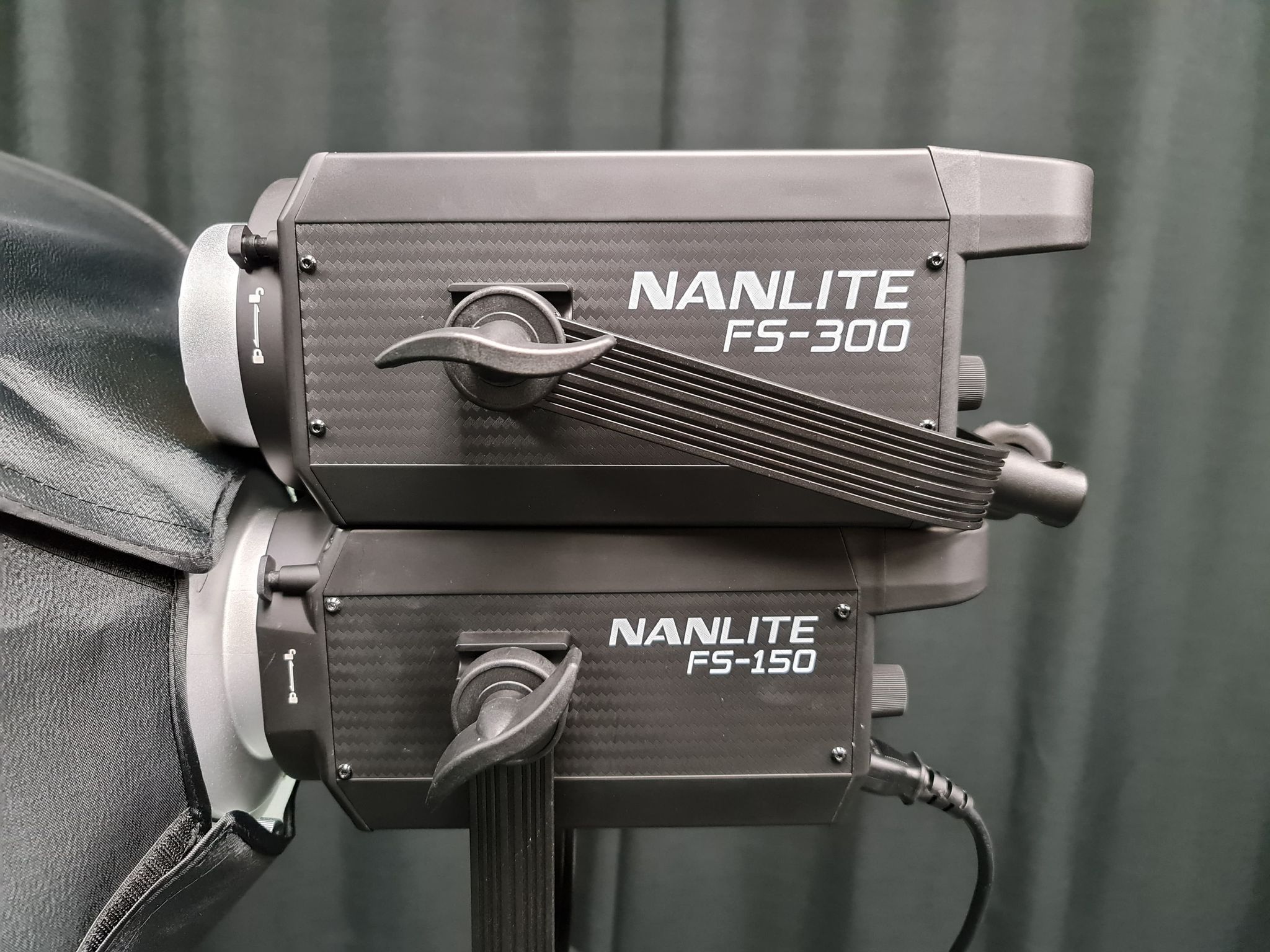

ntblowz Posted May 11, 2021 Share Posted May 11, 2021 Light arrived 1st impression, size wise it is a bit bigger/heavier than FS150, the fan noise is definitely more louder than FS150, but when the light is at my camera side the pickup from mic is ok.. (1.5m away). Definitely love the power increase though! Link to comment Share on other sites More sharing options...
