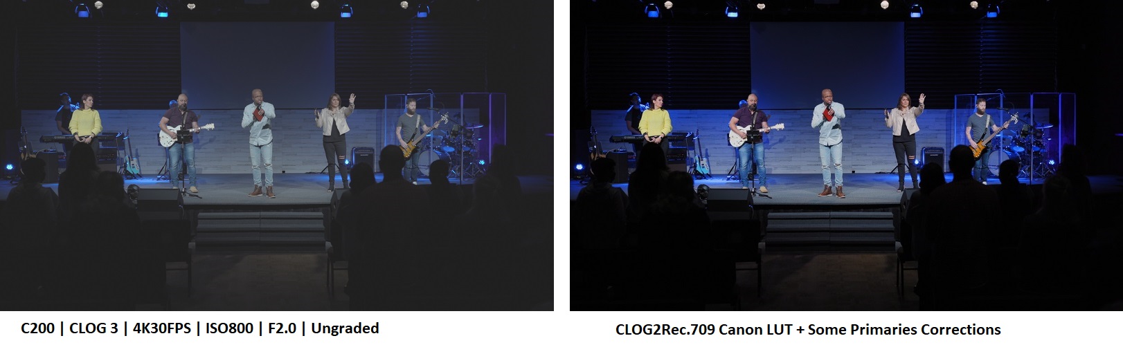

I have the C200 with the Sigma 18-35mm F1.8 lens, here is a sample shot in low light at ISO800 4K30FPS 4:2:0 8bit LongGOP. I haven't had any problems with noise or saturation out of the C200. Remember all LUTs are just meant to get you close, you still need to use your color grading NLE and tools of choice to finish developing the image. For the attached sample image, I did not add any saturation. Also, I tend to slightly ETTR until the highs show a little hot in the  WFM then pull down the Lift in post to lower the black point.  It is a balancing act though, I only ETTR if I can get away with it using nothing but the aperture; if I have to increase the ISO to ETTR then I just go for proper exposure.
The processed image below is without any noise reduction added. If you feel like you cannot add back enough saturation are you sure your monitor is calibrated? Also, a lot of YouTube videos heavily oversaturate their footage because they think it looks better, but if you watch Hollywood movies they don't have as much saturation as your typical YouTube video. It could also be your lens; the 24-105mm is considered a very clinical lens....great all arounder but not something you want to use for 'cinematic' footage.
