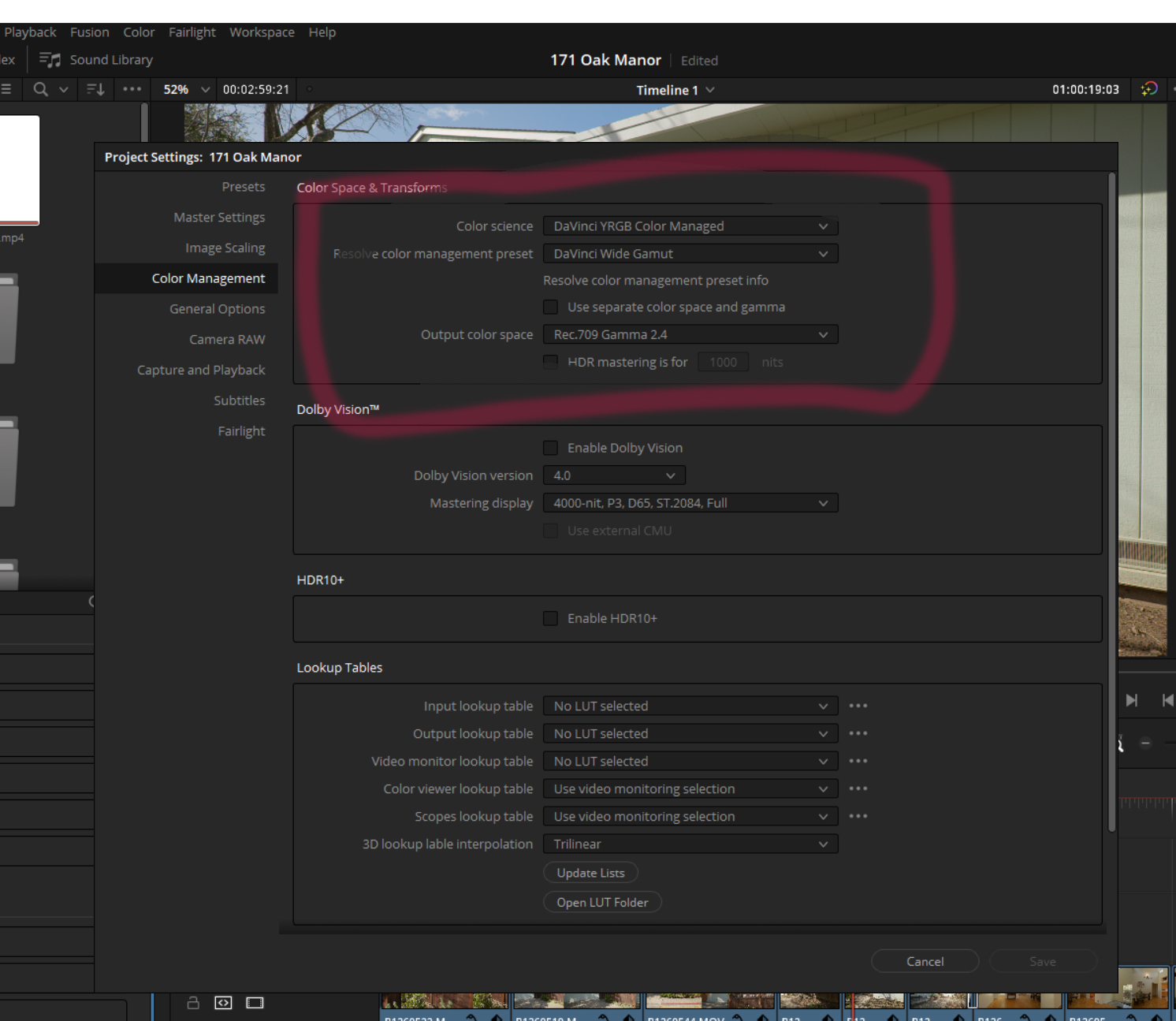

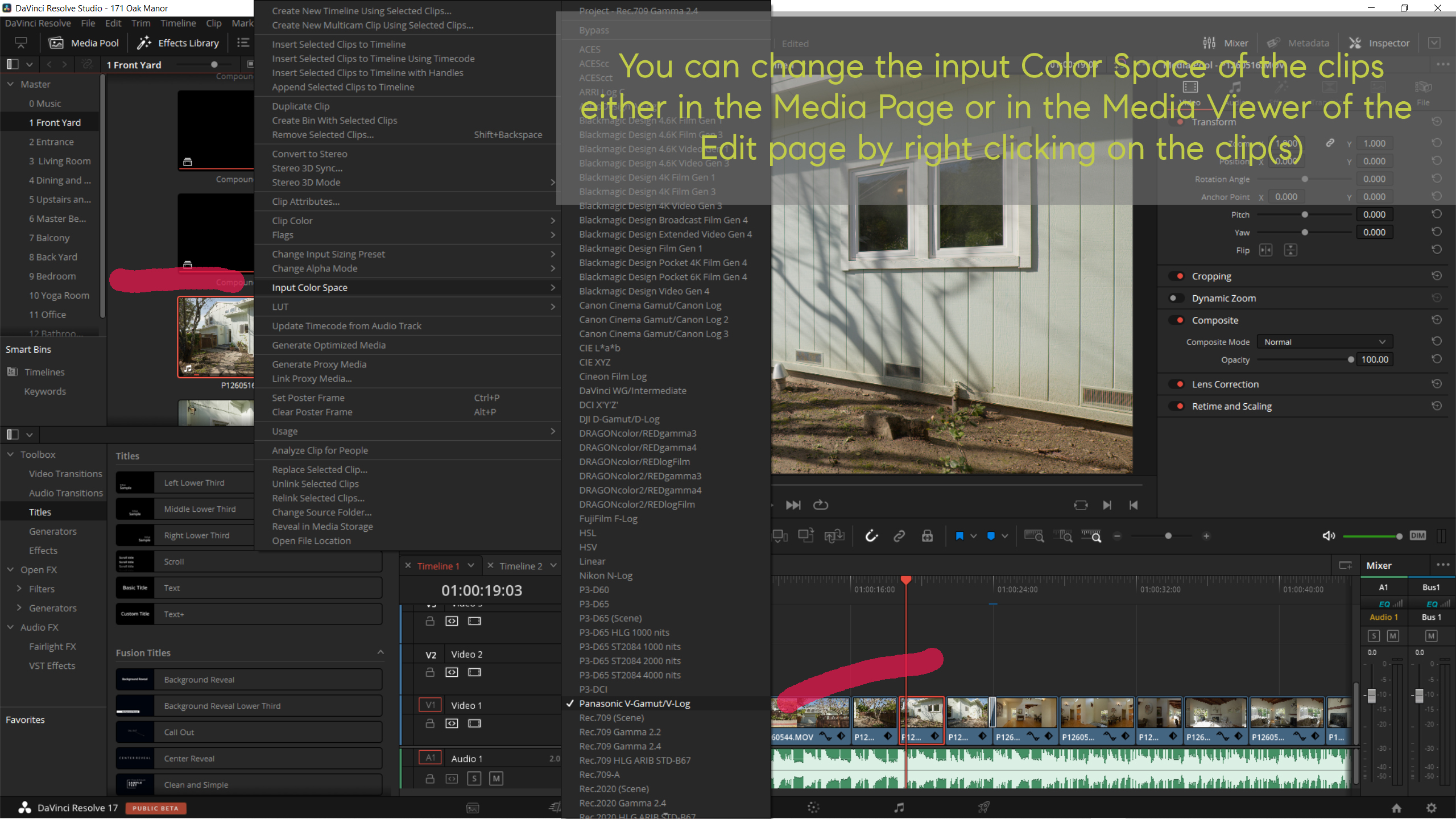

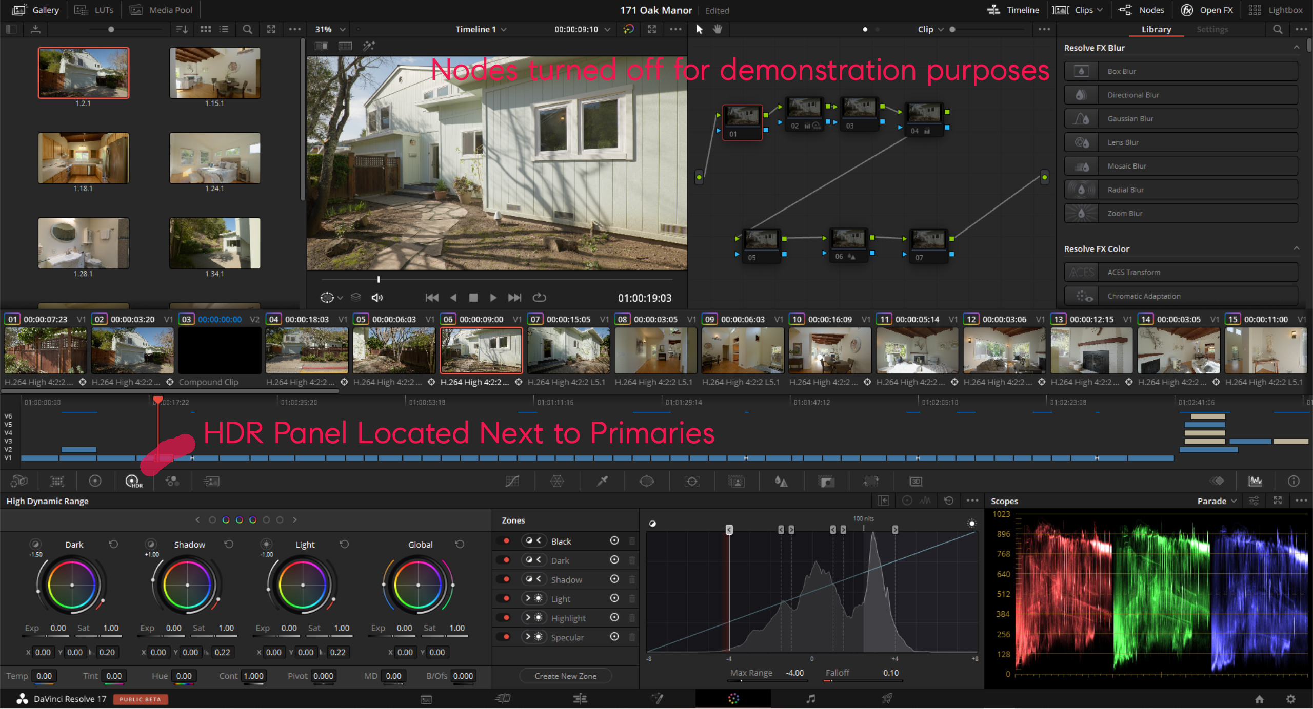

Mark Romero 2 Posted February 4, 2021 Share Posted February 4, 2021 OK, first go in to preferences and change the color management / color settings. Set output color space to Rec.709 2.4 and disable any input LUTs / transforms. Then in either the media pool or the medial viewer of the edit page, change the Input Color Space to Panasonic V-LOG / V Gamut You should end up with a really good starting point even before grading. I disabled the nodes in my grade to show you the starting point. NOTE: For whatever reason, photoshop saturates my screen captures from the color page of resolve a lot, so the image is not as saturated as it looks in this screen shot. Note the HDR panel location next to the primary wheels / bars / log tab. If you see the levels in the center viewer, click the HDR icon a second time and it will display the HDR levels tool instead. HDR tool works EVEN IF YOU WILL BE DELIVERING IN SD INSTEAD OF HDR. big benefit is that adding contrast does not add saturation the way that it normally does when using primary wheels / bars / log tools. Hope this helps. zerocool22 1 Link to comment Share on other sites More sharing options...
