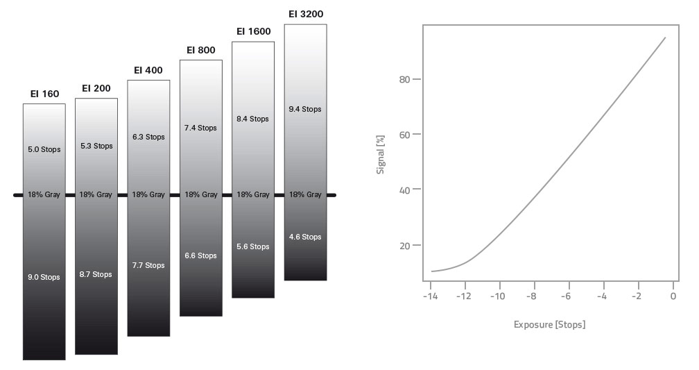

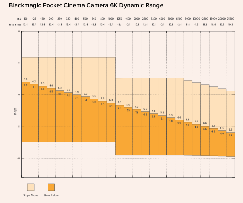

Llaasseerr Posted February 17, 2021 Share Posted February 17, 2021 13 minutes ago, TomTheDP said: Thank you for the explanation. That was my previous understanding though less technically minded. What led to my confusion is dynamic range measurements. The Pocket 6k has considerably more shadow and highlight information than the URSA 4.6k even though the URSA is measured having more dynamic range by CineD and BM themselves. I know because I've tested both cameras and the difference not even debatable. The P6K killed the URSA. I've found the highlight recovery tool in Resolve to be very useful unless you are recovering skintones or really critical stuff. In regards to the FX3 I am definitely interested if they get rid of the nasty internal processing. Unless I'm misunderstanding you, I'm not sure how to quantify that it has more shadow and highlight information, but less dynamic range because basically it's the same thing. If you have some comparison frames in BRaw or log, I'd be interested to take a look. I guess it's important to state that there's DR above and below middle grey, and ask what's the camera's emphasis. For example practically every affordable camera is more about stops below middle grey, whereas the Alexa is more about stops above middle grey. But also the noise it produces in the shadows has a nice filmic look, up to a point. Again, the FX3 raw output should be unmolested but that most likely involves attaching the Ninja V. Yeah, maybe they're adding the FX6 ability to disable NR for internal recording. Link to comment Share on other sites More sharing options...
TomTheDP Posted February 17, 2021 Share Posted February 17, 2021 26 minutes ago, Llaasseerr said: Unless I'm misunderstanding you, I'm not sure how to quantify that it has more shadow and highlight information, but less dynamic range because basically it's the same thing. If you have some comparison frames in BRaw or log, I'd be interested to take a look. I guess it's important to state that there's DR above and below middle grey, and ask what's the camera's emphasis. For example practically every affordable camera is more about stops below middle grey, whereas the Alexa is more about stops above middle grey. But also the noise it produces in the shadows has a nice filmic look, up to a point. Again, the FX3 raw output should be unmolested but that most likely involves attaching the Ninja V. Yeah, maybe they're adding the FX6 ability to disable NR for internal recording. Yes that is why I began to think dynamic range and latitude were entirely different things. Because the testings by CineD didn't seem to translate to reality. The 11.8 stops of dynamic range doesn't add up from what I've seen from the Pocket. Yes the Arri has better dynamic range but the A7S3 or C300 MK3 or even C500, I am not so sure. I could upload the tests though I am lazy lol. The URSA just falls apart in the shadows due to fixed noise pattern which renders footage unusable even with neat video. It also clips highlights faster. Prores RAW is great though for most work I'd end up just using internal recording which is why its important for me to have that unprocessed image internally. I mean if RAW is not needed an image with NR and sharpening is probably fine but I am a stickler for that kind of thing for no good reason. Link to comment Share on other sites More sharing options...

HockeyFan12 Posted February 17, 2021 Share Posted February 17, 2021 46 minutes ago, Llaasseerr said: Unless I'm misunderstanding you, I'm not sure how to quantify that it has more shadow and highlight information, but less dynamic range because basically it's the same thing. If you have some comparison frames in BRaw or log, I'd be interested to take a look. I guess it's important to state that there's DR above and below middle grey, and ask what's the camera's emphasis. For example practically every affordable camera is more about stops below middle grey, whereas the Alexa is more about stops above middle grey. But also the noise it produces in the shadows has a nice filmic look, up to a point. Again, the FX3 raw output should be unmolested but that most likely involves attaching the Ninja V. Yeah, maybe they're adding the FX6 ability to disable NR for internal recording. It doesn't much matter, but at 800 ISO the Alexa and P6k have similar over/under. I think Black Magic recommends rating the camera at 400 ISO, in which case, without highlight recovery enabled, you would get 1.5-2 stops less highlight detail (as you mention), but it's clean enough at 800 ISO and with highlight detail recovery enabled actually surpasses the Alexa in real world use. Black Magic's highlight detail recovery works remarkably well. I've never seen a weird result from it, which is remarkable. But you're right not to rely on it too much, and I also find Cined's Komodo results suspicious because color is missing entirely on the top three highlight stops. There are plenty of other factors beyond highlight dynamic range, but prosumer cameras are approaching (and in this one very specific case surpassing) the current generation Alexa. The P6k is really good! Link to comment Share on other sites More sharing options...

Llaasseerr Posted February 17, 2021 Share Posted February 17, 2021 33 minutes ago, TomTheDP said: Yes that is why I began to think dynamic range and latitude were entirely different things. Because the testings by CineD didn't seem to translate to reality. The 11.8 stops of dynamic range doesn't add up from what I've seen from the Pocket. Yes the Arri has better dynamic range but the A7S3 or C300 MK3 or even C500, I am not so sure. I could upload the tests though I am lazy lol. The URSA just falls apart in the shadows due to fixed noise pattern which renders footage unusable even with neat video. It also clips highlights faster. Prores RAW is great though for most work I'd end up just using internal recording which is why its important for me to have that unprocessed image internally. I mean if RAW is not needed an image with NR and sharpening is probably fine but I am a stickler for that kind of thing for no good reason. Yeah, we should not need raw to record a clean signal without NR, etc - agreed. Personally I liked the fact you can record 444 12 bit log ProRes with the early Alexas but it never trickled down to the mirrorless cams. Needing raw and the external device is a pain, but I'll take it haha. It depends on project requirements. It's just abut manageable at this point. I can afford the extra time to squeeze out more quality. I hope RED's stupid patent dies though. I hear you on the Ursa. I've never been that convinced. They always seemed to just be fixing sensor issues. with each update. I'l admit I haven't paid that much attention to the Pocket 6K because of rolling shutter and the form factor. The a7sIII/FX6/FX3sensor is probably where it's at for me right now. Link to comment Share on other sites More sharing options...
Llaasseerr Posted February 17, 2021 Share Posted February 17, 2021 30 minutes ago, HockeyFan12 said: It doesn't much matter, but at 800 ISO the Alexa and P6k have similar over/under. I think Black Magic recommends rating the camera at 400 ISO, in which case, without highlight recovery enabled, you would get 1.5-2 stops less highlight detail (as you mention), but it's clean enough at 800 ISO and with highlight detail recovery enabled actually surpasses the Alexa in real world use. Black Magic's highlight detail recovery works remarkably well. I've never seen a weird result from it, which is remarkable. But you're right not to rely on it too much, and I also find Cined's Komodo results suspicious because color is missing entirely on the top three highlight stops. There are plenty of other factors beyond highlight dynamic range, but prosumer cameras are approaching (and in this one very specific case surpassing) the current generation Alexa. The P6k is really good! Thanks, I should download some footage from this cam and take a look. And I definitely like the highlight recovery tool, I've used it on DNG frames back in the day. What you seem to be suggesting is pushing the DR by +1 stop to protect highlights, ie. push native 400 to 800, which I definitely do with an ND quite often. Noisier, but manageable shadows ("texture"). But then if you were fair and did that with an Alexa, which is totally doable, it would be back to the same margin of difference between the cameras. Overall, as I stated I'm most hopeful about the current Sony sensor. Where it beats the P6K is rolling shutter performance, by a fair amount. But it's still about 4x slower than the Alexa. Link to comment Share on other sites More sharing options...

HockeyFan12 Posted February 17, 2021 Share Posted February 17, 2021 1 hour ago, Llaasseerr said: Thanks, I should download some footage from this cam and take a look. And I definitely like the highlight recovery tool, I've used it on DNG frames back in the day. What you seem to be suggesting is pushing the DR by +1 stop to protect highlights, ie. push native 400 to 800, which I definitely do with an ND quite often. Noisier, but manageable shadows ("texture"). But then if you were fair and did that with an Alexa, which is totally doable, it would be back to the same margin of difference between the cameras. Overall, as I stated I'm most hopeful about the current Sony sensor. Where it beats the P6K is rolling shutter performance, by a fair amount. But it's still about 4x slower than the Alexa. At 800 ISO, the Alexa only has 0.1 stops more shadow detail than P6K, so underexposing the Alexa an additional stop isn't really a fair comparison. I don't own a P6K, and agree the A7SIII sensor looks much more interesting (not even sure rolling shutter is much worse than Alexa LF Mini), but it's a really impressive camera. Link to comment Share on other sites More sharing options...

androidlad Posted February 17, 2021 Share Posted February 17, 2021 3 hours ago, Llaasseerr said: Thanks, I should download some footage from this cam and take a look. And I definitely like the highlight recovery tool, I've used it on DNG frames back in the day. What you seem to be suggesting is pushing the DR by +1 stop to protect highlights, ie. push native 400 to 800, which I definitely do with an ND quite often. Noisier, but manageable shadows ("texture"). But then if you were fair and did that with an Alexa, which is totally doable, it would be back to the same margin of difference between the cameras. Overall, as I stated I'm most hopeful about the current Sony sensor. Where it beats the P6K is rolling shutter performance, by a fair amount. But it's still about 4x slower than the Alexa. Alexa's rolling shutter performance isn't that impressive. Alexa XT: 8ms in 16:9/4:3 2880 sensor mode, 13ms in open gate sensor mode. Alexa LF: 14ms open gate mode. Alexa 65: 15.6ms open gate mode. Llaasseerr 1 Link to comment Share on other sites More sharing options...

Llaasseerr Posted February 18, 2021 Share Posted February 18, 2021 5 hours ago, HockeyFan12 said: At 800 ISO, the Alexa only has 0.1 stops more shadow detail than P6K, so underexposing the Alexa an additional stop isn't really a fair comparison. I don't own a P6K, and agree the A7SIII sensor looks much more interesting (not even sure rolling shutter is much worse than Alexa LF Mini), but it's a really impressive camera. I'm really talking about underexposing in order to push the highlight detail, that's my agenda though haha. You'll get a stop more highlight detail by pushing a stop. Two stops more by pushing two stops. Shadows will obviously suffer a bit. I haven't checked if the LF rolling shutter is worse than the original sensor size. But even with the a7sIII sensor being 4x slower, it's still fast enough - sub 10ms for a full frame sensor is quiite nice. I know a lot of people aren't that concerned by rolling shutter, but I think it's really important. I look forward to when we are all using global shutter with no DR penalty. EDIT: I didn't see the published RS speeds, thanks @androidlad Link to comment Share on other sites More sharing options...
Llaasseerr Posted February 18, 2021 Share Posted February 18, 2021 Just now, Llaasseerr said: I'm really talking about underexposing in order to push the highlight detail, that's my agenda though haha. You'll get a stop more highlight detail by pushing a stop. Two stops more by pushing two stops. Shadows will obviously suffer a bit. I haven't checked if the LF rolling shutter is worse than the original sensor size. But even with the a7sIII sensor being 4x slower, it's still fast enough - sub 10ms for a full frame sensor is quiite nice. I know a lot of people aren't that concerned by rolling shutter, but I think it's really important. I look forward to when we are all using global shutter with no DR penalty. 3 hours ago, TomTheDP said: 😬 oof Tbh from my experience working with a lot of handheld Alexa footage, the CineD estimate for the XT in I assume 2880 seems more credible (around 3ms). I've worked with a lot of open gate XT footage and it did not look like 13ms either. But I didn't measure it, so ? The only time I've noticed artifacts is with strobe lights. With the 65, I've seen whip pans def have more of a diagonal though. But still only ~10ms in my estimation. Link to comment Share on other sites More sharing options...
