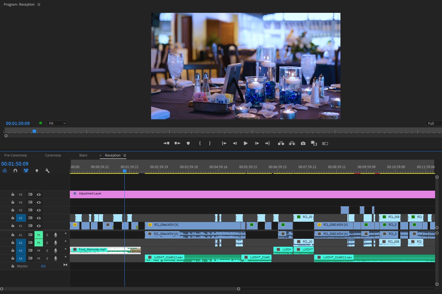

Lux Shots Posted March 3, 2021 Share Posted March 3, 2021 On 2/19/2021 at 10:35 AM, Stab said: Hi guys. I'm looking at upgrading my PC. I'm considering the Ryzen 5900x and 5950x at the moment. It would be paired with 64 GB of ram @ 3200mhz. My current GPU is a 1070ti and because of the low supply of current gen GPUs that will probably go back in there as well. Does anyone of you have experience with these CPU's with Adobe Premiere on Windows and the h.265 files from the S5 / S1H? I'm a wedding videographer and will only shoot in 4k 50 fps 10-bit 4:2:0 h265 codec from this season onwards. If there will be any season 🙂 Transcoding is not an option for me and I would really like to stick to Premiere (on Windows), which I know both are not 'optimal'. But I figured, one of these high end CPU's might do the trick. So, how is the timeline playback performance? Are there any dropped frames? What about 2 or 3 video tracks stacked on top of each other? And with some color grading and scaling? Anyone that has experience with this or a similar setup? Or maybe h265 files from the a7s3 or R5? Which are 4:2:2 I believe as opposed to 4:2:0, I don't know how much of a difference that makes. Thanks! Expand Hello! I exclusively use Premiere Pro and run with 32GB of Ram with a Ryzen 1700X with the Vega Frontier Edition 16GB Video Card, and I edit 5.9K H.265 from my S1H, albeit at the minimum reduced resolution. The performance is not optimal, as there are tons of dropped frames, but I also edit video straight off of my NAS drive over a 10GB SPF+ connection. If I copy a project locally onto my SATA drive, performance improves quite a bit. I also get a big performance boost if I have only 4K 60p footage. Here is a screenshot of my typical sequence, which I consider moderate complexity. I would have thrown in a 5900X or 5950X by now, but my motherboard doesn't currently support it 😞. Stab 1 Link to comment Share on other sites More sharing options...
Davide DB Posted March 4, 2021 Share Posted March 4, 2021 On 2/19/2021 at 10:35 AM, Stab said: I'm a wedding videographer and will only shoot in 4k 50 fps 10-bit 4:2:0 h265 codec from this season onwards. If there will be any season 🙂 Transcoding is not an option for me and I would really like to stick to Premiere (on Windows), which I know both are not 'optimal'. Expand Have you ever considered switch to Edius? Probably it's the most used NLE from wedding videographers for its speed. With your PC specs it will literally flies. It can even create proxes on the fly or setting lower resolution to speed up editing. Link to comment Share on other sites More sharing options...
Lux Shots Posted March 5, 2021 Share Posted March 5, 2021 On 3/4/2021 at 10:35 AM, Davide DB said: Have you ever considered switch to Edius? Probably it's the most used NLE from wedding videographers for its speed. With your PC specs it will literally flies. It can even create proxes on the fly or setting lower resolution to speed up editing. Expand Once you get into the Adobe Ecosystem, it's hard to leave. Whether it's for application specific plug-ins, like noise reduction or it's seamless integration with Audition and After Effects, switching is a bitch. At least I don't have the ability to do it, without a large time investment which runs against said productivity gains. Davide DB 1 Link to comment Share on other sites More sharing options...
