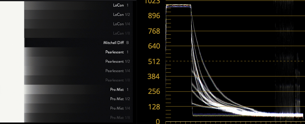

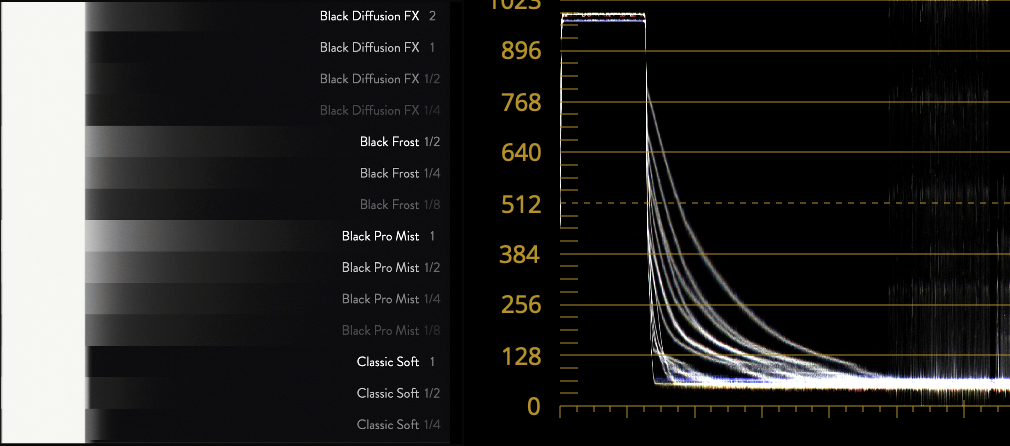

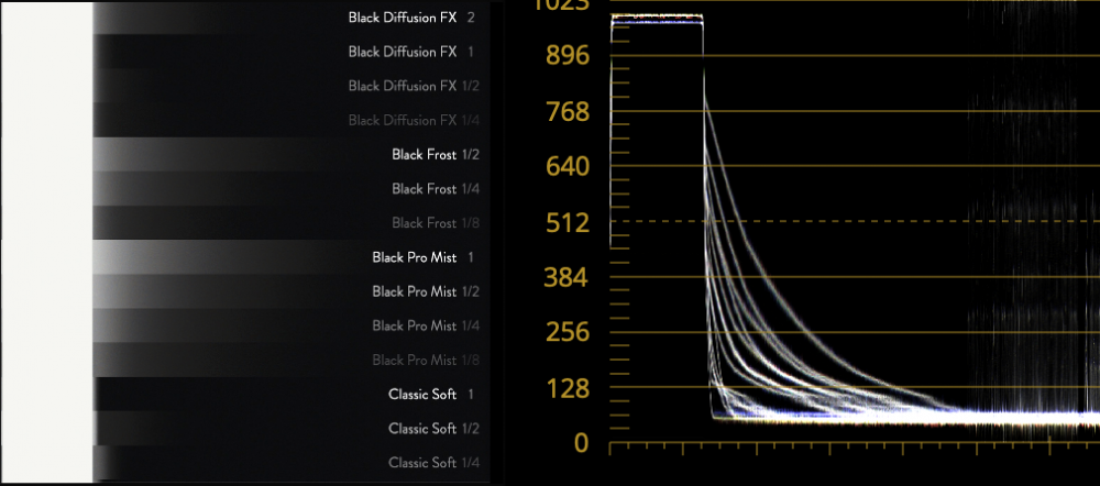

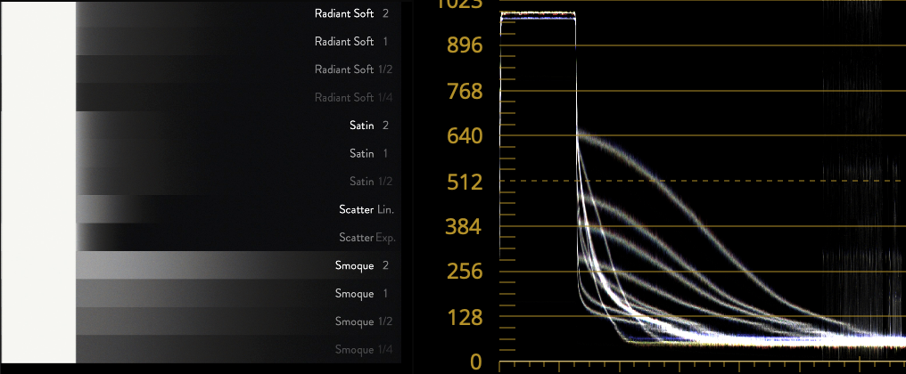

kye Posted February 22, 2021 Author Share Posted February 22, 2021 7 hours ago, HockeyFan12 said: Of those three, I've used Digital Diffusion FX, HDTV FX, and Smoque. Smoque looks to me like it's simulating filling a room with haze. Imo it's probably not what you're after. I think HDTV FX is a combination of Digital Diffusion FX and Ultra Contrast. Or it seems that way to me, at least. Ultra Contrast on its own is sort of like having a dirty UV filter or using a lens with light haze. It lifts the black levels like a controlled flare would when hit by light. This isn't so different from just using vintage lenses with older coatings (and internal haze and dust from age and lack of servicing), but for whatever reason I don't really like Ultra Contrast as much as I like vintage lenses. Ultra Contrast feels more all or nothing to me, a little unsubtle, or maybe I should have just used a weaker strength of it than I tried out. Digital Diffusion FX looks to me exactly like it does in Tiffen's video series and is the closest look to whatever the Alexa has that smooths the image out. I was recently comparing Alexa and C100 footage and the Alexa has a bit of in-camera sharpening I think and also a strong, smooth OLPF. The Alexa footage looks softer when you zoom in, but maybe sharper from a distance I think? Fwiw Red Dragon also has a strong OLPF. Black Magic imo is technically great but the 6K is a little too sharp for my preferences. https://www.youtube.com/watch?v=ryPILshPAFI https://www.youtube.com/watch?v=AIIg2opcab0 Download the sample files there if you're curious what I mean. Another issue is that when you have diffusion behind the lens, the size of the rear element is usually pretty consistent so you can keep the same strength approximately. But in front of the lens you might want a stronger filter for wider lenses to get the same amount of diffusion or halation or smoothness as a weaker strength provides on longer lenses. I like the look of Classic Soft and black nets and you can sort of use them as a shortcut to get a good look. But they look like you're using diffusion. I think Soderbergh and Spielberg and Richardson use them as it allows them to light a bit more sloppily and impressionistically than say, Deakins might. But if you can light for it, you can get a good look with anything. Anyway if I were shooting with a P4K or C100 or something I would probably use vintage lenses and Classic Soft, but I would shoot Classic Soft on film or Alexa, too, because I like it. Absent Classic Soft, if I were just going for a smoother look, I think Digital Diffusion FX and vintage lenses would do it. Not sure what strength. Almost all my lenses are single coated or have primitive multi-coatings. (On digital because I like it, on film, because I can't afford Ultra 16s. I do have one modern Canon zoom, but even it is a bit washed out at the long end I believe.) Edit: even if you don't want to use the Scatter software, look at the chart of familiar filters. Very useful to get an idea of what each does. Thanks, this is all very useful. I was thinking that I would want something that is a combination of contrast and resolution reduction without halation, but I'm not so sure now. Perhaps my main challenge is that it would be for shooting in available lighting, and so that means that the sun and other bright sources may well either be in frame, or out of frame but still hitting the filter. Something like a contrast filter, with its very wide spread of light, would have a radical effect if the sun was hitting the filter, even if it was out of frame by a large amount. I suspect these filters, and the people that want to emulate them in software, all assume that every scene will be controlled lighting and there will be no significant light sources in or outside of frame. That's where the halation filters come in. They spread the light quite widely, but no-where near as widely as the contrast ones do, so the frame won't be blown out when the sun is a long way out of frame. I'll have to do more research and work out what that special something is that I'm seeing. Interestingly, when I look at some of the filters I get that "ooh, it doesn't look like video any more" effect, but it doesn't seem to get less like video when the strength of the filter increases, so in that sense, maybe what I want is the filter that will do this "not video" effect but with the least amount of effect, so when I'm shooting something in golden hour the sun then it won't just blow out the whole frame, and I don't have to muck around with lens hoods. Your comments about the filter being in-front vs behind the lens are interesting too, considering that I may use this on a zoom lens, so obviously that would change the strength of the effect, or perhaps more accurately, the size / radius of the effect in relation to the size of the frame. Ultimately, all the ones we're talking about (digital diffusion, HDTV, smoque) all had that magic while not really impacting the image too much otherwise, except that I'm having trouble finding samples shot outside where the flare from the sun is a factor. I'll have to look into them more and see if I can extrapolate what they might look like from what I can find at sunset and the relative strength and spread from that Scatter plugin. Link to comment Share on other sites More sharing options...
HockeyFan12 Posted February 23, 2021 Share Posted February 23, 2021 Of those, Digital Diffusion FX is what I would recommend. Some of the black diffusion filters are nice, too, they lower the contrast less than the regular variants. kye 1 Link to comment Share on other sites More sharing options...
kye Posted February 23, 2021 Author Share Posted February 23, 2021 I've watched a bunch of tests, and decided that what I want is something that spreads the light the furthest. To put it another way, I want the edges of the frame to be lifted, and the area near the light-source to not be lifted much more than the edges. This is a useful video for seeing the BPM filters in a range of situations: For me, the BPM 1/8 filter was too much near the highlights, and too little on the edges of frame. So, we can look at that Scatter plugin, and have a look at what it thinks the filters are doing.. for example: That kind of view can show us the "response" of each filter type. Here's the rest of them in each strength: Very useful. Using a Power Window, we can isolate the ones that look interesting: This is the LoCon set: The 1/8 appears to scatter as far as the stronger ones, but obviously with less intensity. This is the Glimmer Glass set: Also quite wide-spreading, but the diffusion is gathered nearer to the highlight, and drops off a bit faster. Radiant Soft set: Also wide spreading, but slightly less than the LoCon. and Smoque: and for reference, here's Black Pro Mist 1/8 - 1: Link to comment Share on other sites More sharing options...
kye Posted February 23, 2021 Author Share Posted February 23, 2021 On 2/22/2021 at 9:53 AM, HockeyFan12 said: Contrast filters lift the black levels across the frame, resolution filters have a small-radius bloom or simply reduce the sharpness of the image without reducing the contrast, halation is a wider-radius bloom that reduces contrast locally but doesn't necessarily wash out the entire frame. Reference the chart on the Scatter webpage. I imagine Ultra Contrast would look like somewhat like a light gray solid if it were on that chart. Yes, it seems they're all just combinations of small diffusion for skin softening, large diffusion for contrast reduction, and medium diffusion for when someone in a 90s TV show dies and goes to heaven. Just kidding! The medium size is for 80s wedding photography. 6 hours ago, HockeyFan12 said: Of those, Digital Diffusion FX is what I would recommend. Some of the black diffusion filters are nice, too, they lower the contrast less than the regular variants. From their proximity on the Tiffen triangle chart, Digital Diffusion FX and HDTV FX should be similar, but I vaguely remember a comparison that showed a pretty significant contrast reduction from the HDTV that the DD didn't have. It's a pity it's not compared in the Scatter plugin website. I'll have to look around and see what I can find in terms of comparison images. I'm not afraid of lowering contrast too much as I'll be shooting in 10-bit and can expand contrast back in post. Link to comment Share on other sites More sharing options...
HockeyFan12 Posted February 23, 2021 Share Posted February 23, 2021 Yeah that sounds about right. Find a cheap Ultra Contrast filter on eBay or Amazon and try it out. I directly compared a Digital Diffusion FX 1 and HDTVFX 1 a while back. They looked similarly, the difference was HDTV FX had milky shadows. I have the files somewhere but I didn't label them so I doubt I can find them quickly. Years ago I tried out a bunch of Ultra Contrast filters alone and it wasn't what I wanted. I was watching an explanation of MTF on YouTube and the idea is at different frequencies of resolution you get different amounts of contrast. You could probably model diffusion filters as MTF functions. You can definitely mix and match to get an interesting look. Spielberg's DP used a lot of diffusion filters but he also used bleach bypass and ENR processes that increased contrast so it was a balancing act between adding and subtracting contrast and getting the right ISO and contrast ratio. He typically used modern lenses, though. Also the MTF function of film stocks rises above 100% and then dips down slowly. Digital stays around 100% until extinction. Normally digital sharpening looks bad to me, but I think the Alexa has a strong diffusion filter that slowly smooths out fine detail but Alexa ProRes has built-in sharpening that actually looks good because it's a wider radius of sharpening. Like unsharp mask with a radius of 2-3 pixels instead of 1, for instance, but I'm just guessing. There are little sharpening halos in 2k Alexa footage. I sort of lost interest when it got so complicated. But I own vintage lenses and a few Classic Soft filters and I did like the look of Digital Diffusion FX but it was a very subtle difference. Link to comment Share on other sites More sharing options...

barefoot_dp Posted February 24, 2021 Share Posted February 24, 2021 On 2/23/2021 at 7:03 PM, kye said: From their proximity on the Tiffen triangle chart, Digital Diffusion FX and HDTV FX should be similar, but I vaguely remember a comparison that showed a pretty significant contrast reduction from the HDTV that the DD didn't have. It's a pity it's not compared in the Scatter plugin website. I think this is my biggest gripe with these types of charts: They actually end up putting opposites together in some cases. Eg, if one filter is an equal balance between high contrast and high resolution, and another is an equal balance between low contrast and low resolution, then they would both be mapped in exactly the same spot (ie halfway between the contrast and resolution corners) even though they do the exact opposite of each other. This is why I always find these charts so confusing! But hey, they look pretty! Link to comment Share on other sites More sharing options...
HockeyFan12 Posted February 24, 2021 Share Posted February 24, 2021 3 hours ago, barefoot_dp said: I think this is my biggest gripe with these types of charts: They actually end up putting opposites together in some cases. Eg, if one filter is an equal balance between high contrast and high resolution, and another is an equal balance between low contrast and low resolution, then they would both be mapped in exactly the same spot (ie halfway between the contrast and resolution corners) even though they do the exact opposite of each other. This is why I always find these charts so confusing! But hey, they look pretty! The chart isn't great imo, but in general "contrast" means "low contrast." So anything in that corner is reducing contrast. Nothing is adding more contrast, everything reduces it somewhat. But filters with black dots reduce it less, Ultra Contrast introduces a controlled flare and reduces it more. I do think the difference between Digital Diffusion FX and HDTV FX is stronger than the chart would indicate, but it probably depends on the strength of the filer. Link to comment Share on other sites More sharing options...

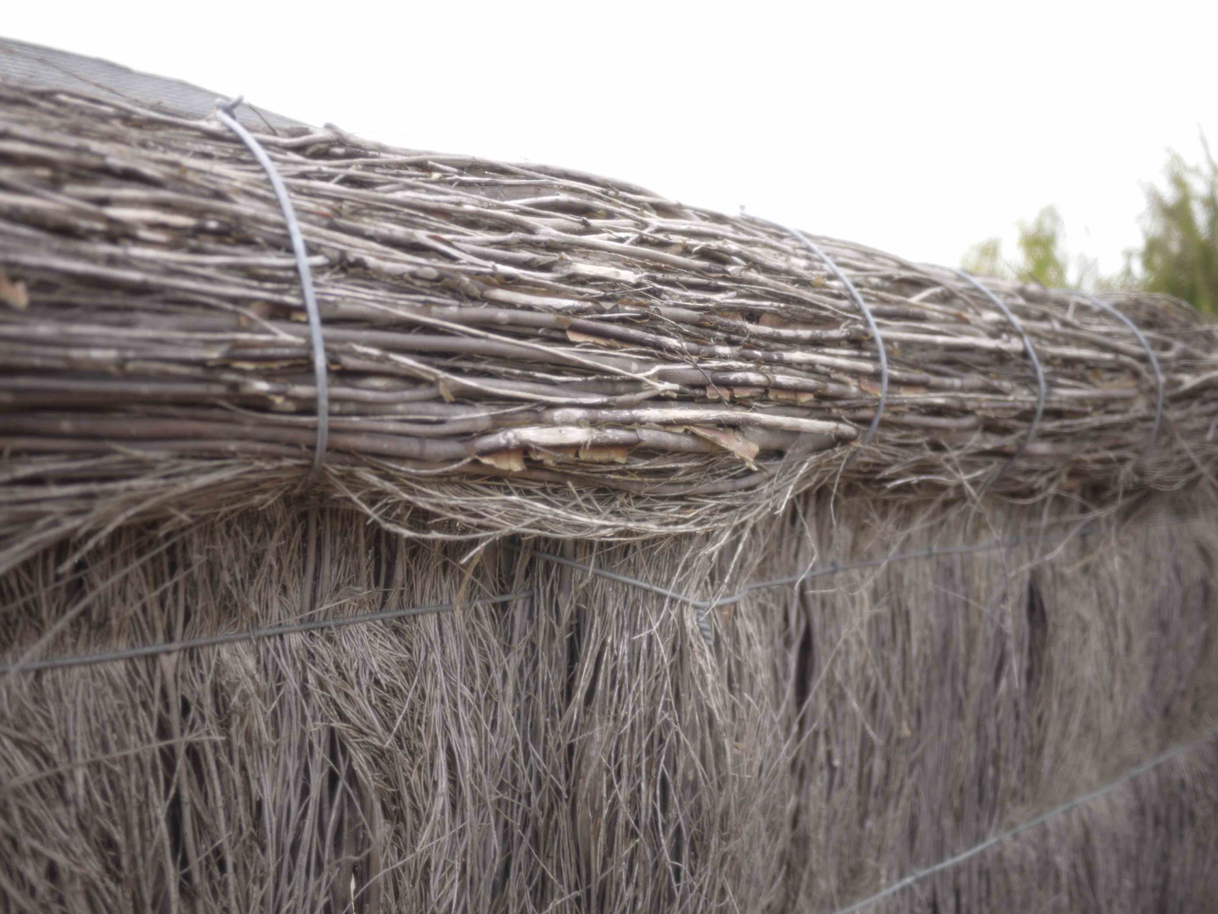

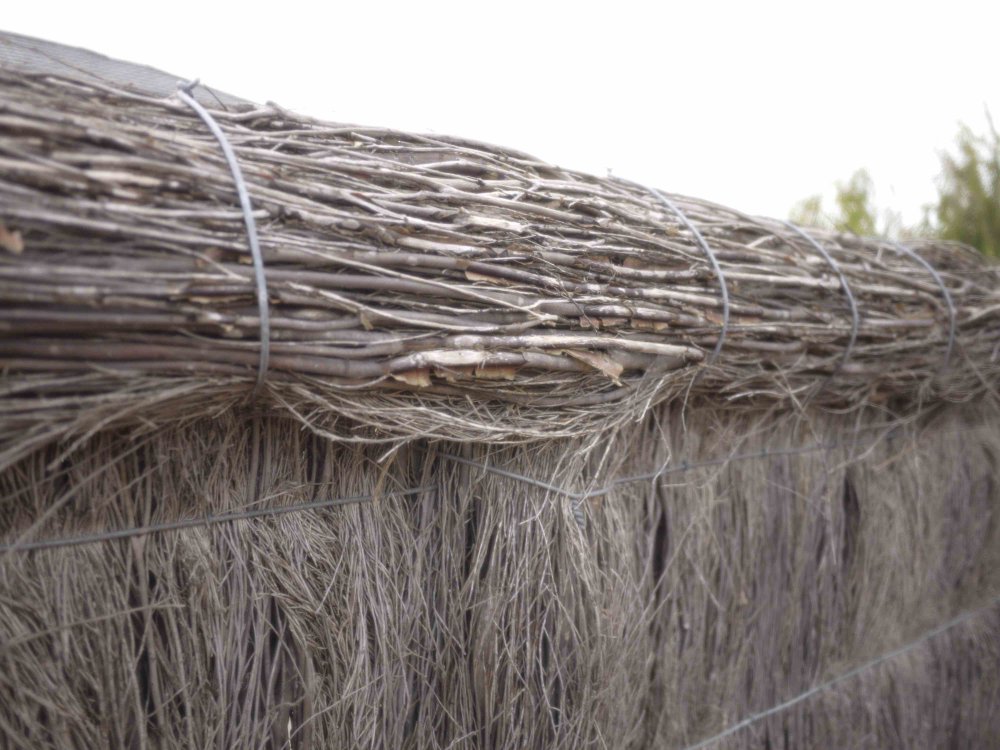

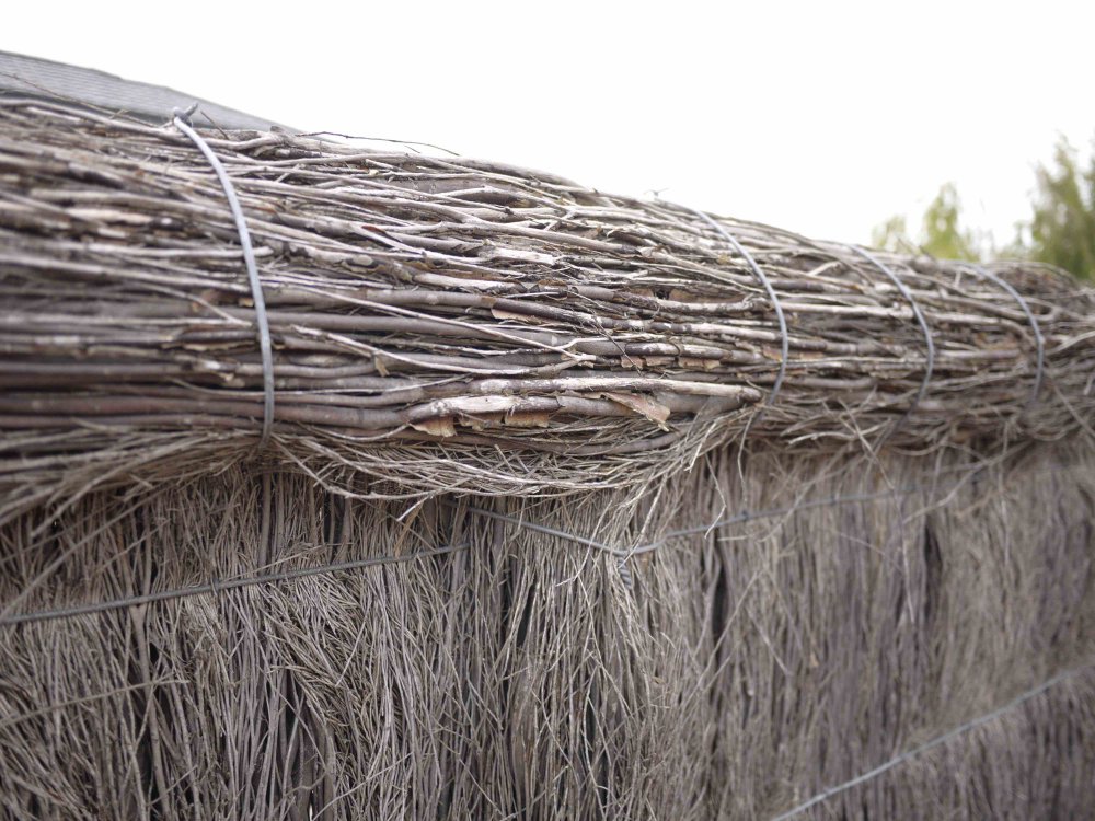

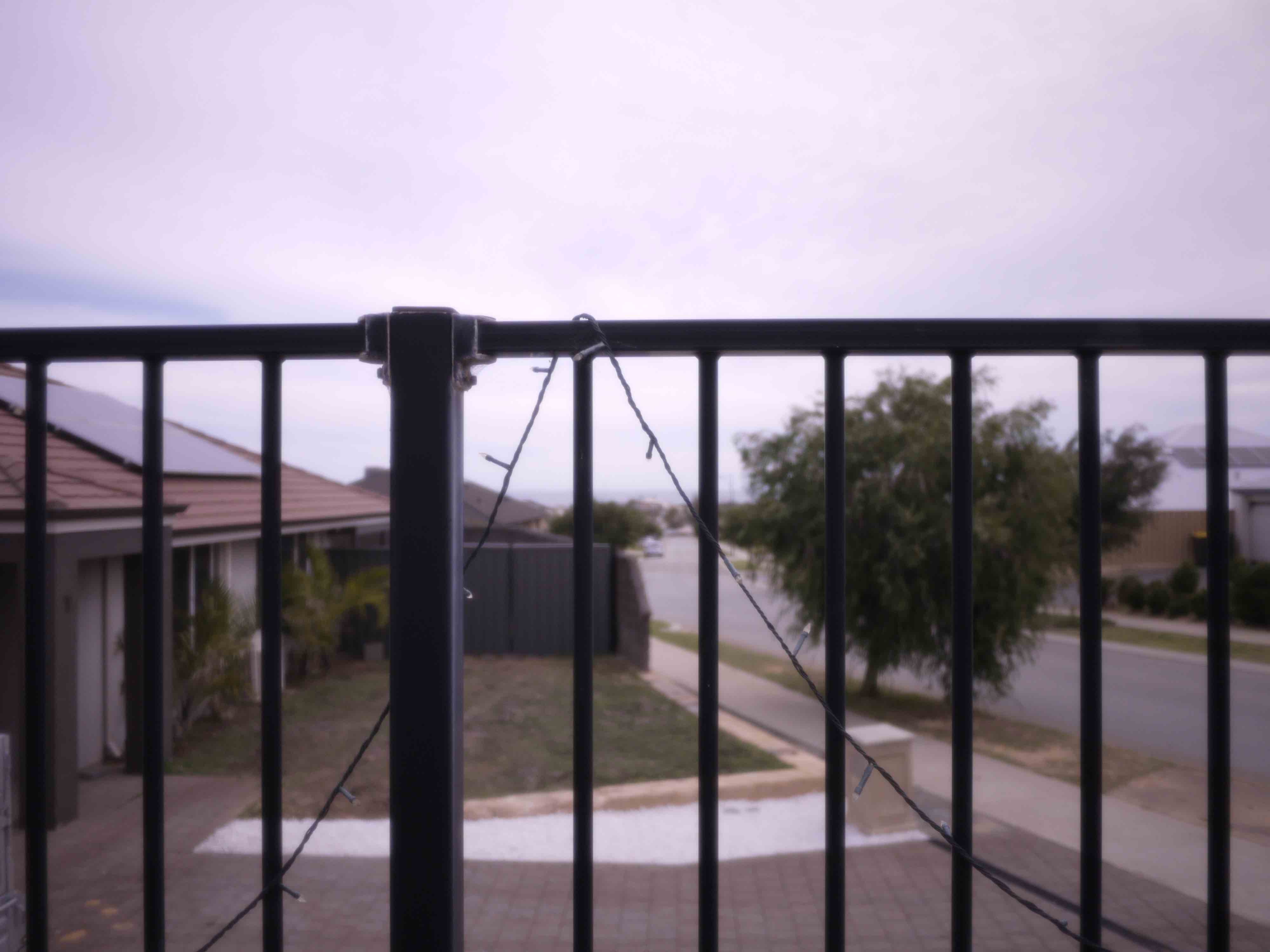

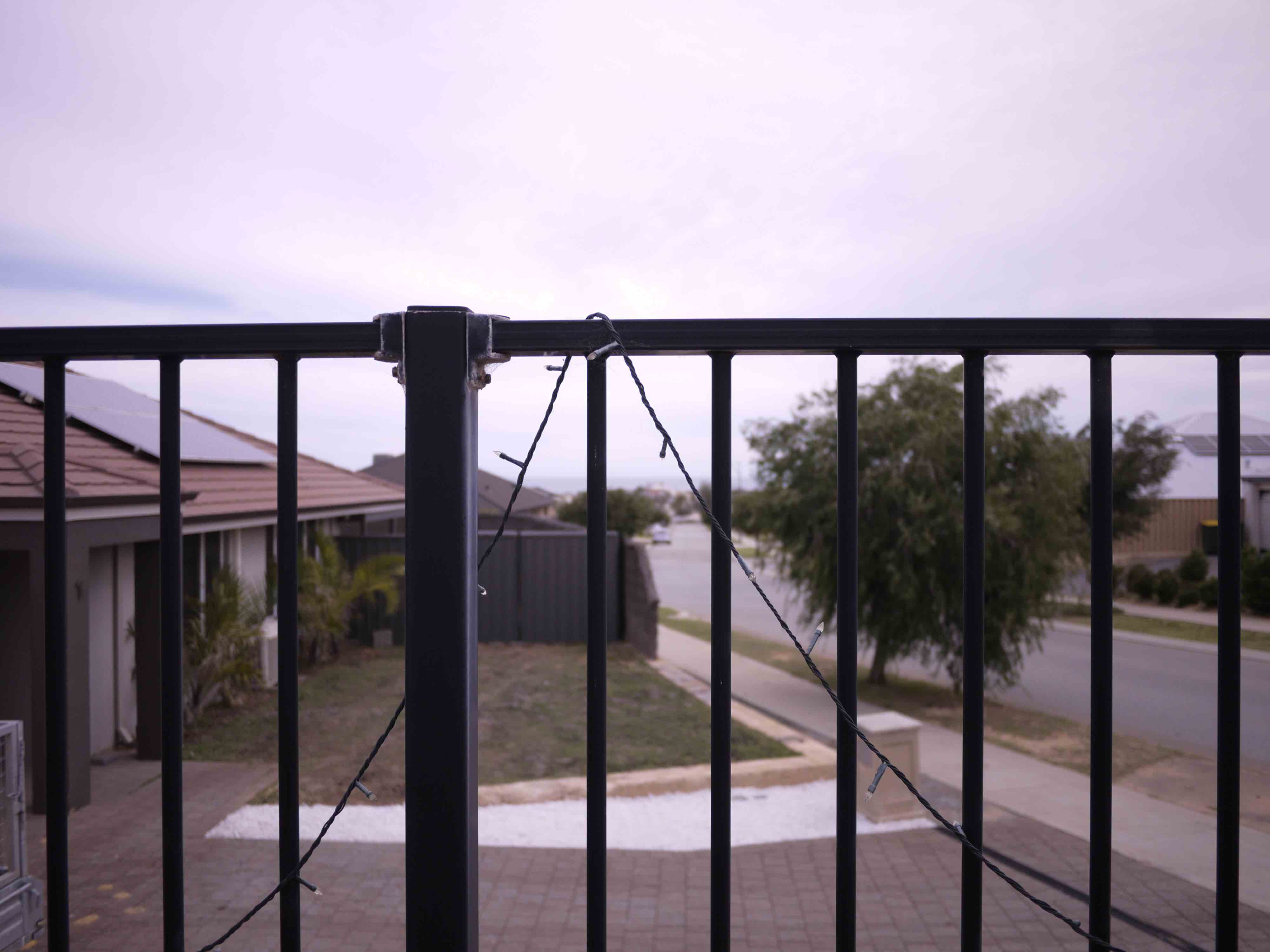

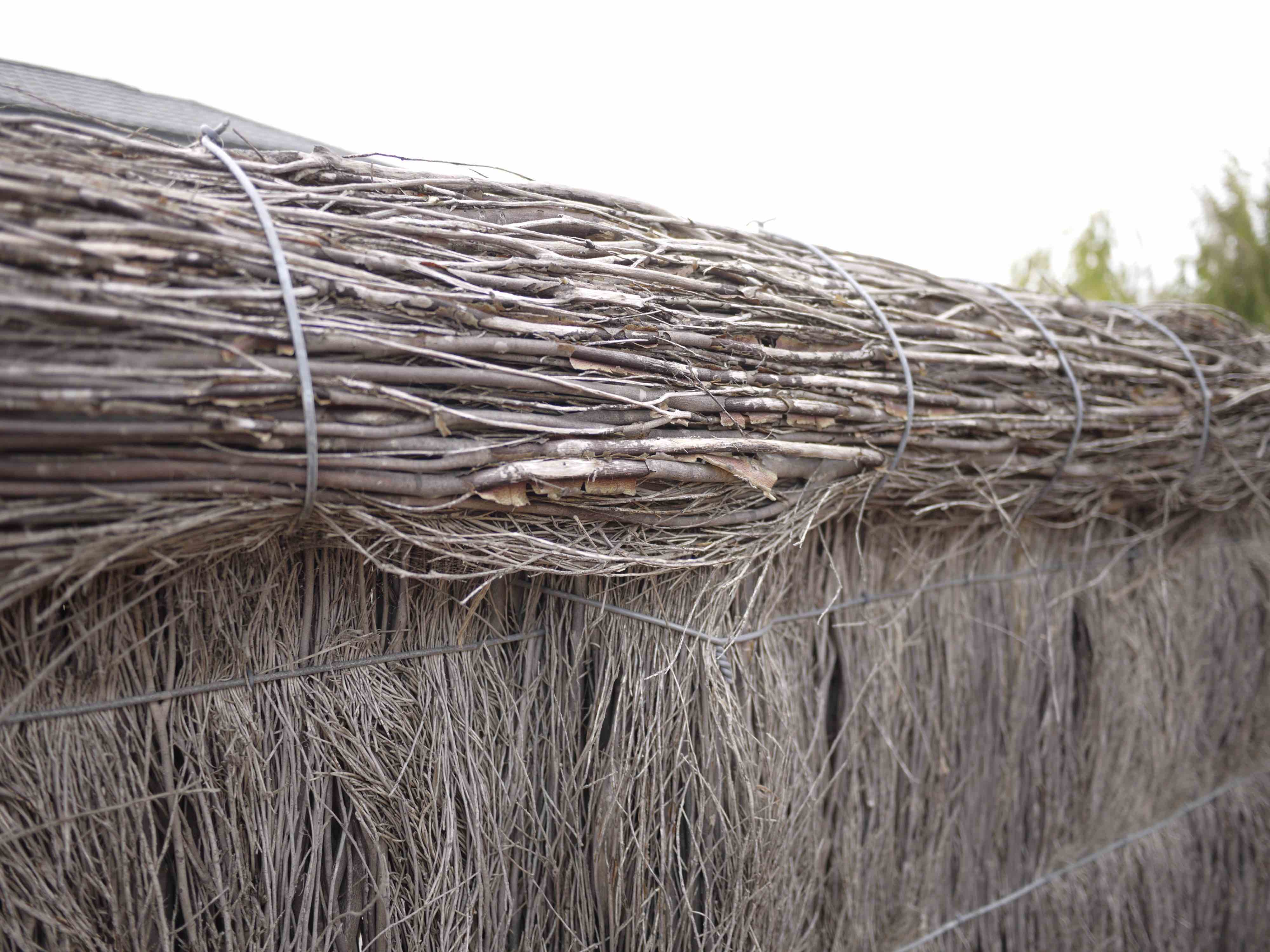

kye Posted April 23, 2021 Author Share Posted April 23, 2021 I ordered my Tiffen Black Promist 1/8 filter in 58mm as that fits all my lenses, but didn't want to have to use step-up rings on my tiniest setups (GF3 + 15/8 or 14/2.5) so looked around for the cheapest 52mm diffusion filter I could find. Enter the "52mm Softfilter Spezialeffekt Diffusor Weich Filter für DSLR kameraobjektiv" which cost EURO5.49 with free shipping. Hey big spender! It took quite some time to arrive here in AU. It came with the normal hard crystal plastic case and in a padded envelope, of course I'd have preferred that the filter was IN the case, rather than WITH the case in the envelope, but that just made me clean it and carefully check it for any damage, but it seems unharmed. It is a little strange though. The surface is a bit bumpy, and this is what it looks like: and here is a test with and without the filter (GF3, 14/2.5, RAW stills): It seems to be quite a strong effect, although I find it a bit deceptive because if you zoom in there isn't that much blurring. Given that I bought it for use on 1080p cameras, that will lessen the impacts on fine detail, so I'll have to put it through its paces on some real footage. Link to comment Share on other sites More sharing options...
