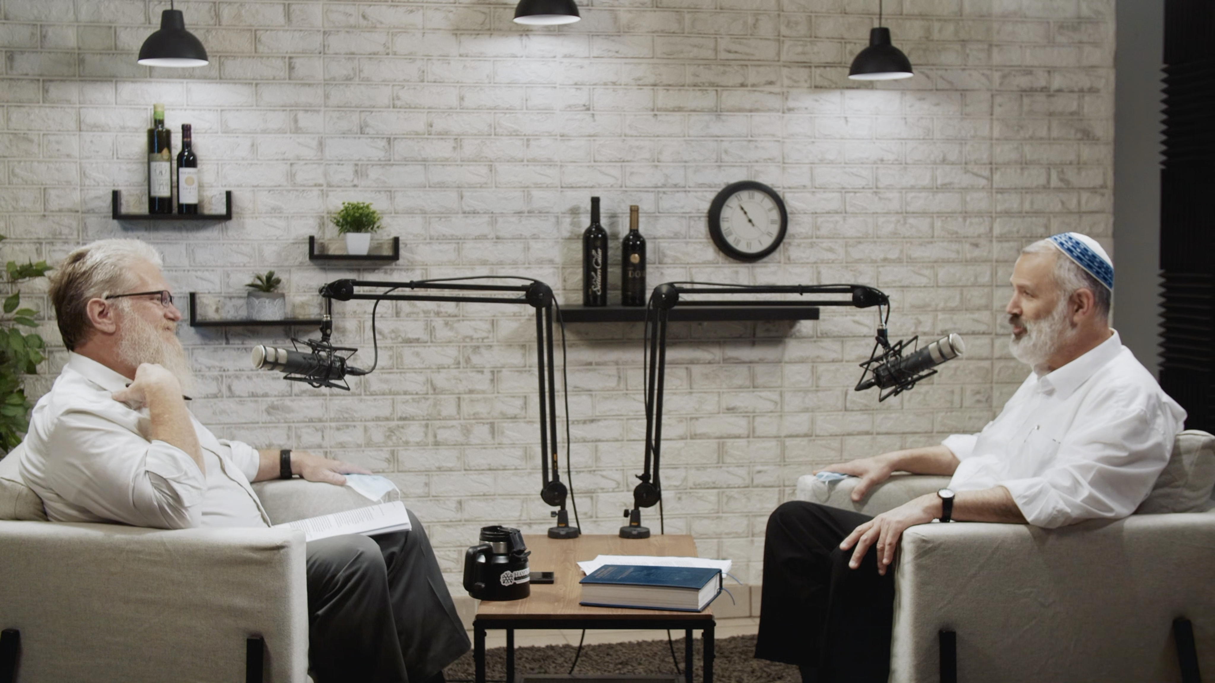

Benjamin Hilton Posted March 9, 2021 Share Posted March 9, 2021 Hey there, I am running a small home studio with several different weekly shows using Rode Procaster mics. For one of the shows we just started (two person conversation), aesthetically it would look better to use lavs instead of the Procasters. I tried setting up with my Countryman b3s, but because of the room acoustics and phasing of two mics it's sounding pretty bad. The room is fairly decent acoustically, decent enough to sound great with the Procasters. Other than completely sound proofing the room, is there anything I can do to get better audio with lavs? Wondering if a cardioid lav or something would work better. It should be possible since they use lavs in news rooms conversations and it sounds pretty good, couldn't imagine their studios are super acoustically dead either. Link to comment Share on other sites More sharing options...

jpleong Posted March 9, 2021 Share Posted March 9, 2021 What happens when you flip the phase of one of the mics? Situations like this with omni lavs: 1) Position the mics as far apart as possible. Usually on the shoulders/lapels farthest from the other speaker. 2) In post, mute automate (or cut) the non-speaker's audio. Gating sometimes works. It's tricky because they're almost completely facing each other so the omni lavs are acting like boundary mics. Do you have the budget for some booms? Like, ME64/66? JP Link to comment Share on other sites More sharing options...
