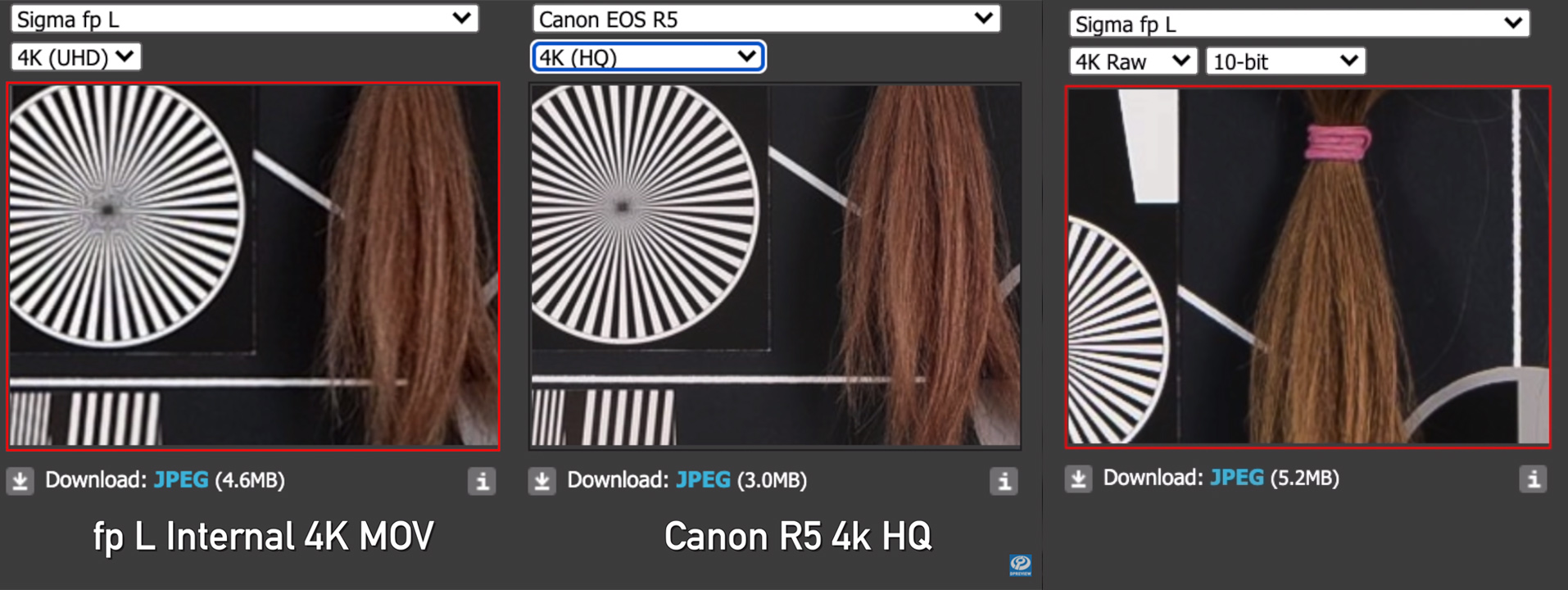

amweber21 Posted March 27, 2021 Share Posted March 27, 2021 Another thing I noticed. Watching the dpreview on it he compares a couple of the video options. The internal is better than the a7R IV, but the cinemaDNG in 10bit look to have the detail level of the R5's 4K HQ. In 12bit it line skips again and softens. This may be a strange balance of crop vs bit depth to figure out. Quote Link to comment Share on other sites More sharing options...

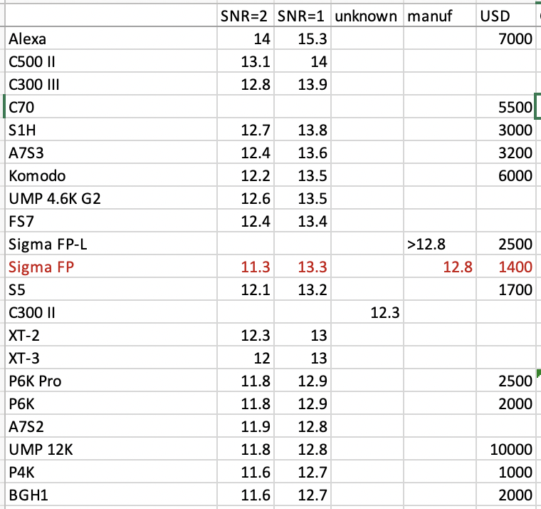

kye Posted March 27, 2021 Share Posted March 27, 2021 It looks quite interesting actually, if you're willing to shoot 1080p. I think in 1080p, you get: Internal RAW in 8/10/12 bit Downscaling from 8K Digital cropping from 1.0 to 5.0 which are all downscaled from the 8K That could mean you could make a tiny portable/pocketable setup, for example if you chose a 20mm lens you could use it like a 20-100mm. Could be interesting for tiny covert setups. I've been compiling a chart of DR tests and the FP seems like the cheapest and smallest way to get a high-DR camera. Quote Link to comment Share on other sites More sharing options...

kye Posted March 28, 2021 Share Posted March 28, 2021 12 hours ago, TomTheDP said: Not sure how accurate that list is. The P6K has more dynamic range than the URSA 4.6k by a good bit. Also the S1H and S5 dynamic range aren't that far apart, maybe 1 stop at most. Same sensor, same codec, same log. I went back and re-examined the two curves and it look like you're right, and that there are complications in the way that they tested the outputs from the UMP, to do with NR or something I think. Personally, I only built this table for my own purposes and the UMP isn't an option that I'd consider due to its size, so it's not a big deal for me.. Looking at the waveforms, it seems like the P6K has maybe 1-2 stops more DR than the UMP 4.6K G2. Regardless, I found the tests at C5D to be useful, and definitely better than the manufacturers (often heavily inflated) claims! Quote Link to comment Share on other sites More sharing options...

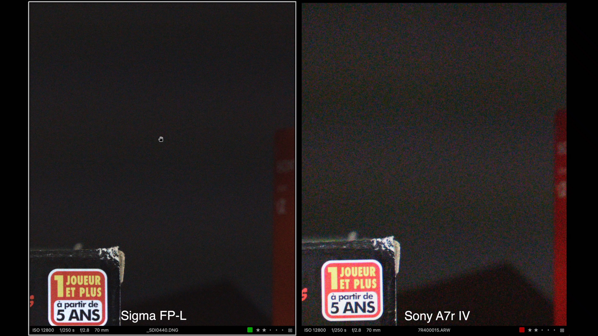

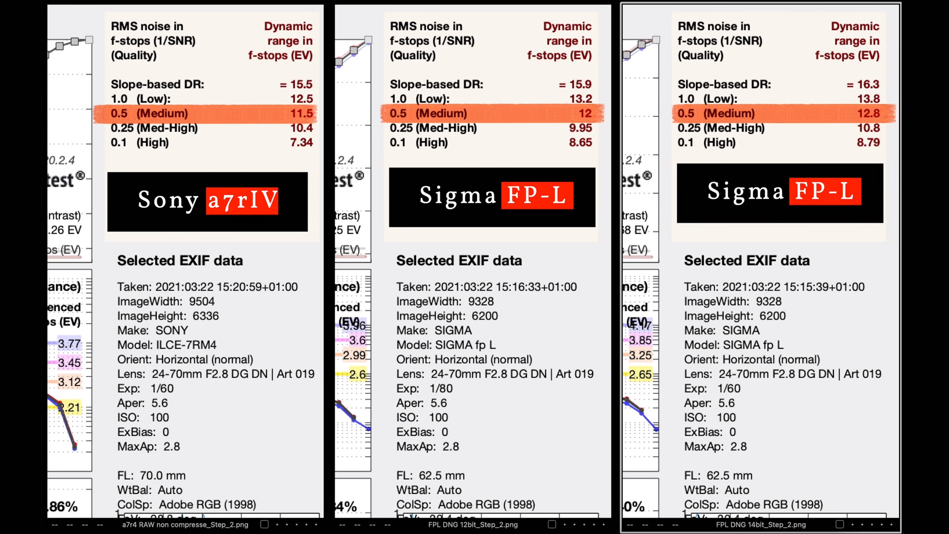

amweber21 Posted March 28, 2021 Share Posted March 28, 2021 I am curious the improvement in dynamic range of the fp L over the original. According to a review it was measured at 12.0, up from the 11.3 of the fp. This was in 12bit stills image, but I would think it should translate to the same in 12bit video. It is better than what the a7R IV is measured at and far cleaner at 12,800. Quote Link to comment Share on other sites More sharing options...

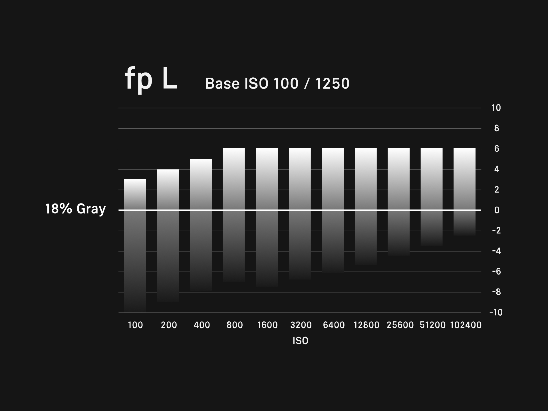

noone Posted March 28, 2021 Share Posted March 28, 2021 On 3/27/2021 at 10:06 AM, amweber21 said: Here's the official dynamic range for given iso values: If that is correct, that is fantastic at higher ISOs. 8 plus stops at ISO 102400? Seriously? Even the original A7s only has around 7.5 stops of DR at that ISO. Others A7Riv about 6.5 stops, A7iii just over 7 stops, Nikon Z6 and Panasonic S1 and Canon R6 all about 6.5 stops and those are the better cameras at that ISO. I am happy to have that as the highest setting on my A7s but would prefer to go lower than about 80,000 when possible. Am I missing something with that chart? Quote Link to comment Share on other sites More sharing options...

TomTheDP Posted March 28, 2021 Share Posted March 28, 2021 11 hours ago, kye said: I went back and re-examined the two curves and it look like you're right, and that there are complications in the way that they tested the outputs from the UMP, to do with NR or something I think. Personally, I only built this table for my own purposes and the UMP isn't an option that I'd consider due to its size, so it's not a big deal for me.. Looking at the waveforms, it seems like the P6K has maybe 1-2 stops more DR than the UMP 4.6K G2. Regardless, I found the tests at C5D to be useful, and definitely better than the manufacturers (often heavily inflated) claims! Yeah I find their dynamic range readings helpful sometimes. I think where it fails is reading the shadows properly. The readings become inaccurate when noise reduction comes into play and of course how much noise is acceptable is also a subjective thing. This is where it gets really confusing as the URSA shadows really fall apart especially due to the fixed noise pattern and the URSA is also weaker in the highlights. So I have no clue why the reading for the P6K is so low compared to the URSA. The P6K does about 2 stops more in the highlights than the S1H or A7S3. The question is, are the Pocket shadows that much worse than the S1 or A7S3 to warrant such a low rating? I'd say the dynamic range on all three cameras are very similar. IMHO the only camera that really punches above the rest in terms of dynamic range is the C70. The S1, A7s3 and P6K are all great but also all in the same league or at least relatively close with the P6K and S1 in the lead by a little. I think the original FP is a compelling camera. CDNG is probably the best form of video recording(highest quality*) 12 bit CDNG Full frame is pretty compelling. The lack of full HDMI is a bummer though. I'd love to test the camera with an under and over test to see how it actually compares to the S1 or A7S3. I'd imagine it should be similar as they all use Sony sensors. But maybe Sigma did something weird to gimp it. kye 1 Quote Link to comment Share on other sites More sharing options...

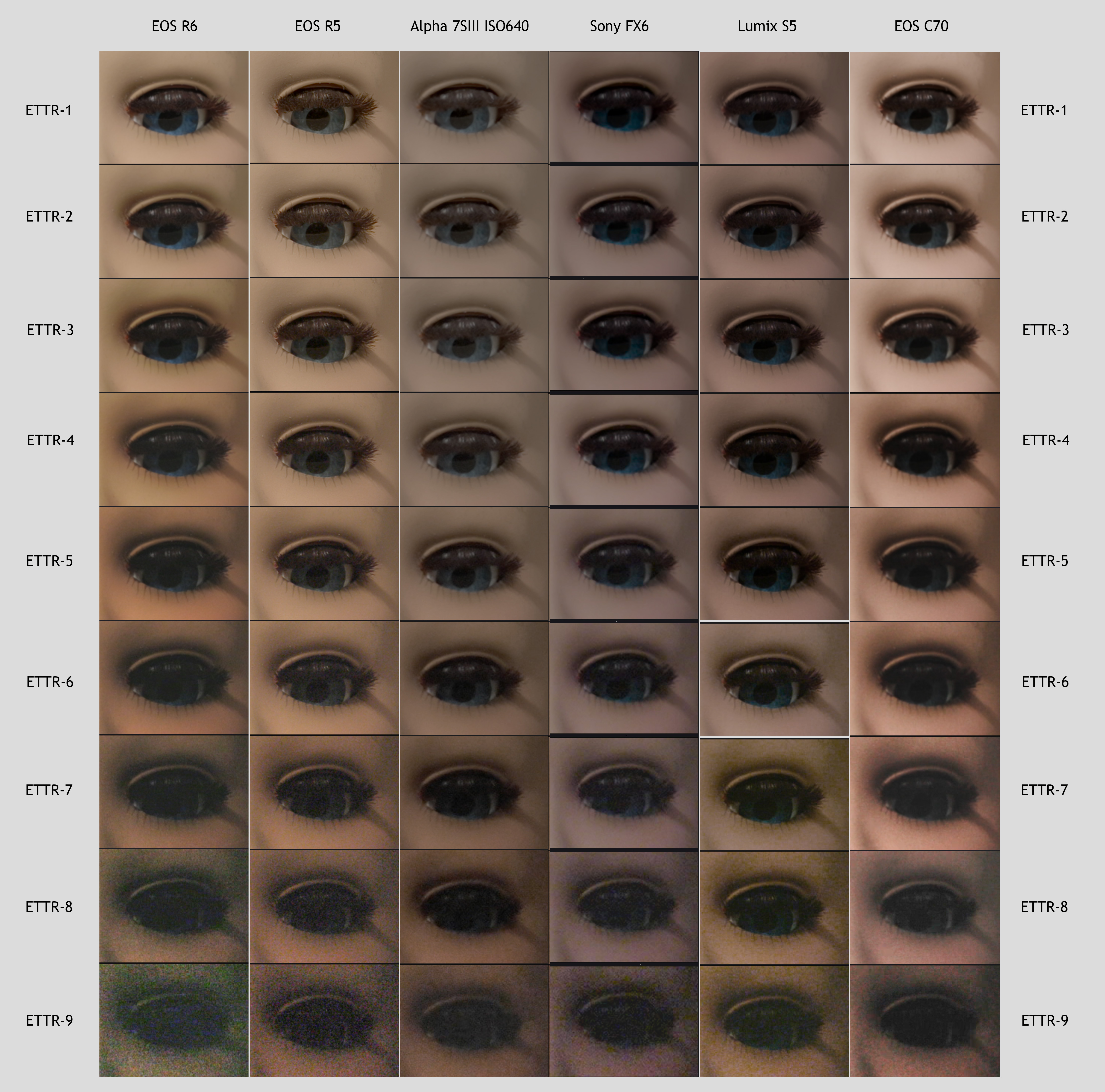

deezid Posted March 28, 2021 Share Posted March 28, 2021 1 hour ago, TomTheDP said: IMHO the only camera that really punches above the rest in terms of dynamic range is the C70. The S5 (S1H/S5 also) outperform it in usable latitude. Sure IMATEST loves heavily denoised footage like from the A7sIII or C70, but the IQ is quite bad on these cameras in comparison. The Pocket 6K (Pro), S5/S1H/S1 and Komodo are the best cameras in that regard under $10,000. Here's a nice exposure comparison chart from Slashcam: kye 1 Quote Link to comment Share on other sites More sharing options...
TomTheDP Posted March 28, 2021 Share Posted March 28, 2021 19 minutes ago, deezid said: The S5 (S1H/S5 also) outperform it in usable latitude. Sure IMATEST loves heavily denoised footage like from the A7sIII or C70, but the IQ is quite bad on these cameras in comparison. The Pocket 6K (Pro), S5/S1H/S1 and Komodo are the best cameras in that regard under $10,000. Here's a nice exposure comparison chart from Slashcam: I didn't know the C70 used a lot of noise reduction. The FX6 seems more organic. deezid 1 Quote Link to comment Share on other sites More sharing options...
deezid Posted March 28, 2021 Share Posted March 28, 2021 9 minutes ago, TomTheDP said: I didn't know the C70 used a lot of noise reduction. The FX6 seems more organic. The FX6 is probably the better choice if you want it match it with a proper cine camera. This camera has a really nice looking image. The C70 looks quite mushy although not as bad as the Pocket 4K (only Braw) or A7sIII (ProRes Raw fixes it). Quote Link to comment Share on other sites More sharing options...
