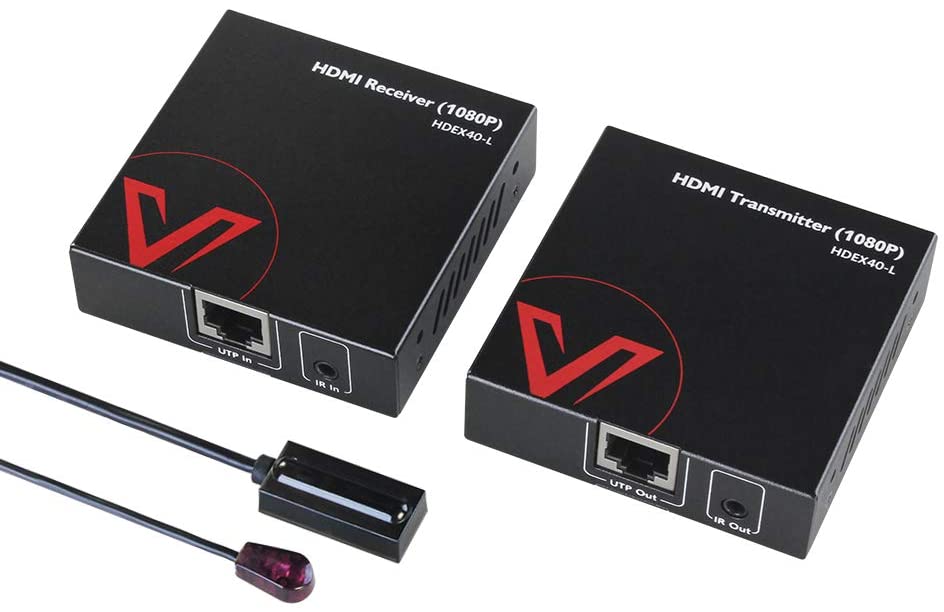

Super Members BTM_Pix Posted May 12, 2021 Super Members Share Posted May 12, 2021 Have a look at converter solutions such as this which run it over Cat5e/6a/7 to get 50m runs https://www.amazon.co.uk/dp/B07H8Y5JF4 They are only 1080p but so is the switcher so thats not an issue. It needs power at the camera end but its only USB so there are a gazillion solutions for that. The IR transmitter might be relevant if you use Sony or other cameras that have IR remotes because you'd then be able to control camera functionality such as focus/zoom remotely. You could also do a similar thing using SDI converters at either end but they need power at both ends and even at the low end they are double the price of this £35 per channel option. Juank and newfoundmass 2 Link to comment Share on other sites More sharing options...
newfoundmass Posted May 12, 2021 Author Share Posted May 12, 2021 8 hours ago, ntblowz said: up to 25meter is fine, more and it will have to be active fibre HDMI cable? So 25 meter is like 80 feet? Sorry we're American and don't use the metric system like a bunch of assholes! Lol 7 hours ago, BTM_Pix said: Have a look at converter solutions such as this which run it over Cat5e/6a/7 to get 50m runs https://www.amazon.co.uk/dp/B07H8Y5JF4 They are only 1080p but so is the switcher so thats not an issue. It needs power at the camera end but its only USB so there are a gazillion solutions for that. The IR transmitter might be relevant if you use Sony or other cameras that have IR remotes because you'd then be able to control camera functionality such as focus/zoom remotely. You could also do a similar thing using SDI converters at either end but they need power at both ends and even at the low end they are double the price of this £35 per channel option. Was looking at something like that, especially because two of my three cameras have smaller HDMI which probably limits my options but also I need to make sure they're kept secure so not to ruin the HDMI port. I was thinking, in addition to locks on their cages, it might not be a bad idea on general for the longer portion to be separate so to ensure as little stress gets put on the HDMI ports as possible, though then that adds another possible point of failure! Is there a specific brand I should also use? For normal use I've just gone with Amazon Basics cables for my TV and gaming systems. They work fine but obviously that's for simple stuff that I'm not gonna be screwing around with. Link to comment Share on other sites More sharing options...
