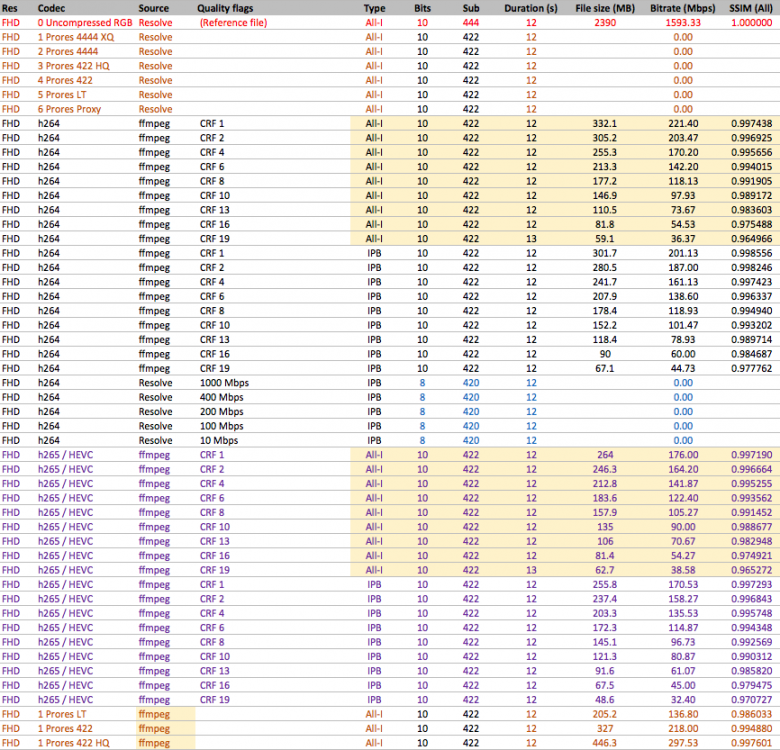

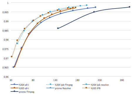

Thomas S Posted May 26, 2021 Share Posted May 26, 2021 On 5/26/2021 at 10:16 PM, kye said: Good points. I did a bunch of testing on the overall image quality of various codecs and bitrates in a separate thread some time ago, and here's the results I got from 1080p: and graphed: Prores and h264 from Resolve are in the key but not in the graph because its quality is poor and below the graphing area. Resolve is known for not having great encoders unfortunately. The rest of the thread is here: Results were similar for UHD, so not worth repeating. I do wonder about the perceptual / aesthetic aspects of the errors that each generates. My perception is that Prores always looks so much better than h26x codecs, and I wonder if that's the nature of the error. For example if you take an image and blur it then you will generate a rather significant error from the source image but it would probably be very benign aesthetically, whereas if you took vertical stripes 10px wide and increased their brightness to get the same overall total error across the image it would be almost unwatchable, and a similar thing happens comparing random noise with fixed-pattern noise, so the nature of the error is of significant aesthetic concern. Of course, it could be that Prores tends to look nicer due to its higher bitrates, or tendency to have less sharpening added prior to compression, or 422 instead of 420, etc. I also agree that 100Mbps is sufficient most of the time, but the problem is that when you buy a camera costing multiple thousands of dollars you are likely to hit the situation where it's not sufficient at some point during your ownership of that camera, and for every person that buys it and doesn't hit that situation (for example always shooting in controlled conditions) there will be another person who buys it for use in outdoor adventure and films trees in the wind, rain, snow falling, all while hand-held, and basically experiences those problems on a weekly basis. It's like putting the tyres from a corolla on a Ferrari and not being able to change them - it's a huge bottleneck for the output of the camera. Expand Thats why I got a Pocket 4k. I got tired of the farting around with compressed formats. External recorders are the way to get around that nut thats also a hassle. Now I can shoot 3:1 Braw on a cheap SSD directly on the camera or at least 5:1 on an internal SD card. Now that some DSLRS are getting external raw support I still don't really care. Its an added cost to get an external recorder and its a lot more hassle than what I have now. I'm also kind of a freak for 4:4:4. I know visually it actually doesn't make a huge difference. I studied VFX in college and can pull damn good keys with 4:2:0. To me its more about why 4:2:2. Its a left over from the analogue days and we don't really need it anymore. We have fast and cheap enough media now to not worry about 4:2:2. Its an old broadcast video standard and really has no place in our digital world today. h264 and h265 are also very capable of 4:4:4 but we are barely getting cameras to add 4:2:2 and 10bit let alone 4:4:4. So Braw on the P4k represents something I have been trying to achieve ever since I started with SVHS and have been trying to get something better than video standards. Its not just because its raw. To me its because its RGB, 4:4:4 and color space agnostic. No more butchered rec709, no more unnecessary 4:2:2. I know visually I could probably do the same with a lesser format but to me its just about starting clean and go from there. It represents what I always dreamed of being able to do with video. Oh yeah and its 12bit which will be even harder to make an argument for than the 10bit vs 8bit argument. But hey its there and doesn't hurt so why not. Fun fact. 12bit has 4096 samples. DCI 4k resolution is 4096 wide. Thats exactly one sample per pixel for a full width subtle gradient or in other words the perfect bit depth for 4k. Not sure anyone could ever tell vs one sample every 4 pixels like 10bit has but hey there it is. Basically posterization should be physically impossible on the P4k shooting Braw. TheRealOG and Katrikura 2 Link to comment Share on other sites More sharing options...
