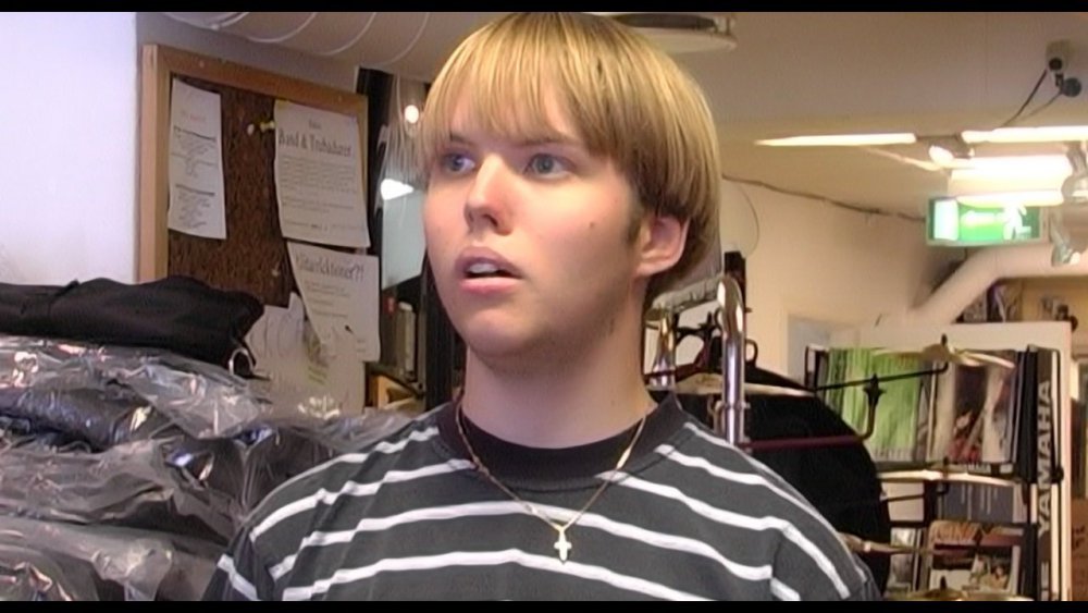

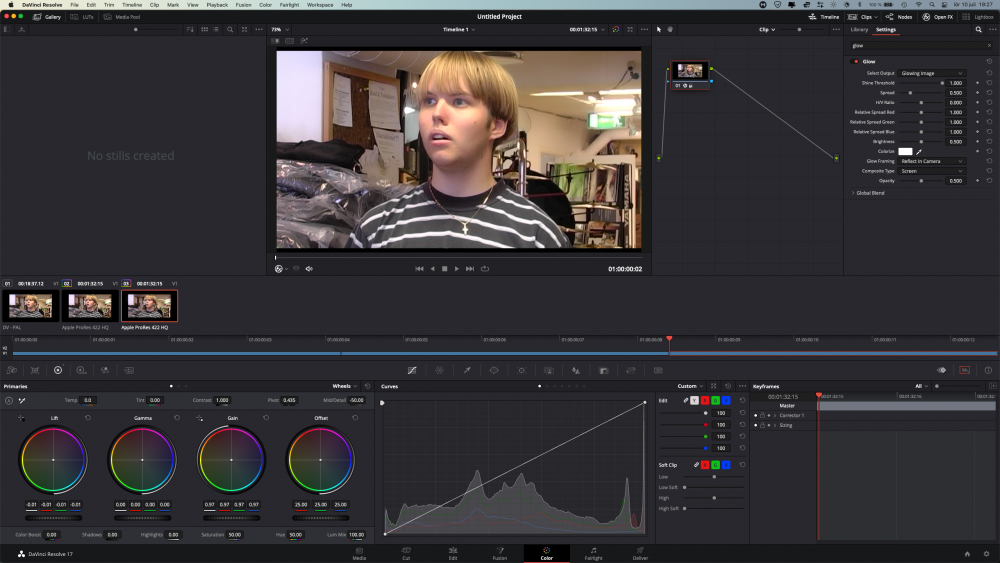

Ingerson Posted July 10, 2021 Share Posted July 10, 2021 Follow up to my post about upscaling and de-interlacing with QTGMC and then playing with Midtone detail in negative values. Picked this frame since it's pretty classic DV and bad lighting. First frame is the original DV (in 720p timeline), then the upscaled frame and #3 the upscaled frame with -50 mid/detail, slightly lowered gain and lift and lowest possible glow. Screencap of Resolve at the end. Not really something magic, still not great, but definitely better. leslie and John Matthews 2 Link to comment Share on other sites More sharing options...
