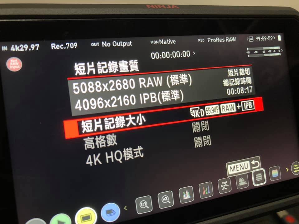

ntblowz Posted August 19, 2021 Share Posted August 19, 2021 Saw it from Fb, 5K60P RAW out is available now Emanuel 1 Link to comment Share on other sites More sharing options...
markr041 Posted August 19, 2021 Share Posted August 19, 2021 5k60p RAW is a crop of the sensor. 8k RAW to the Ninja V+ is 10 bit, while internally it is 12bit. Emanuel 1 Link to comment Share on other sites More sharing options...
