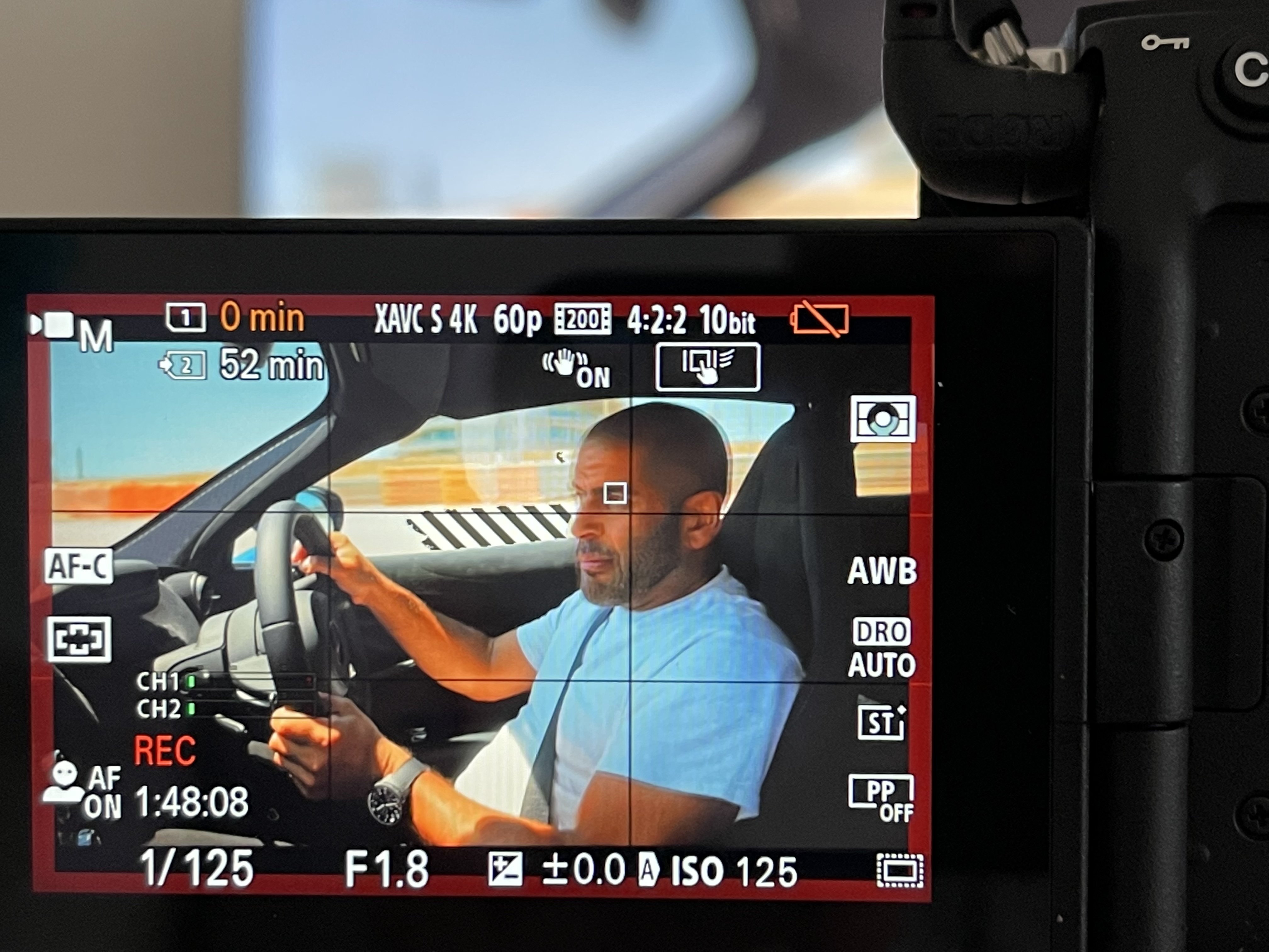

Trek of Joy Posted January 5, 2022 Share Posted January 5, 2022 Ran some more tests. Took a lot but I finally got mine to overheat. I filled a 128gb card shooting SI at 4k60p which was 27 minutes, no issues. Then I switched to 24p which filled another card in 1hr 8 min, no issues. Then I did a simultaneous recording, 4k60p XAVC S - so it recorded 1hr 20 min to both cards, no issues. So my conclusion is after 7 straight hours of recording - only stopping to swap batteries and delete those long ass takes - my camera has zero issues with the screen out. So then I put the screen into the body and did the simultaneous 4k60p recording again. It shut down after 27 minutes recording to both cards. I flipped the camera off and then right back on and hit record and got over 14 minutes more recording before it shut down - again recording to both cards. This was after all the previous recording and the camera was already pretty warm. I never shoot with the screen flat against the body. I'm 6'2" and never have the camera at eye level, so the screen is always flipped out so I can see it. Over 7 hours works for me, the a7IV is a keeper. A few more shots of the camera in action. Cheers Chris Mark Romero 2 1 Link to comment Share on other sites More sharing options...

kye Posted January 6, 2022 Share Posted January 6, 2022 15 hours ago, Trek of Joy said: Ran some more tests. Took a lot but I finally got mine to overheat. I filled a 128gb card shooting SI at 4k60p which was 27 minutes, no issues. Then I switched to 24p which filled another card in 1hr 8 min, no issues. Then I did a simultaneous recording, 4k60p XAVC S - so it recorded 1hr 20 min to both cards, no issues. So my conclusion is after 7 straight hours of recording - only stopping to swap batteries and delete those long ass takes - my camera has zero issues with the screen out. So then I put the screen into the body and did the simultaneous 4k60p recording again. It shut down after 27 minutes recording to both cards. I flipped the camera off and then right back on and hit record and got over 14 minutes more recording before it shut down - again recording to both cards. This was after all the previous recording and the camera was already pretty warm. I never shoot with the screen flat against the body. I'm 6'2" and never have the camera at eye level, so the screen is always flipped out so I can see it. Over 7 hours works for me, the a7IV is a keeper. A few more shots of the camera in action. Cheers Chris I'd suggest that maybe it suddenly overheated when someone said something wildly offensive, but I don't see any shots of Jeremy Clarkson, so maybe the theory doesn't hold..... 😆😆😆 Trek of Joy 1 Link to comment Share on other sites More sharing options...

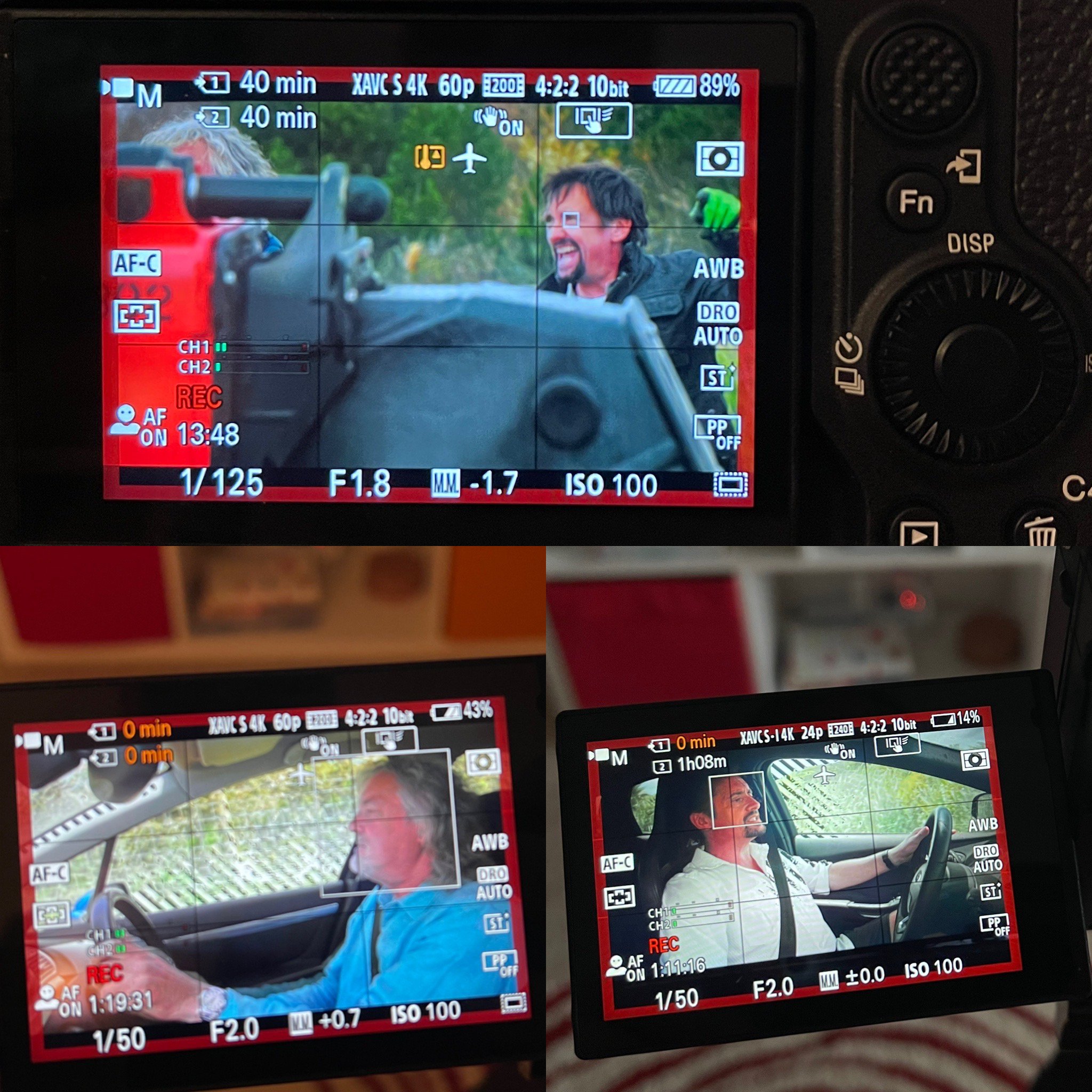

Trek of Joy Posted January 8, 2022 Share Posted January 8, 2022 a7IV overheating test pt. 2 Did another run test without airplane mode since someone asked the question on FB - had the LCD out and today I plugged a mic in just to try and create more heat. I ran the battery dead and shot 1hr and 50min of 10-bit 422 XAVC S 4k60p. The battery crapped out about 30 seconds after I took the pic. No temp warning and the camera was warm, but wasn't that hot, same for the battery. Below is what I've managed without an overheating shutdown - AF-c and the camera pointed at the TV to get faces/eyes, Steadyshot on, auto ISO that was changing with the different light on the TV, airplane mode, LCD out, temp set to high, prograde 128gb v90's: -- Over 7 hours of XAVC S 4k60p 10-bit 422 only stopping to swap batteries and delete the file after filling my 128gb card at 1hr 20min -- Multiple dual recording of XAVC SI at 60p and 24p until cards were full or the battery died -- Simultaneous dual recording of 10-bit 422 4k60p XAVC S until both cards were full -- 27min of dual recording with the LCD against the body and it shut down, then another 14 min after immediately restarting - these two runs were after doing all of the above all day yesterday, that's about 9 hours of non-stop recording with no issues, then the shut down Today's test was the same as above, just airplane off. I can't get mine to overheat unless the LCD is against the body, but I don't shoot that way and knowing it won't overheat with it out - I will not hesitate using this in a professional environment alongside my a7sIII. The a7IV is a winner for me. Chris Mark Romero 2 1 Link to comment Share on other sites More sharing options...

Trek of Joy Posted January 9, 2022 Share Posted January 9, 2022 45 minutes ago, Andrew Reid said: So what's the overall gist of it so far then - experiences are all so differently. One guy had it go 2 hours in 4K/60p and the other had it go 15 minutes in the menus! Is it far worse in USB power mode? Seems to be a few duds, there will be sample variance, even if everything is within spec. The only way I've been able to get mine to overheat is with the LCD against the body, but that was after recording all day without issue. But we know that's where the camera gets the hottest, its always been that way with Sony. Someone of FM said theirs overheated after just 2 min shooting 4k60p sitting on a desk in a cool Canadian basement shooting XAVC S 10-bit 422. I'm testing in 77 or 78f-ish temps, not exactly hot, but I'm easily surpassing Sony's claimed room temp record times. I used the same 422 bitrate option to fill card after card with no issues - even when recording to both cards simultaneously. *shrug* Chris Link to comment Share on other sites More sharing options...
