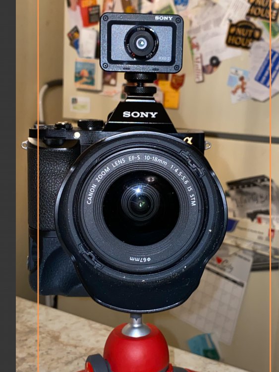

webrunner5 Posted January 1, 2022 Share Posted January 1, 2022 I use this rig a lot with my Sony AS7s. Kills two birds with one stone. Nice way for me to get 4K without a big recorder. When I am in s35 mode on the A7s with the lens zoomed in at max Both cameras match FOV about perfect. And close aperture wise. Emanuel 1 Link to comment Share on other sites More sharing options...
kye Posted January 1, 2022 Share Posted January 1, 2022 3 hours ago, webrunner5 said: I use this rig a lot with my Sony AS7s. Kills two birds with one stone. Nice way for me to get 4K without a big recorder. When I am in s35 mode on the A7s with the lens zoomed in at max Both cameras match FOV about perfect. And close aperture wise. What kinds of situations would you use this dual-camera setup? Link to comment Share on other sites More sharing options...
webrunner5 Posted January 1, 2022 Share Posted January 1, 2022 Well sort of the main thing is having atop the A7s adds to more stable shooting experiences. Also I don't have a 4K recorder for the A7s. So I can have the RX0 II fill that void. Now no way the two cameras match hardly at all. The RX0 is Crazy sharp both in photos and video. I have a Smartphone Gimbal but not suited well for the RXO. And as small as the RXO is it is just about impossible to handhold it and get anything that is useful. The tripod I have even though it is Carbon Fiber weighs a ton so not much into that, and the monopod I have, a good one at that, is still a fail using the RXO. I have a OG BMPCC and a Canon EOS-M also that I use for Magic Lantern. SO I have a pretty crazy mix of stuff that in hardly any way matches. I probably need to sell all of it and buy one great thing and be done lol. kye 1 Link to comment Share on other sites More sharing options...
