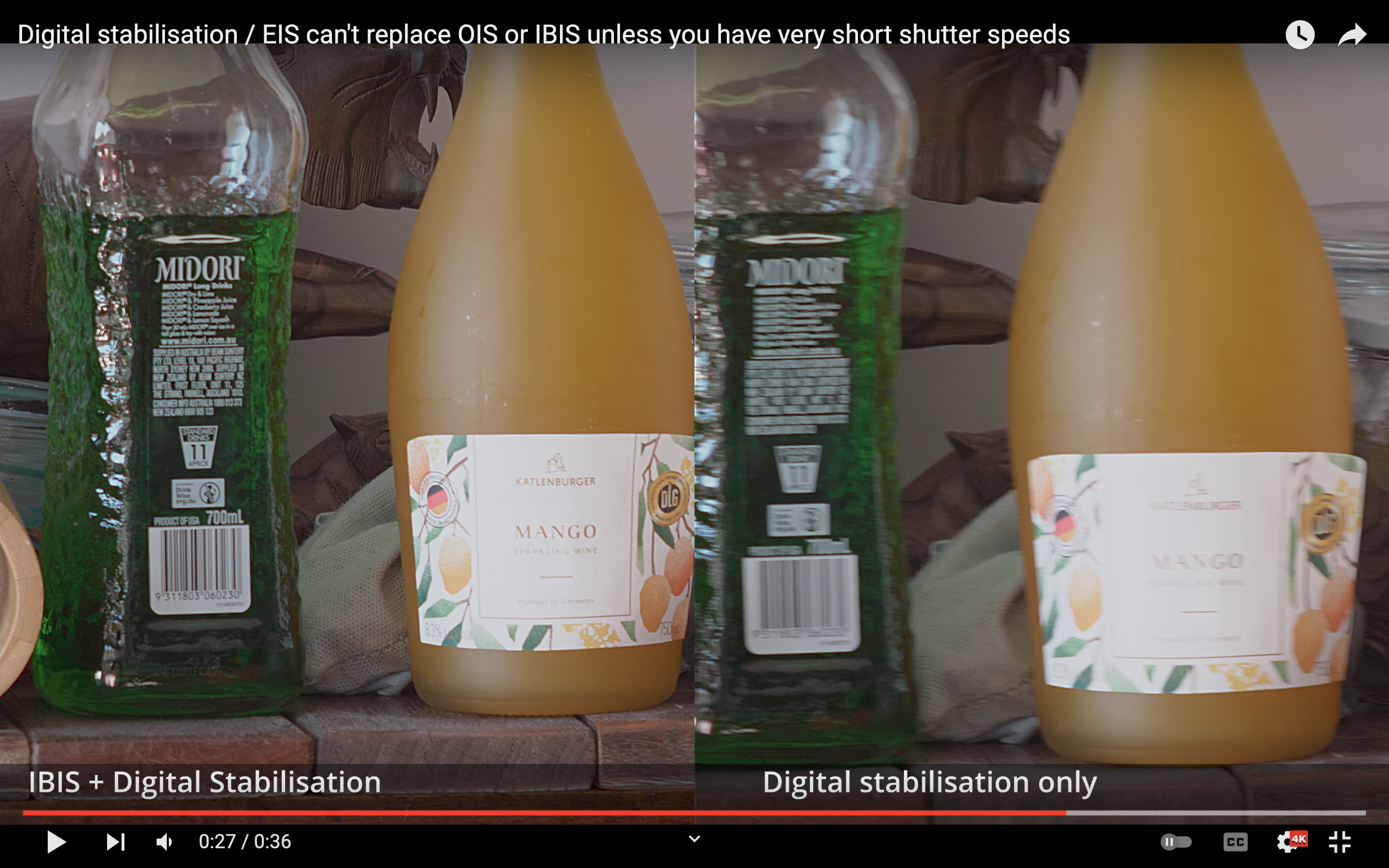

kye Posted January 22, 2022 Share Posted January 22, 2022 Well done everyone... you inspired me to shoot a little test to show why Digital Stabilisation can't replace OIS / IBIS. @Emanuel - this is the video that should end the debate. Digital stabilisation can be great, but only if there is very little motion and only if you have short shutter speeds. I'd encourage everyone to realise that Digital Stabilisation is just DIFFERENT to OIS or IBIS. It's a different tool for a different job. I often use digital stabilisation on my IBIS footage and it can work really well. Hopefully this clears things up? ntblowz 1 Link to comment Share on other sites More sharing options...
Emanuel Posted January 22, 2022 Share Posted January 22, 2022 Horses for courses, of course : ) Thanks for posting @kye I still keep my position though... That's shot on GH5, not a 2022 camera, with higher native resolution to play with along, etc. ; ) Not this Canon one in particular ;- ) Link to comment Share on other sites More sharing options...
kye Posted January 22, 2022 Share Posted January 22, 2022 17 minutes ago, Emanuel said: Horses for courses, of course : ) Thanks for posting @kye I still keep my position though... That's shot on GH5, not a 2022 camera, with higher native resolution to play with along, etc. ; ) Not this Canon one in particular ;- ) The digital stabilisation was done in Resolve, which has better digital stabilisation than ANY camera will EVER have, because Resolve can see into the future and cameras can't. IBIS / OIS stabilises DURING the exposure of each frame, digital stabilisation does not and therefore the frames will have motion blur. I don't understand how you could watch that comparison and still genuinely think that one can replace the other. I'm sorry if this is rude, but I just literally can't understand how you could see it and not understand it. The IBIS means that the frames are all sharp, the digital stabilisation has frames that are blurry as all hell. I shoot very unstable handheld footage all the time and stabilise digitally in post and this whole thing has been obvious to me from basically day one. Link to comment Share on other sites More sharing options...
kye Posted January 22, 2022 Share Posted January 22, 2022 IBIS = blur reduction, Digital Stabilisation only = no blur reduction Link to comment Share on other sites More sharing options...

shooter Posted January 22, 2022 Share Posted January 22, 2022 1 hour ago, kye said: The digital stabilisation was done in Resolve, which has better digital stabilisation than ANY camera will EVER have, because Resolve can see into the future and cameras can't. Emanuel is right. Are you comparing the digital digitalization in-camera of the new R5C with Resolve from footage of a different camera? This will lead to different results all around. filmmakereu and Emanuel 2 Link to comment Share on other sites More sharing options...

kye Posted January 22, 2022 Share Posted January 22, 2022 5 hours ago, shooter said: Emanuel is right. Are you comparing the digital digitalization in-camera of the new R5C with Resolve from footage of a different camera? This will lead to different results all around. You know, I'm really looking forward to someone talking about the shutter speed on the R5C. I mean, how does it work? I know that the numbers are similar to other cameras, but I don't want to make any comparisons that get different results. You've really opened my eyes about that, I mean when you take the exact same technology and take it from one device to another how can we really be sure that the fundamental principles will be the same? Does a shorter shutter speed give a darker image, like on every other camera ever made, or is it different, maybe it gives a lighter image? Maybe the colours start to go strange? Maybe people who are happy get brighter? How does the rotation of the earth factor in? I wouldn't want to make a comparison that will give different results all around. and what about ISO? Are higher numbers better? Does it go up and down? Maybe the even numbers are good? Once again, every other camera ever made works in the same way, but can we really compare? I mean, what do we know about anything anyway? None of us has ever used an R5C. Maybe the images are from another camera and it's a hoax? How can we know it really exists? How can we know anything? Are you real? Am I even real? cameraeye and projectwoofer 2 Link to comment Share on other sites More sharing options...
