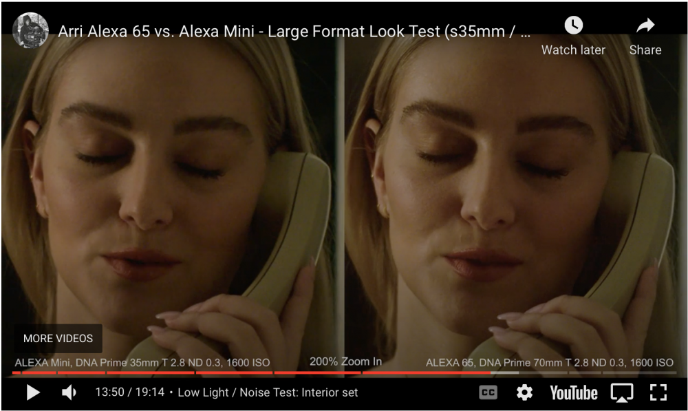

kye Posted January 26, 2022 Share Posted January 26, 2022 On 1/25/2022 at 8:18 AM, Andrew Reid said: There is no "might" about it my friend, it is all to do with the lens and how much the sensor will see of the image projected by it. No, it won't change anything to do with focus or focus "roll off". The gap is microscopic even on a front-side illuminated sensor and focus is a property of the lens combined with how much you can see of the image it projects into the camera body. The gap between pixels on the sensor can only influence the quality of the signal going into that pixel, in terms of things like noise and dynamic range. Panasonic is pretty good. When I brought out Pro Color for Sony, I did one for Panasonic. The Sony version sold at a ratio of something like 50:1 more, even though EOSHD at that time had a roughly equal amount of Panasonic and Sony users reading it. The demand wasn't there for the Panasonic cameras. And sensor size has not much to do with colour science at all really, as long as your sensor is rammed with pixels and has a noisy image. BM Pocket Cinema Camera original with the small 1080p Super 16mm sensor was able to do very good colour, but that has more to do with having a very good codec, high data rates and a sensor that performs well below ISO 800. Of course BM colour science itself is well setup, well tuned out of the box, good skintones - but so is Panasonic's. The idea about assessing the aesthetics of sensor size is NOT to make everything equal. It's very simple to put the same lens on 3 different sensor size cameras isn't it? Yeah this is what happens in Mattias Burling's blind-tests a lot, they are fun but really pretty much down to chance which shot has some appealing aspect that connects it to the viewer. Sometimes a camera will win because of an extra ray of sunlight rather than something to do with technical abilities. It's been proven a while back by Zacuto's Shootout too, with the GH2 able to go toe to toe with RED and ARRI just by lighting the set well enough. Look at Kai Wong for another example. Thing is, to be a good photographer you don't need to understand the inside workings of a camera, but you do need to be a good photographer. I'm more bothered about the latter, and the fact our culture seems to be holding mediocrity aloft as some sort of authority on creativity, just because it appears to be on level with the public and shouting in a loud obnoxious voice to thousands of subscribers. I'm not questioning if there is a look, I'm trying to work out what technical aspect might be causing it. Anything you can understand you can work with, and potentially accentuate or minimise for creative effect. One of the main challenges with trying to compare sensor sizes is that you can't change single variables - every change effects so many variables simultaneously that it's almost impossible to do any kind of aesthetic tests. What I mean is that you can get two cameras with different sensor sizes and two lenses and set them up to have an identical FOV and POV. If you organise your test well you can also perfectly match one or two other variables at the same time, but you'll have probably 5+ other variables all different. I think that's why there are a lot of very well done technical comparisons that only focus on one or two variables (for example Steve Yedlins excellent comparison of Lens Blur on different formats) but only very subjective comparisons of the overall 'look' between formats. I've read a lot of these accounts of subjective comparisons and tried to discern what technical aspects might be behind them, and I'm yet to actually find anything in-particular that is fundamentally different, but there are still many factors I haven't ruled out, and I've definitely learned a lot of stuff along the way. One thing that I thought was especially interesting was the effect that background defocus had on 3D 'pop'. In my lens tests I have consistently found that even a small difference in background defocus (ie, shallower DoF) had a large impact on depth. One test I did involved comparing lenses all at the same aperture and looking with one eye through a roll of cardboard so that I couldn't see the edges of the image, and comparing how much depth I perceived from the image. The interesting thing was that there was a surprisingly strong perceived difference in my test between a 55mm lens and a 58mm lens at the same aperture. Obviously the 58mm lens had slightly shallower DoF, but it was so slight that I had to actually measure the bokeh balls in the background to confirm it was different, but subjectively it made a much bigger difference than you'd imagine. My current thoughts on it is that it's likely to be a combination of a range of factors that accumulate to form the aesthetic impression. Of course, I still have much more to learn about it so this isn't a conclusion but rather more of a working theory. I do find that it's actually been a very good question to ponder, as it has lead me down quite a number of paths of enquiry that have taught me a lot about the technical aspects of a digital imaging system as well as the aesthetic implications of various technical aspects of such. Like all things, the value is in the questioning... Interesting about the Panasonic vs Sony EOSHD Pro Colour sales, but not entirely surprising. Sony used to have terrible colour! My impression of Panasonic colour is that it was ok with the GH5 but has gotten nicer with subsequent releases. If the GH6 has Panasonic S1H level colours then that would be a huge draw-card for me in upgrading I think. There's a rumour that something will happen in their live-stream this week, so I guess we'll see about that 🙂 22 hours ago, MrSMW said: I like crazy Kai as well...and a lot of others. I quite like Kai but with a few caveats. Firstly, he doesn't make the mistake of stepping out of his expertise (or doesn't do it like others anyway). He doesn't pretend to know the tech, doesn't try and explain it, and doesn't pretend that his testing is anything other than waving a camera around in a relatively hap-hazard way. I've delved into the world of professional DPs and seen their camera tests (which are very difficult to find BTW as they're normally on Vimeo with cryptic titles) which typically only test one variable at a time and aren't meant in any way to be a review, just exploration of the tech. There is also a world of semi-professional DPs who do commercial work but also do YT and non-DP revenue streams (like Tom Antos, Matteo Bertoli, Humcrush Productions, etc) but even these guys often have elements of their testing processes that aren't controlled for. Of course they're not normally claiming that a test is pristine and not claiming to know the tech or try and explain it, but sometimes I'll watch a test and think "I wish they'd manually WB the cameras beforehand rather than just set the colour temperature" or similar things like that. This leaves the poor YouTubers with basically no hope. They don't actually shoot things professionally like the "hybrid" DPs so they can't talk about the concerns or working methods of real sets, and they also don't have the discipline that sets often involve like a DP requesting a particular T-stop and lighting ratio and doing things by the numbers. They also don't have the technical discipline to review things because they are in the business of producing, hosting, filming, editing, and selling advertising on a show, rather than in the tech itself. Some of these people understand that and keep within the lines, and others just don't, and make fools out of themselves in the process. Of course, the sad thing is how many people don't know enough to know the difference, which is why these people can have lots of followers and yet fumble most of their content. 9 hours ago, Django said: Probably why the "magic" or mojo goes away when shooting crop sensors. What are your thoughts on the OG BMPCC and BMMCC in this regard? I thought they were well known for their magic / mojo. If so, they are an interesting example because they're doing it despite their sensor size rather than because of it. They do raise an interesting element though, which @Andrew Reid touched on earlier when talking about how much of the lens image circle falls onto the sensor. Despite the BMPCC / BMMCC having smaller sensors they are often used with c-mount lenses that were designed for this sensor size, or potentially even smaller, and thus they are looking at almost all of the image circle from many lenses they are used with. I must admit that I find them less magical when used with glass designed for larger sensors like MFT or FF. Link to comment Share on other sites More sharing options...

Emanuel Posted January 26, 2022 Share Posted January 26, 2022 6 hours ago, kye said: I quite like Kai but with a few caveats. Firstly, he doesn't make the mistake of stepping out of his expertise (or doesn't do it like others anyway). He doesn't pretend to know the tech, doesn't try and explain it, and doesn't pretend that his testing is anything other than waving a camera around in a relatively hap-hazard way. I've delved into the world of professional DPs and seen their camera tests (which are very difficult to find BTW as they're normally on Vimeo with cryptic titles) which typically only test one variable at a time and aren't meant in any way to be a review, just exploration of the tech. There is also a world of semi-professional DPs who do commercial work but also do YT and non-DP revenue streams (like Tom Antos, Matteo Bertoli, Humcrush Productions, etc) but even these guys often have elements of their testing processes that aren't controlled for. Of course they're not normally claiming that a test is pristine and not claiming to know the tech or try and explain it, but sometimes I'll watch a test and think "I wish they'd manually WB the cameras beforehand rather than just set the colour temperature" or similar things like that. This leaves the poor YouTubers with basically no hope. They don't actually shoot things professionally like the "hybrid" DPs so they can't talk about the concerns or working methods of real sets, and they also don't have the discipline that sets often involve like a DP requesting a particular T-stop and lighting ratio and doing things by the numbers. They also don't have the technical discipline to review things because they are in the business of producing, hosting, filming, editing, and selling advertising on a show, rather than in the tech itself. Some of these people understand that and keep within the lines, and others just don't, and make fools out of themselves in the process. Of course, the sad thing is how many people don't know enough to know the difference, which is why these people can have lots of followers and yet fumble most of their content. Nice thoughts : ) The most funny is not every DoP (less than before but still today come from film realm) are more expert on these modern digital cameras than a few digitally oriented since the beginning we could call just enthusiastic ; ) I've found many really good and with only their late 20s, 30s, which means they practically were born or yet children when the transition occurred if we can tell it like that :- ) There's a difference between a real DoP with a YT channel and those who are actually reviewers, that is, press, whether mere shills or more than that. Link to comment Share on other sites More sharing options...
