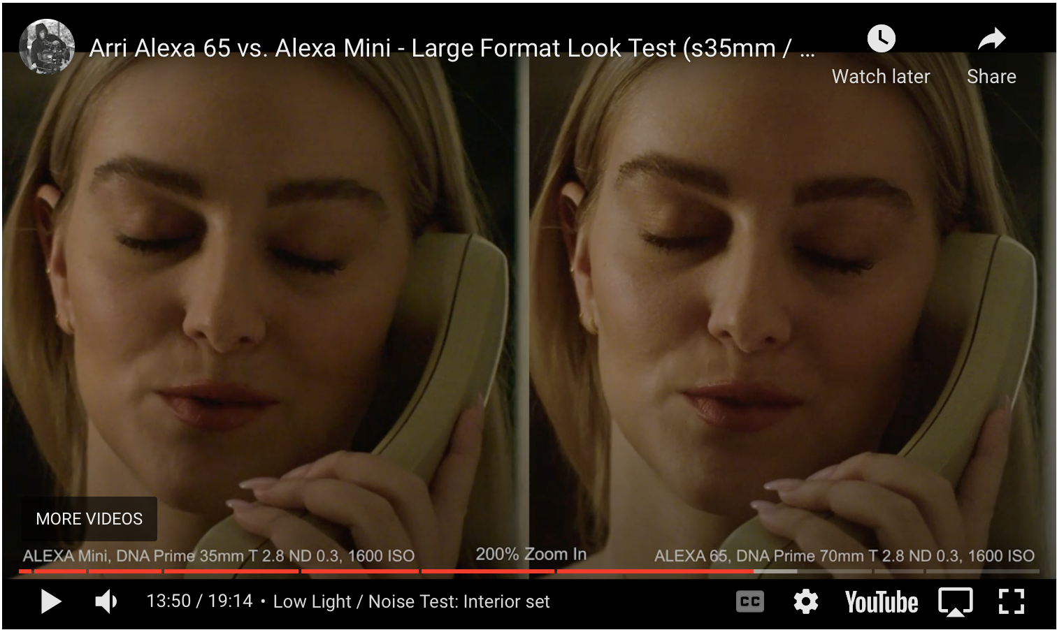

PannySVHS Posted January 28, 2022 Share Posted January 28, 2022 The Angie above might be a 16mm lens though.:) I think I tried one a few months ago from a 16mm Beaulieu camera. I kept an Angie 75 which covers Mft and almost S35. It gives me a very exiting look on Mft. There is an awesome comparison of Arri Alexa cameras with their sensor - lens couplings and the resulting looks, done by a DOP with a great hand for such a test setup. I surely recognize that this test is not about same DOF but about look of sensor and lens pairings providing equal POVs. It always gives me clicks and gotchya moments. Enjoy and draw your conclusions. Edit: there is a DOF equivalent part of the test. So even more to enjoy. Â https://manuelluebbers.com/large-format-look-alexa-65-vs-alexa-mini/ Â Â Link to comment Share on other sites More sharing options...

kye Posted January 28, 2022 Share Posted January 28, 2022 8 hours ago, PannySVHS said: The Angie above might be a 16mm lens though.:) I think I tried one a few months ago from a 16mm Beaulieu camera. I kept an Angie 75 which covers Mft and almost S35. It gives me a very exiting look on Mft. There is an awesome comparison of Arri Alexa cameras with their sensor - lens couplings and the resulting looks, done by a DOP with a great hand for such a test setup. I surely recognize that this test is not about same DOF but about look of sensor and lens pairings providing equal POVs. It always gives me clicks and gotchya moments. Enjoy and draw your conclusions. Edit: there is a DOF equivalent part of the test. So even more to enjoy. Â https://manuelluebbers.com/large-format-look-alexa-65-vs-alexa-mini/ Â Â That's a fascinating video, but probably for all the wrong reasons. I spent over a dozen hours when it was released with a range of shots from it, adjusting them in post to be a more equal match. Â By the time you take the Alexa Mini shots and adjust the vignette, barrel distortion, contrast, colour, diffusion, sharpening, and cropping to make the frames much more comparable, the differences are greatly diminished between the s35 and LF sensors. I HIGHLY HIGHLY HIGHLY recommend that everyone downloads the video, pulls it into Resolve and tries to adjust the images to be more similar. Â I learned an incredible amount about imaging from this exercise. Â It really gave me an appreciation for how much better the colour science is on the 65 than the Mini - despite the Mini being spectacular in its own right to begin with. Â ARRI truly did an incredible job in its development. It's a difficult thing to match them as the vignetting is very non-linear and so all I could do was approximate it. Â I went the full-way and spent hours adjusting one image while it was on top of the other with a "difference" blending mode so I was only seeing the mathematical difference between the images, trying to line up everything perfectly to minimise the errors. Â I performed individual colour grades on different parts of the image in this mode, eliminating tints and shifts in the colour science, etc etc. Â Most of the adjustments were non-linear in this sense. Unfortunately I couldn't get them to match closely enough to "see through" the various optical differences and answer the question if there was a difference between the sensors. It's a great test to demonstrate the difference between the two cameras, but a terrible test to show the effects of only the sensor size. Â As great as an Alexa Mini is, the 65 is a far superior image, so in a way it's like comparing a GH1 kit-lens combo with a Sony Venice Masterprime combo and saying the difference is due to the sensor sizes. PannySVHS and Juank 2 Link to comment Share on other sites More sharing options...
PannySVHS Posted January 28, 2022 Share Posted January 28, 2022 @kye The video does show the differences of sensor sizes on various levels, fi further in the video at 13min 50sec it shows how much much cleaner the footage with the 65 is. Like you said, a great or must watch for image lovers. Thread closed 😊 Link to comment Share on other sites More sharing options...

kye Posted January 29, 2022 Share Posted January 29, 2022 @Django @PannySVHS I really truly would encourage you to compare the footage yourself. There are SO MANY tiny differences between them, and they're often too subtle to see unless you're flipping between them in an NLE.  However, once you equalise them, or get close even, you'd be amazed at how much the gap closes. 9 hours ago, PannySVHS said: @kye The video does show the differences of sensor sizes on various levels, fi further in the video at 13min 50sec it shows how much much cleaner the footage with the 65 is. Like you said, a great or must watch for image lovers. Thread closed 😊 Some differences aren't that subtle though.  Like you said - let's look at 13:50. The 65 is quite obviously brighter.  Guess what.  Making an image brighter makes it nicer!  A common trick in colour grading is to track a window over the main subject in a shot and add a bit of contrast and raise the brightness.  Even a subtle touch of this changes the entire composition of an image, it's such a powerful effect.  Here, you get it for free from the camera/lens/grade. There are a dozen other things different between the shots, mostly too subtle to see, but they add up.  Doing the comparisons yourself is a masterclass in aesthetics, and why this isn't a good comparison for sensor size. Link to comment Share on other sites More sharing options...

Django Posted January 29, 2022 Share Posted January 29, 2022 @kye sorry but can't say I agree, frankly I don't see how anyone could make a better sensor size comparison? sounds to me like you're focusing too much on the exposure, color science etc in your grading experiments to match both cameras. that wasn't at all the point of the test and the differences in exposure and color are due mostly to the 3D rig that means one camera is shooting through a mirror which makes you lose a stop of light and color shifts as the DP states himself: "Thanks! The color shifts are due to the mirror of the 3D rig which unfortunately makes it impossible to compare color. Also, the different ND Filters and lenses are influencing the image. If you would shoot without this specific 3D-Rig setup, the colors would match because both cameras are based on the same color science." So while I'm sure you've learned a lot by attempting to match both cameras CS in post, that isn't what the test is about. The first shot say a lot. Using a same 40mm lens on both sensors displays massive angle of view difference. Second & last shots with angle of view matched by lens equivalency shows the huge differences in between a 35mm & 70mm (compression, DoF, bokeh) but also center crop vs full circle (vignetting, edge blur). Those DNA primes are made for the 65 and have so much mojo: "The DNA LF lenses have an individuality, when most lenses these days are going for uniformity and technical perfection. They remind me of older anamorphic lenses, in terms of the very subtle vignetting and focus drop off." While these lenses, created for the Alexa 65 could already be used on the Alexa LF, the obvious problem is this: on the Alexa LF you would only be using the very sharp center portion of the lenses for the larger format Alexa 65, thus loosing a lot of the characteristics that make the DNA lenses special. This is exactly what I've been saying all along when adapting FF lenses to crop sensors. That said there are certain instances where you may not want vignetting, focus drop off, or even shallow DoF (without stopping down. Nice thing about FF is that most cams today allow you to crop to a S35. This is always a better solution than the reverse speed-boosting which brings in other optical issues. The low light tests show the much noisier image of the smaller sensor. The 200% zoom-in shots the difference in resolution. In the end, it's a very thorough and revealing test that showcases just about everything to consider about sensor sizes and their correlation to lens pairings on an aesthetic & technical level. Link to comment Share on other sites More sharing options...
kye Posted January 30, 2022 Share Posted January 30, 2022 @Django @PannySVHS You guys are hilarious. I wonder if you can tell me what the colour science of the next canon camera will be like?  I mean, I know you haven't seen it, but you also haven't seen the Mini adjusted in post to match the 65, and you're confidently speaking about that! Maybe you can compare the GH6 to the next Canon camera? If I promise to take a video of the lottery numbers next week, can you tell me what that video contains? That'd be great, thanks!  webrunner5 1 Link to comment Share on other sites More sharing options...
