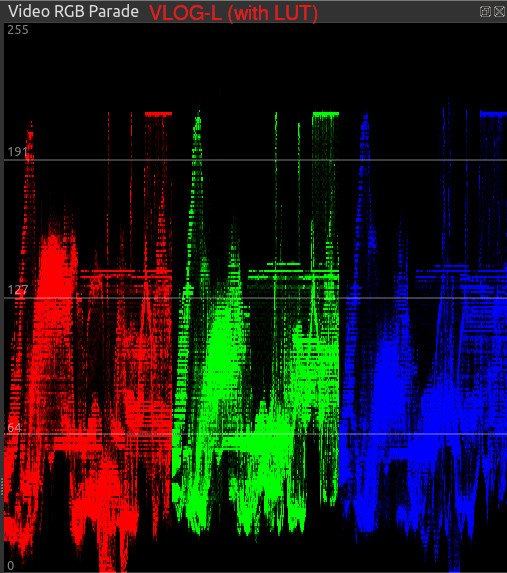

TrueIndigo Posted March 2, 2022 Share Posted March 2, 2022 Here is the image with just simple colour correction (colour wheels) to improve the image and then applying the LUT (ie. the filters used in that order), along with the resulting RGB parade. mercer and webrunner5 2 Link to comment Share on other sites More sharing options...
