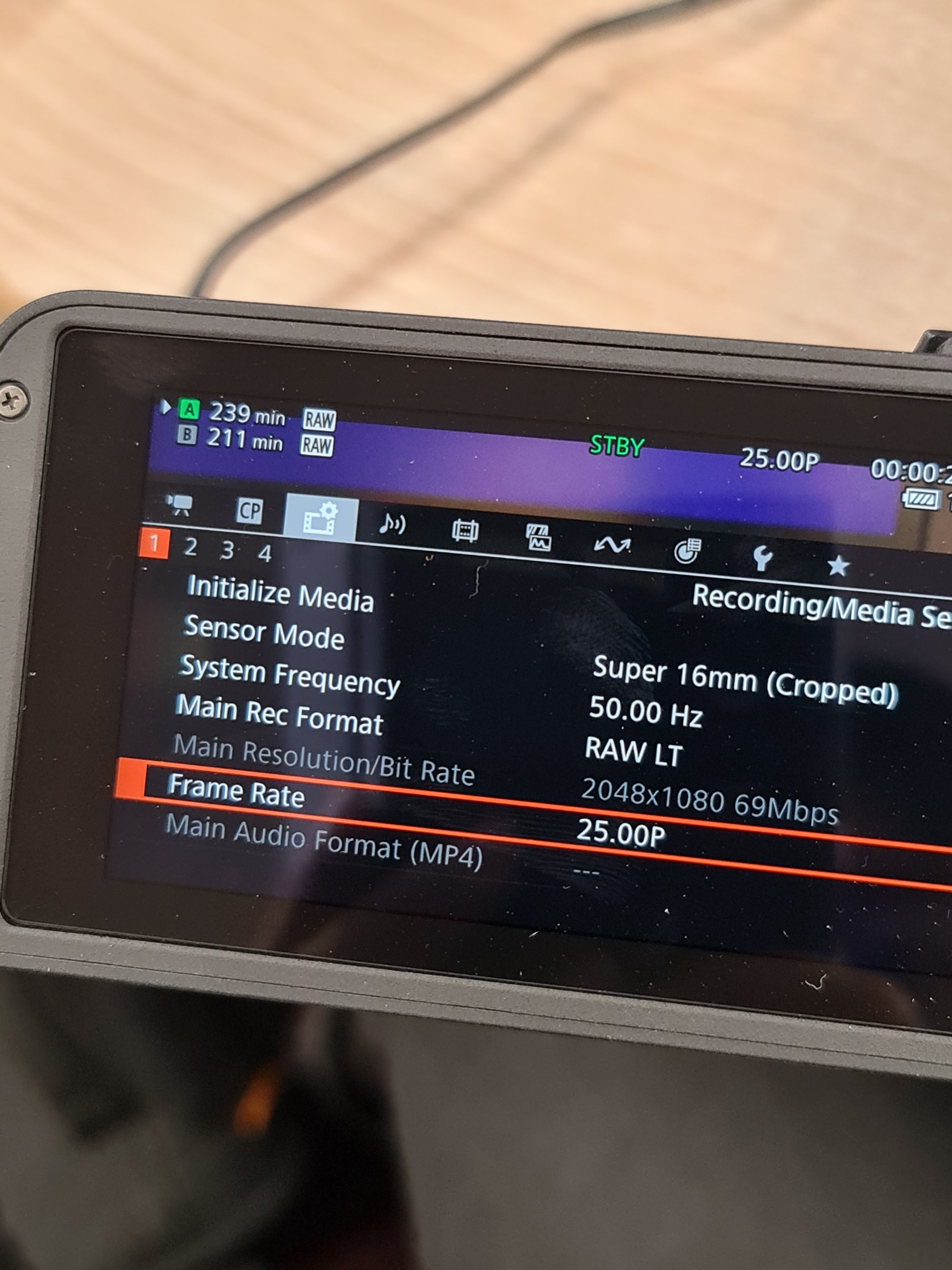

herein2020 Posted March 25, 2022 Author Share Posted March 25, 2022 I tested out the new C70 firmware today and shot in Cinema RAW LT at 30FPS. On a whim, I directed the RAW footage to record to my V30 card and it actually recorded fine. I just shot a few seconds of footage to test out playback on my editing system and to see if my SD cards could handle it. I definitely think my 1TB SandDisk Extreme Pro cards are rock solid, it was almost comical seeing 411 min of recording time available when recording to the 1TB card in RAW LT. When I tested RAW LT at 60FPS though it buffer overflowed immediately. So my storage concerns were definitely unwarranted; this camera, despite its faults is really turning into a rock solid workhorse for me. Below is a quick table that I put together to show the codecs that I care about and their recording times. SanDisk Extreme Pro 1TB V30 Canon RAW LT -> 29.97FPS -> Recording Time 422min Canon XF-AVC Long GOP -> 29.97FPS -> Recording Time 852min Canon XF-AVC Long GOP -> 59.97FPS -> Recording Time 524min ProGrade 256GB V90 Canon RAW ST -> 29.97FPS -> 68min Canon RAW LT -> 29.97FPS -> Recording Time 105min Canon RAW LT -> 59.97FPS -> Recording Time 52min Canon XF-AVC Long GOP -> 29.97FPS -> Recording Time 213min Canon XF-AVC Long GOP -> 59.97FPS -> Recording Time 131min Also, the Canon RAW LT at 29.97FPS seems to have a bitrate of 322Mb/s which is a data rate of 40MB/s, which is only half the 80MB/s that my SanDisk V30 card registered during its tests so I should be pretty safe with it. I will definitely keep the ProGrade cards in my bag, but it looks like for 90% of my work I am fine with keeping two 1TB SanDisk Pro cards in the camera with it set to dual slot recording. If I shoot a project that requires raw footage I will probably just use two ProGrade cards, not worth the headache of trying to remember which footage gets recorded to where depending on framerate. webrunner5 and ntblowz 2 Quote Link to comment Share on other sites More sharing options...
ntblowz Posted March 25, 2022 Share Posted March 25, 2022 C70's raw file size is much more manageable than c200/c300's 1gbps monster and that's only 10bit in 4k50/60p vs 12bit on c70. The 2k raw is even usable in wedding too lol (for ceremony, not sure about reception cause of lowlight on s16 crop). This raw update really makes c70 attractive! No need bulky external monitor + battery if you want compact raw cinema camera. herein2020 and webrunner5 2 Quote Link to comment Share on other sites More sharing options...

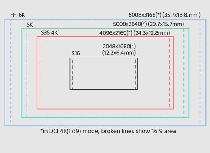

herein2020 Posted March 26, 2022 Author Share Posted March 26, 2022 7 hours ago, ntblowz said: C70's raw file size is much more manageable than c200/c300's 1gbps monster and that's only 10bit in 4k50/60p vs 12bit on c70. The 2k raw is even usable in wedding too lol (for ceremony, not sure about reception cause of lowlight on s16 crop). This raw update really makes c70 attractive! No need bulky external monitor + battery if you want compact raw cinema camera. That is a good point, I haven't looked at the cropped modes at all except when testing crop sensor lenses. BTW in cropped mode APS-C lenses work fine so that opens up many more options for cheap lenses when combined with the straight through adapter or speedbooster. I don't think cropped mode would affect its lowlight capabilities; sure, it is using less of the sensor, but it is also producing a lower resolution image so the pixel density is the same. I think the bigger question would be if the cropped FOV would be wide enough to still be useable. Cropped mode with RAW LT combined with my APS-C Sigma 18-35 F1.8 and the speedbooster dropping that to F1.4 could be an interesting combination for shooting RAW in lowlight for something like a wedding reception. Quote Link to comment Share on other sites More sharing options...
TomTheDP Posted March 26, 2022 Share Posted March 26, 2022 13 hours ago, herein2020 said: That is a good point, I haven't looked at the cropped modes at all except when testing crop sensor lenses. BTW in cropped mode APS-C lenses work fine so that opens up many more options for cheap lenses when combined with the straight through adapter or speedbooster. I don't think cropped mode would affect its lowlight capabilities; sure, it is using less of the sensor, but it is also producing a lower resolution image so the pixel density is the same. I think the bigger question would be if the cropped FOV would be wide enough to still be useable. Cropped mode with RAW LT combined with my APS-C Sigma 18-35 F1.8 and the speedbooster dropping that to F1.4 could be an interesting combination for shooting RAW in lowlight for something like a wedding reception. It definitely will IMO. Full frame vs S35 on say the Panasonic S1 is dramatically different if you are struggling for light. You are essentially blowing up the noise. If you expose correctly its no issue of course. Quote Link to comment Share on other sites More sharing options...

herein2020 Posted March 27, 2022 Author Share Posted March 27, 2022 On 3/26/2022 at 11:46 AM, TomTheDP said: It definitely will IMO. Full frame vs S35 on say the Panasonic S1 is dramatically different if you are struggling for light. You are essentially blowing up the noise. If you expose correctly its no issue of course. I guess I just don't understand why that would be. If you are using the same number of photosites on the sensor for a given resolution how could there be more noise since you are not increasing the gain when cropping in? It would make more sense to me if say the native ISO increased when switching to the S16 mode, but without an increase in gain how is there an increase in noise? Maybe the S1 line skips when in cropped mode or some maybe some kind of upscaling is occurring which decreases the image quality or maybe its circuits are just more noisy when handling the crop mode. But with the C70 in cropped mode and RAW there is no line skipping or upscaling, it is just using a smaller region of the sensor and the native ISO does not change. It would be very interesting to see someone perform a noise test for the C70 in the cropped vs S35 mode. 15 hours ago, kye said: Most compressed codecs will have a lower bitrate when there isn't huge amounts of movement. I'd suggest a stress test to max out the codec. One I have done before is to get half-a-dozen stills and put them on a 60p timeline at a single frame each, the point the camera at your monitor so that the whole frame is moving, and turn all the lights out, then set the computer to loop on that timeline, and hit record on a 24/25/30p mode. This ensures that no two frames will be remotely similar and it should stress the codec and push the camera to record the maximum bitrate for that codec. I've seen increases in bitrate by even 50% when doing this, compared to other test footage. I've tried pointing the camera at trees moving in the wind and this laptop test stresses the codec more, and is available even if it isn't windy and if you don't have any trees nearby 🙂 That is true, I do need to do more testing, my favorite test is a waterfall where nearly every pixel changes from one frame to the next. I don't have the patience to do the whole computer monitor stills thing 🙂 I am not a very good tester in general, I'd much rather be out shooting than testing. I work through the basics then get out there and shoot. 14 hours ago, BenEricson said: I think the main issue with these Canon cameras is still the post work flow. There is still no Cinema Gamut to REC.709 LUT. The conversion LUT from Log2 to Wide DR doesn't even match the baked in Wide DR profile. (I've tried. They don't match.) The Komodo for example, looks MUCH better right out of the gate with the standard RED provided LUT applied. There are 4 different LUTs with 4 different roll off curves for you to choose. You can preview whatever contrast level you want in camera, then apply the correct LUT in your NLE. It looks exactly like it does in camera. The LT raw footage played back pretty well for me. The other codecs work smoother though. I'm on an older Mac Pro. I don't really notice a difference in the footage though. For the work that I do, what comes out of the C70 is good enough for me. I agree though, the back screen always looks perfect and I have yet to find a LUT that can reproduce that look in post. There is a great YT video that I posted earlier in the thread where he went through many of the available LUTs and showed the results. I ended up going with the Buttery LUT for my Rec709 workflow, it looks the most natural to me and gets me the closest to where I want to be. BenEricson and webrunner5 2 Quote Link to comment Share on other sites More sharing options...

kye Posted March 28, 2022 Share Posted March 28, 2022 10 hours ago, herein2020 said: I guess I just don't understand why that would be. If you are using the same number of photosites on the sensor for a given resolution how could there be more noise since you are not increasing the gain when cropping in? It would make more sense to me if say the native ISO increased when switching to the S16 mode, but without an increase in gain how is there an increase in noise? Maybe the S1 line skips when in cropped mode or some maybe some kind of upscaling is occurring which decreases the image quality or maybe its circuits are just more noisy when handling the crop mode. But with the C70 in cropped mode and RAW there is no line skipping or upscaling, it is just using a smaller region of the sensor and the native ISO does not change. It would be very interesting to see someone perform a noise test for the C70 in the cropped vs S35 mode. Cameras that downsample will benefit from that as the downsampling reduces the noise, compared to punching-in to a 1:1 readout. If you're shooting RAW then there wouldn't be so much of an advantage, except that the grain of the noise will be finer at higher resolutions. A pixel from S16 2048x1080 will be 2.93x the size of a 6K 6008x3168 pixel when you stretch both of the clips to the full timeline resolution. Quote Link to comment Share on other sites More sharing options...
