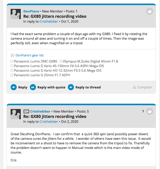

Super Members BTM_Pix Posted March 5, 2022 Super Members Share Posted March 5, 2022 I remember a similar thing came up a couple of years ago and a fix that apparently worked was to rotate it a couple of times around its axis. It might be worth a go. sanveer and projectwoofer 2 Link to comment Share on other sites More sharing options...
projectwoofer Posted March 5, 2022 Author Share Posted March 5, 2022 47 minutes ago, BTM_Pix said: I remember a similar thing came up a couple of years ago and a fix that apparently worked was to rotate it a couple of times around its axis. It might be worth a go. Hey, thanks for that. I tried the fix and it seems to work until I turn off the camera and turn it on again after a while. Then it’s jittery land all over again…crazy. Link to comment Share on other sites More sharing options...

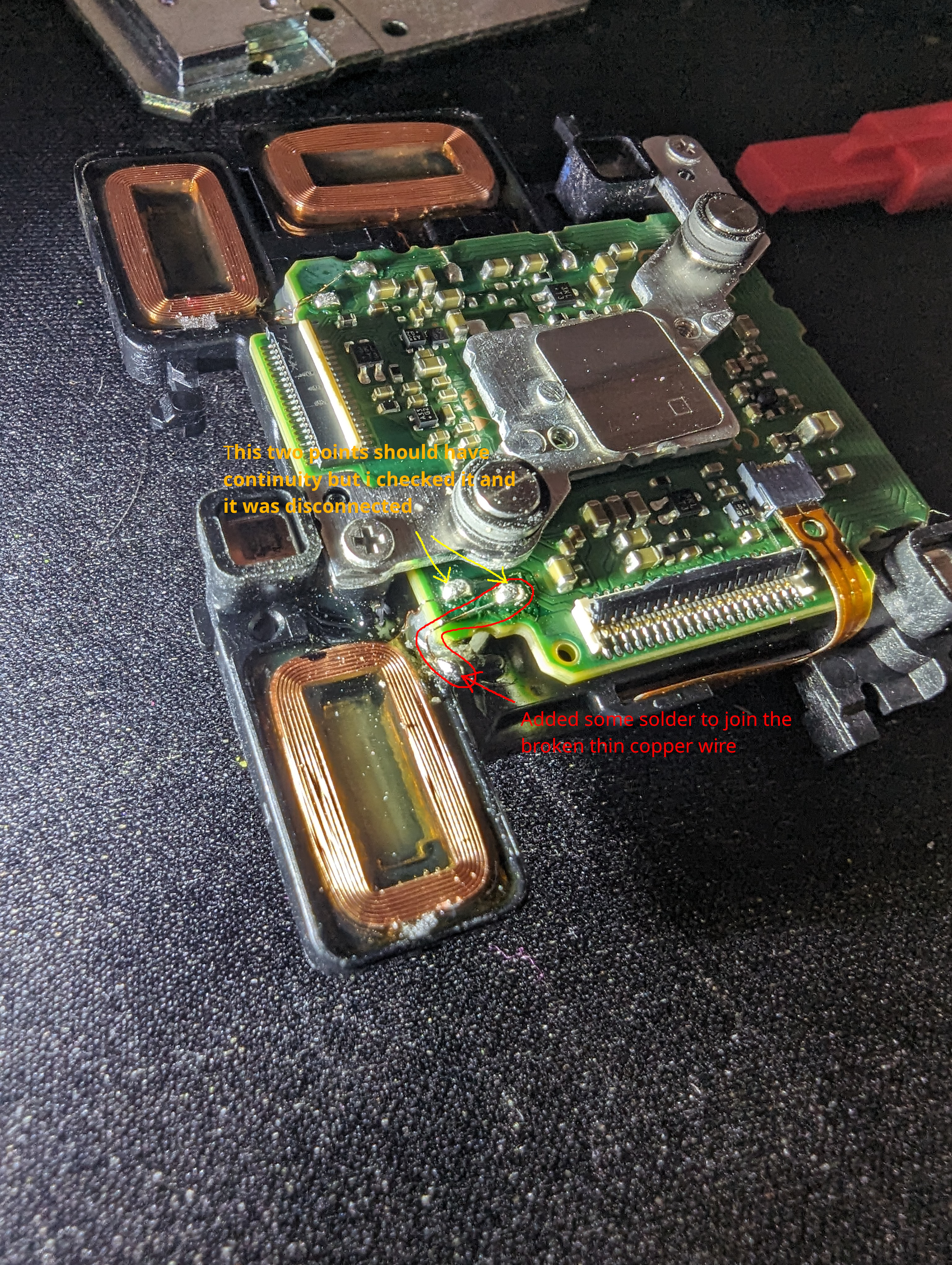

damarbo Posted April 18, 2024 Share Posted April 18, 2024 I had a faulty GX80 showing me a message a few seconds after power on: "Please Turn Camera Off and Then On Again". I knew it was the ibis failing because only one part of the sensor was static and the other part was very wobbly. So I dismantled my camera following this tutorial until I reached the 10th step. Once I had the ibis+sensor out of the camera, I only had to remove 3 screws and to separate the 2 flex of the sensor. Then, I realized one of the tree electromagnets had no continuity, and added some drop of tin to join the broken copper wire. And it's fixed and working again. I am so happy! I include an image of the point that was failing sanveer, ac6000cw, PannySVHS and 1 other 2 2 Link to comment Share on other sites More sharing options...
