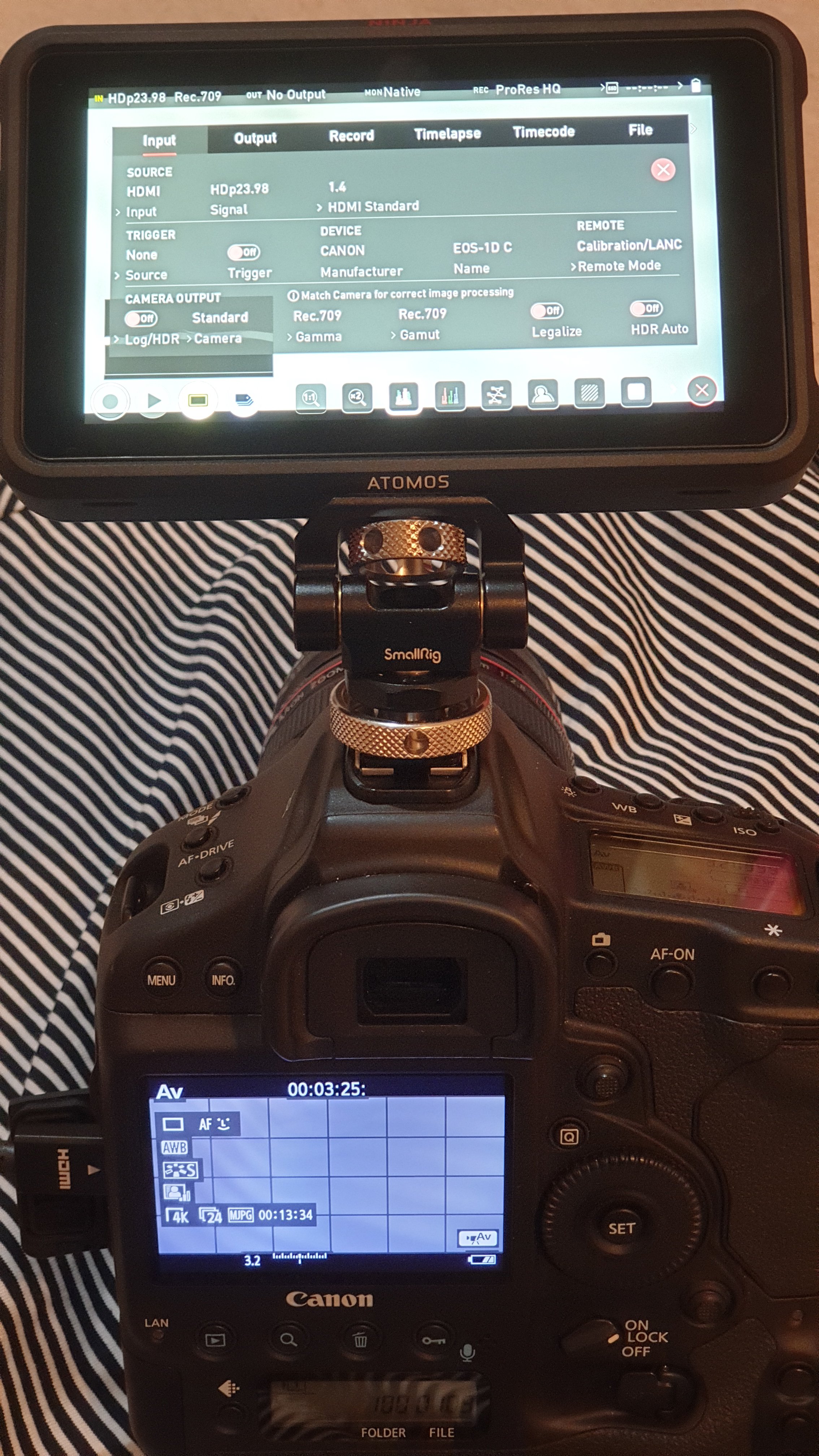

Simon2022 Posted March 6, 2022 Share Posted March 6, 2022 Hi, new to the forum. I recently picked up a Canon 1DC and today a Ninja V. The Ninja V just says 'no input' when I connect the 1DC. I've connected the 1DC to a TV with the same cable and the picture appears on screen. I've also plugged my XT3 into the Ninja V and it works fine. Any idea what the issue is with the 1 DC? I've tried all combinations of settings, eg mirroring on/off, auto frame rate etc. Is there something I've overlooked? thanks Simon Link to comment Share on other sites More sharing options...

Simon2022 Posted March 10, 2022 Author Share Posted March 10, 2022 Hi, Thanks for the replies, I now have it working. Initially on the 'input tab' on the Ninja it is set to a default of "Compatibility" which I expected the Ninja to auto detect the output however it appears not. When quickly toggling between the modes nothing was happening however it now seems it needs 5 seconds or more to go live with the signal after being selected. When I leave the input to "HDMI 1.4" it now works as expected. My main fear was that there was a hardware issue with the camera itself. See photo below of the settings. hope this helps Simon Ty Harper, leslie and webrunner5 3 Link to comment Share on other sites More sharing options...
