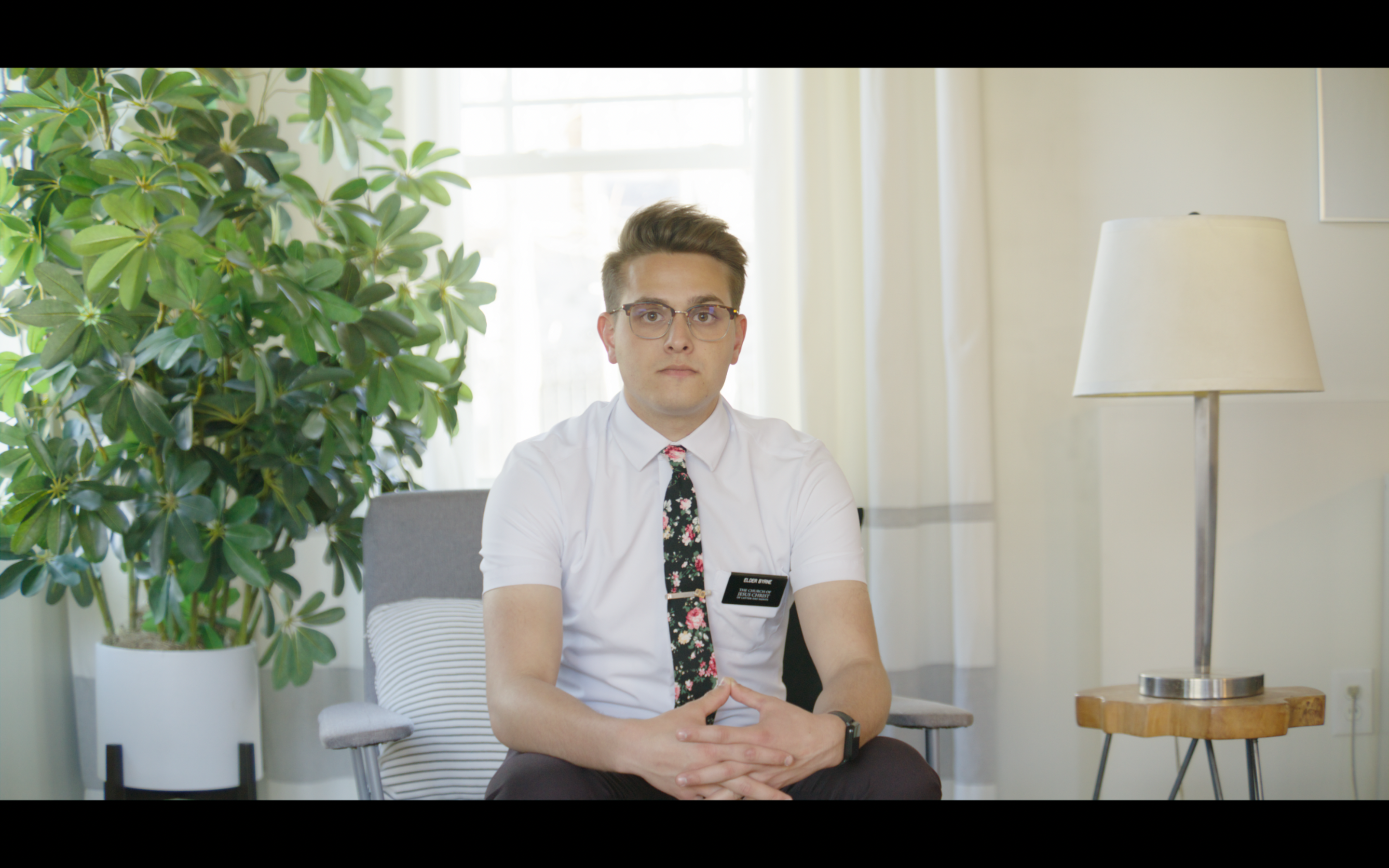

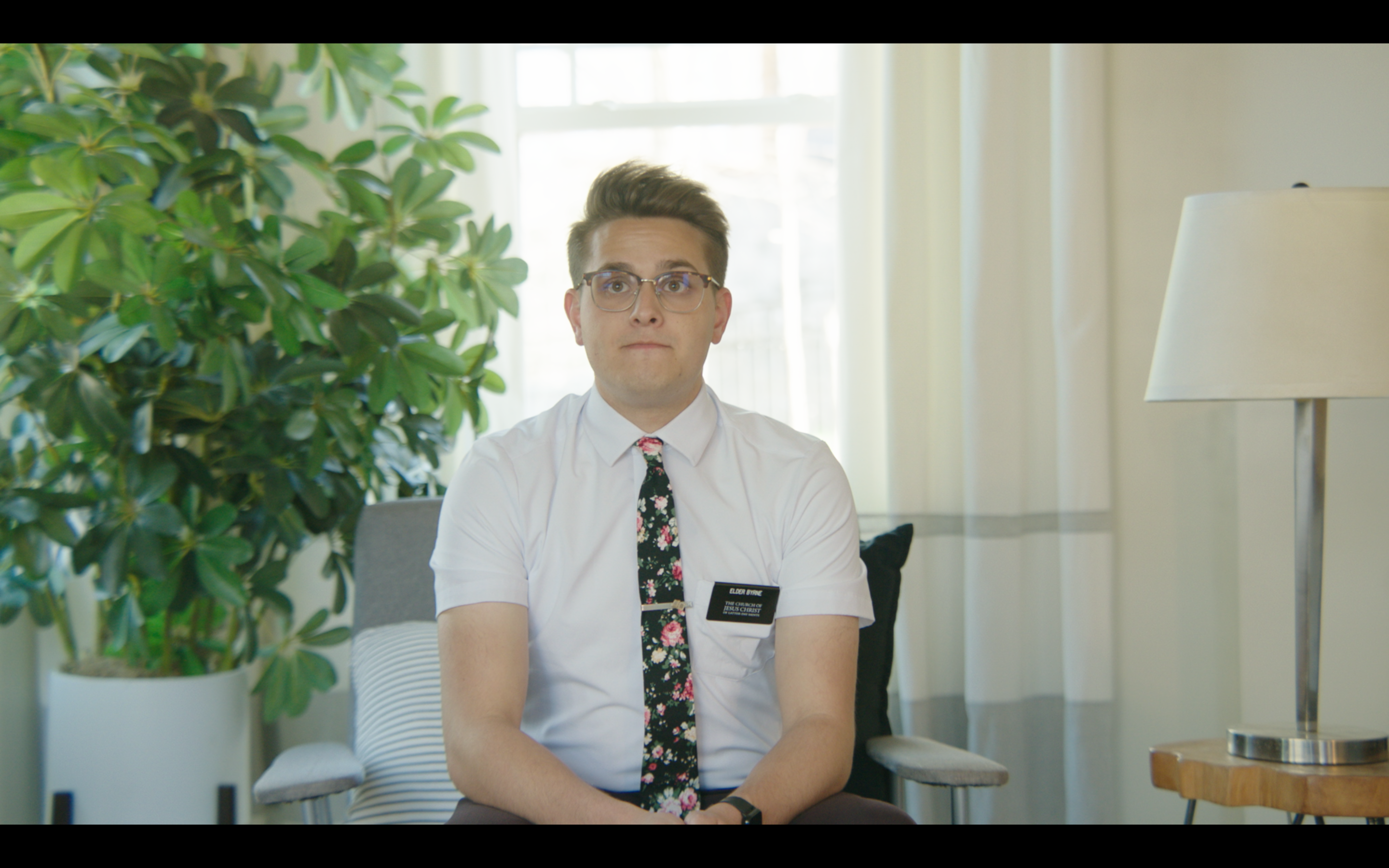

TomTheDP Posted June 10, 2022 Share Posted June 10, 2022 Just a video I made on the two cameras. I kind of rushed this video out there. If I ever get a chance I want to do more in depth testing. It really is hard to find time to make this kind of thing. I did really like the Komodo. I think the dynamic range difference is obvious and you are not going to make up for it by just exposing for the highlights as the komodo shadow retention is not unlimited. However I really do think RED has greatly improved their color science on the Komodo though it still doesn't match perfectly to an Alexa. Also yes these are just straight out of camera no color transform. A lot of people aren't going to be coloring in resolve so I thought it was best to just show a comparison with the manufacturers 709 luts applied. This is what I came up with in Resolve using the color space transform tool. ARRI on top. Adept, ntblowz, hyalinejim and 3 others 4 2 Link to comment Share on other sites More sharing options...

kye Posted June 11, 2022 Share Posted June 11, 2022 10 hours ago, TomTheDP said: Just a video I made on the two cameras. I kind of rushed this video out there. If I ever get a chance I want to do more in depth testing. It really is hard to find time to make this kind of thing. I did really like the Komodo. I think the dynamic range difference is obvious and you are not going to make up for it by just exposing for the highlights as the komodo shadow retention is not unlimited. However I really do think RED has greatly improved their color science on the Komodo though it still doesn't match perfectly to an Alexa. Also yes these are just straight out of camera no color transform. A lot of people aren't going to be coloring in resolve so I thought it was best to just show a comparison with the manufacturers 709 luts applied. This is what I came up with in Resolve using the color space transform tool. ARRI on top. Good video - easily in the top 10% of camera YT - subbed and looking forward to future episodes! In terms of the cameras, the Komodo didn't get embarrassed by the Classic, which is a tall order indeed. The giveaway for me, which is as usual, was the green/magenta balance on skintones. On some images that balance was different across various elements of the frame (e.g DR comparison when standing - 5:40), but when it was more closely matched (eg, the choir) it was only really the skin-tones that made it noticeable. It makes me wonder if a tiny adjustment to the Gamma would have closed the gap, or even pulling a soft key for skin-tones and making that adjustment. I'd also be curious to see if putting them both under the same LUT would match them better too? Assuming you can convert them both from Linear to the same Log, make any exposure adjustments, then put them through the same 709 conversion. I've found that the more of an image pipeline that two clips share, the more they'll match, and I'm used to matching things like a GH5 and an iPhone 🙂 TomTheDP 1 Link to comment Share on other sites More sharing options...
TomTheDP Posted June 11, 2022 Author Share Posted June 11, 2022 I appreciate that @kye In the images I attached in the post I used the colorspace transform tool to change the REDlog to Log C and then applied the ARRI Rec709 lut. The ARRI image was just as is, plus the REC709 lut. Both were shot at 5600k. I added in a +5 green tint to the RED in post as it seemed to lack some warmth. I was told now it looks too green so maybe the warmth coming from the Alexa is not just a tint difference. Link to comment Share on other sites More sharing options...
kye Posted June 11, 2022 Share Posted June 11, 2022 22 minutes ago, TomTheDP said: I appreciate that @kye In the images I attached in the post I used the colorspace transform tool to change the REDlog to Log C and then applied the ARRI Rec709 lut. The ARRI image was just as is, plus the REC709 lut. Both were shot at 5600k. I added in a +5 green tint to the RED in post as it seemed to lack some warmth. I was told now it looks too green so maybe the warmth coming from the Alexa is not just a tint difference. Ah, ok, good stuff. I've watched a bunch of these camera tests, especially the more serious blind ones, and I've found that there's really no way to do these comparisons properly. I've seen examples where setting the WB to the same values across different brands didn't result in the same colour balance at all, making me think that a custom WB would be better. Then people apply different LUTs in post rather than doing what you have done in matching the image pipelines. Then people don't match properly in post, applying manual adjustments shot-to-shot and pulling skin tone keys if necessary. But real projects are likely to have a bit of a look applied, unless it's a straight-up and very low budget production that can't afford any time in post (the "commercial look" that looks neutral but super clean is actually quite a processed look and is quite heavily coloured). BUT, at this point it's not really a camera test.. I suspect these issues only really apply to someone working at your "tier" in the industry, and I don't envy you at all in this regard. What I mean is that someone working at a lower tier would just buy more cameras and match them all - having a couple of GH5s or A7S2s is affordable and commercially reasonable, negating the need to match cameras. Anyone working on a higher "tier" would rent equipment and simply match brands that way, or hire a colourist and it would be matched by them. It seems to me it's the owner/operators who are doing their own low-budget jobs where they're trying to match their own camera (which they're charging out to the client) to the camera of a fellow owner/operator (who is also being charged out to the client) who are faced with this. Logic suggests that you just rent a matching camera, but I do get that helping out colleagues is critical to business as helping each other out is needed to stay in business and grow. Link to comment Share on other sites More sharing options...
TomTheDP Posted June 11, 2022 Author Share Posted June 11, 2022 14 hours ago, kye said: Ah, ok, good stuff. I've watched a bunch of these camera tests, especially the more serious blind ones, and I've found that there's really no way to do these comparisons properly. I've seen examples where setting the WB to the same values across different brands didn't result in the same colour balance at all, making me think that a custom WB would be better. Then people apply different LUTs in post rather than doing what you have done in matching the image pipelines. Then people don't match properly in post, applying manual adjustments shot-to-shot and pulling skin tone keys if necessary. But real projects are likely to have a bit of a look applied, unless it's a straight-up and very low budget production that can't afford any time in post (the "commercial look" that looks neutral but super clean is actually quite a processed look and is quite heavily coloured). BUT, at this point it's not really a camera test.. I suspect these issues only really apply to someone working at your "tier" in the industry, and I don't envy you at all in this regard. What I mean is that someone working at a lower tier would just buy more cameras and match them all - having a couple of GH5s or A7S2s is affordable and commercially reasonable, negating the need to match cameras. Anyone working on a higher "tier" would rent equipment and simply match brands that way, or hire a colourist and it would be matched by them. It seems to me it's the owner/operators who are doing their own low-budget jobs where they're trying to match their own camera (which they're charging out to the client) to the camera of a fellow owner/operator (who is also being charged out to the client) who are faced with this. Logic suggests that you just rent a matching camera, but I do get that helping out colleagues is critical to business as helping each other out is needed to stay in business and grow. The nice thing about RED is that tint and WB can be adjusted in post if you shoot RAW. I feel the Komodo is really close but I guess not quite the same. I'd be down to share some of the files if you are interested. Surprisingly it's not that uncommon to find an Alexa with a Pocket camera as the B cam. Not on super high end productions but on mid tier stuff. I am trying to see what matches best as a "cheaper" B cam. I was pretty happy with the Sigma FP but I need to post a comparison to see what others think as my eye isn't the best for color subtlety. kye, webrunner5 and mercer 3 Link to comment Share on other sites More sharing options...
kye Posted June 12, 2022 Share Posted June 12, 2022 10 hours ago, TomTheDP said: The nice thing about RED is that tint and WB can be adjusted in post if you shoot RAW. I feel the Komodo is really close but I guess not quite the same. I'd be down to share some of the files if you are interested. Surprisingly it's not that uncommon to find an Alexa with a Pocket camera as the B cam. Not on super high end productions but on mid tier stuff. I am trying to see what matches best as a "cheaper" B cam. I was pretty happy with the Sigma FP but I need to post a comparison to see what others think as my eye isn't the best for color subtlety. Yeah, I'd love to get a few files and have a play! Which pockets do you see as B-cams? Definitely curious about that. I think the FP would probably be the best candidate as a B-cam, as it's FF giving it the best lens selection, the sensor and colour seems super capable of capturing a wide DR and gamut, and the codecs are definitely up to the challenge. While I didn't follow all the details that you guys were talking about in the FP thread I think that matching it in Resolve should actually be relatively easy if the right conversions are done. If you have any shots from the Alexa and FP that you can share I'd be curious about how easy they are to match. Link to comment Share on other sites More sharing options...
