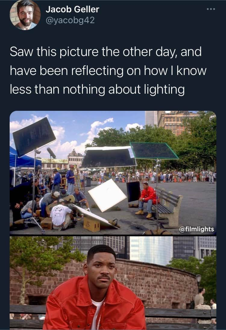

IronFilm Posted July 6, 2022 Share Posted July 6, 2022 "reflecting" 🤣 FHDcrew 1 Link to comment Share on other sites More sharing options...
FHDcrew Posted July 6, 2022 Author Share Posted July 6, 2022 Surprising things you can do without actually adding light Link to comment Share on other sites More sharing options...
