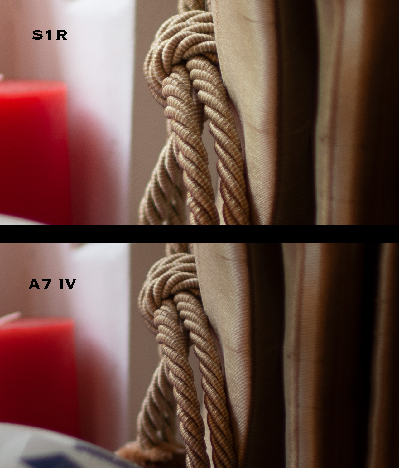

Administrators Andrew Reid Posted August 22, 2022 Author Administrators Share Posted August 22, 2022 Well here is my test with the A7 IV Original RAWs are here: https://we.tl/t-6sae7A5zAH I compared it to the S1R. Same lens, Canon FD 50mm F1.2L @ F1.4 The A7 IV does look a little bit more veiled. Ignoring the difference between 30MP and 47MP, there is definitely a fraction more softness but it doesn't seem as soft as your tests above. Link to comment Share on other sites More sharing options...
lebigmac Posted August 22, 2022 Share Posted August 22, 2022 5 hours ago, Andrew Reid said: there is definitely a fraction more softness but it doesn't seem as soft as your tests above. That looks familiar. Possibly, it looks a little more favorable because the canon glass is of better quality than these old Minolta kit lenses. But the S1 picture doesn't look as detailed as one might expect from the Canon, does it? I'll put a bunch of my analogues in front of the A7, GX85 vs. A7iv to the test again, under the same daylight conditions. Link to comment Share on other sites More sharing options...
Administrators Andrew Reid Posted August 22, 2022 Author Administrators Share Posted August 22, 2022 It looks pretty good for an F1.2 lens at F1.4 Obviously would be much crisper at F2.8 or 5.6 I wouldn't have it any other way - don't like cuttingly sharp digital images. It's very un-cinematic. Which is the Minolta that showed the poor result on the A7 IV on other page even when stopped down? Link to comment Share on other sites More sharing options...
