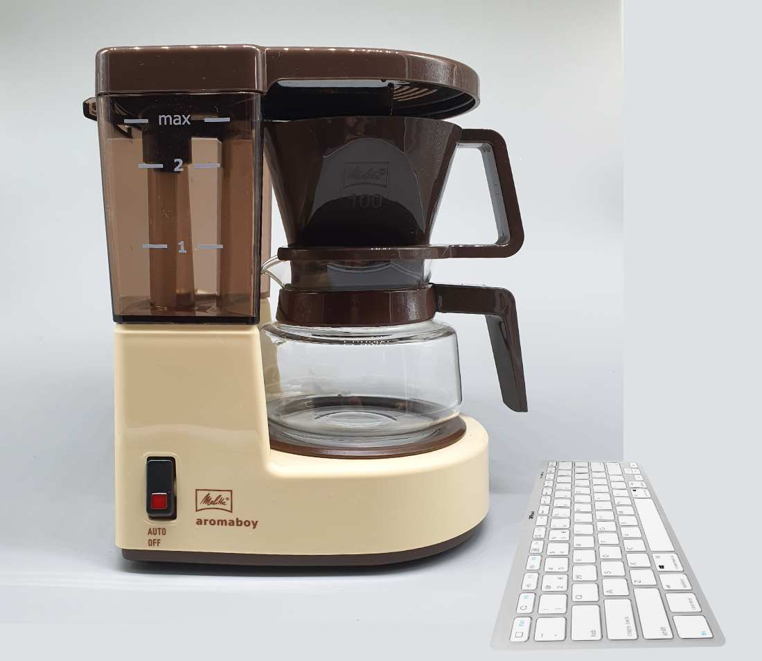

Super Members BTM_Pix Posted August 24, 2022 Super Members Share Posted August 24, 2022 18 minutes ago, lebigmac said: I'll look for a brighter area and make some photos with around f 11. Be careful stopping down as you may run into diffraction issues which will cause more issues. If you want to test this in a more structured and controlled way then you will need to use a focus calibration tool such as the Spyder. That way you can see precisely how much is in focus ahead of and behind the focus point. They aren't particularly cheap (about €60) but that might be a bargain in terms of your own time in trying to get to the bottom of things. However, it is pretty simple to make one yourself using a guide such as this one. http://www.parallax-effect.ca/2013/03/12/the-ghettocal-my-diy-lens-calibration-tool-for-micro-adjustment-enabled-dslr-cameras/ Link to comment Share on other sites More sharing options...
bjohn Posted August 24, 2022 Share Posted August 24, 2022 It is indeed puzzling. All I can say is that I'm glad I didn't decide to get an A7iv as my second camera for stills; I'll either get an original A7s or another A7iii. Almost all my lenses are from the 1940s-1980s; I only own three modern ones. All my lenses perform beautifully on the A7iii. Link to comment Share on other sites More sharing options...
Super Members BTM_Pix Posted August 24, 2022 Super Members Share Posted August 24, 2022 14 minutes ago, lebigmac said: Here a quick shots handheld with f 11 and the MD. Only relied on focus magnification, no focus peaking (Sorry Andrew for the file size). I have to say that the two images are so completely different in terms of composition and light thats its difficult to make any comparison between them. In lieu of not having a focus calibration tool, the keyboard on the desk if placed next to the coffee machine could act as an OK substitute if you place it like this crude representation. This way there will be evenly spaced and legible markers in front of and behind the focus point to compare between images. By the way, I do note from the EXIF of the A7iv file though that it appears to think the stabilisation is on ? lebigmac 1 Link to comment Share on other sites More sharing options...
lebigmac Posted August 24, 2022 Share Posted August 24, 2022 48 minutes ago, BTM_Pix said: However, it is pretty simple to make one yourself using a guide such as this one. I really feel honored, but I think, you are overestimating my skills by a long margin. BUT the setup that you've send now is outright genius!! You are just awesome. I'll arrange things as advised first thing tomorrow, and I'll give my best in the kitchen sink to make the aromaboy look like the one in your pic. And I'll look for a constant lighting environment. Regarding your 'out of focus' observation, there is a comparison set with balcony pictures linked above in one of the first posts, there seems to be the center of the scene out of focus as well on several pictures. And that was my impression after starting to shoot with the new camera. I've been shooting for years with these lenses, on a gx85, NX1, Nex5n/t, Nex3, Z6, a ton on the A7, and while they performed differently, they did always as expected and I never had the impression that something is not right with the results – until the A7iv. That's how it started. I can't rule out that in the end the photographer is to blame, since my eyesight seems in steep decline - esp. after sunset – due to my fast progressing age and decades of screen work – but still, it feels strange. Is the EXIF from the last shot? 'Steady Shot' was on and set on 50mm focal length for this, it was handheld. Link to comment Share on other sites More sharing options...
