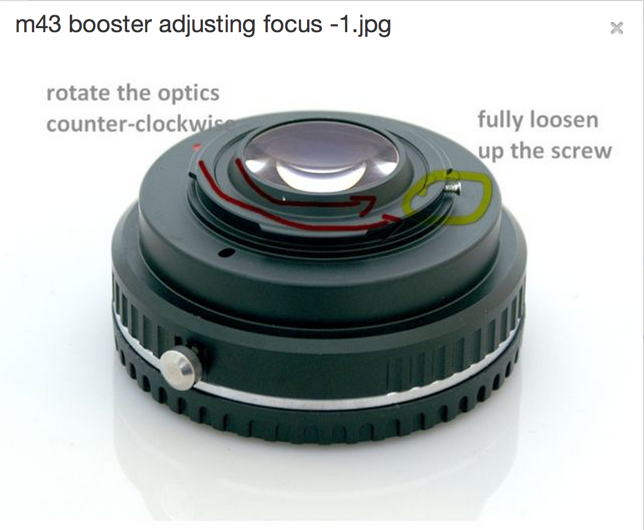

Daniel Acuña Posted January 5, 2015 Share Posted January 5, 2015 HiSo I recently bought a Contax Zeiss 50mm f/1,7 for my Gx7. I bought an adapter to fit my focal reducer (C/Y to EOS), everything is working well but I just can't focus to infinity with apertures like f/1.7, f/2.8, even f/5, it only seems to focus to infinity at f/16, I don't know if this is normal (maybe it's a stupid question), It maybe has something to do with the adapter or the focal reducer I don't know. I did put a small piece of paper between the lens and the adapter for it to be tight. So could you please enlighten me on what is going on?Thanks. Link to comment Share on other sites More sharing options...
JBraddock Posted January 6, 2015 Share Posted January 6, 2015 HiSo I recently bought a Contax Zeiss 50mm f/1,7 for my Gx7. I bought an adapter to fit my focal reducer (C/Y to EOS), everything is working well but I just can't focus to infinity with apertures like f/1.7, f/2.8, even f/5, it only seems to focus to infinity at f/16, I don't know if this is normal (maybe it's a stupid question), It maybe has something to do with the adapter or the focal reducer I don't know. I did put a small piece of paper between the lens and the adapter for it to be tight. So could you please enlighten me on what is going on?Thanks.Not sure which focal reducer you have but, the RJ has an infinity focus adjustment. I also have GX7 and Contax Zeiss 50mm f/1.7 with the same problem you have. RJ sent me this picture so that I can fix it. But I just didn't have time to do it. Just be careful though; mark the current position and rotate it in small increments until you are satisfied. In my case, I can focus to infinity but I just have to dial it back a bit. This is to fix it so that when the focus in at infinity sign, it is actually focused to infinity. Hope this helps. Daniel Acuña 1 Link to comment Share on other sites More sharing options...

Daniel Acuña Posted January 6, 2015 Share Posted January 6, 2015 Not sure which focal reducer you have but, the RJ has an infinity focus adjustment. I also have GX7 and Contax Zeiss 50mm f/1.7 with the same problem you have. RJ sent me this picture so that I can fix it. But I just didn't have time to do it. Just be careful though; mark the current position and rotate it in small increments until you are satisfied. In my case, I can focus to infinity but I just have to dial it back a bit. This is to fix it so that when the focus in at infinity sign, it is actually focused to infinity. Hope this helps.Thanks for answer, I have the Mitakon focal reducer it's seems to have the same screw, I'll try it later and see if it works. Link to comment Share on other sites More sharing options...
bunk Posted January 6, 2015 Share Posted January 6, 2015 Thanks for answer, I have the Mitakon focal reducer it's seems to have the same screw, I'll try it later and see if it works. Not the first thing I would adjust if it's a used lens you bought. If you adjust the adapter to this lens it could be off to any other lens you attach. If you have several lenses, first check the others to see if they can focus properly. If that is the case adjust Contax Zeiss instead. Chance is that it was cleaned before shipping and put back together without checking infinity. If the lens looks similar to a Contax Yashica (judging from some potos on the net it does) it should be fairly easy to do so. Here is a link with photos http://forum.mflenses.com/infinity-tune-for-contax-lens-t7011.htmlThe three screws let you turn the focus with the lens. If you loosen the screws some you can turn the ring without moving the lens. Rotate the ring 1or 2 degrees fasten the screws and see if infinity is in reach. Don't overdo it or you will loose minimum focus distance. Daniel Acuña 1 Link to comment Share on other sites More sharing options...
JBraddock Posted January 6, 2015 Share Posted January 6, 2015 Not the first thing I would adjust if it's a used lens you bought. If you adjust the adapter to this lens it could be off to any other lens you attach. If you have several lenses, first check the others to see if they can focus properly. If that is the case adjust Contax Zeiss instead. Chance is that it was cleaned before shipping and put back together without checking infinity. If the lens looks similar to a Contax Yashica (judging from some potos on the net it does) it should be fairly easy to do so. Here is a link with photos http://forum.mflenses.com/infinity-tune-for-contax-lens-t7011.htmlThe three screws let you turn the focus with the lens. If you loosen the screws some you can turn the ring without moving the lens. Rotate the ring 1or 2 degrees fasten the screws and see if infinity is in reach. Don't overdo it or you will loose minimum focus distance. Good idea. This was my initial thought as well though my lens was almost brand new when I got it so not sure if it'd been serviced before. But I will try to test another EF mount lens to make sure that it is indeed the focal reducer that creates the problem. Daniel Acuña 1 Link to comment Share on other sites More sharing options...
