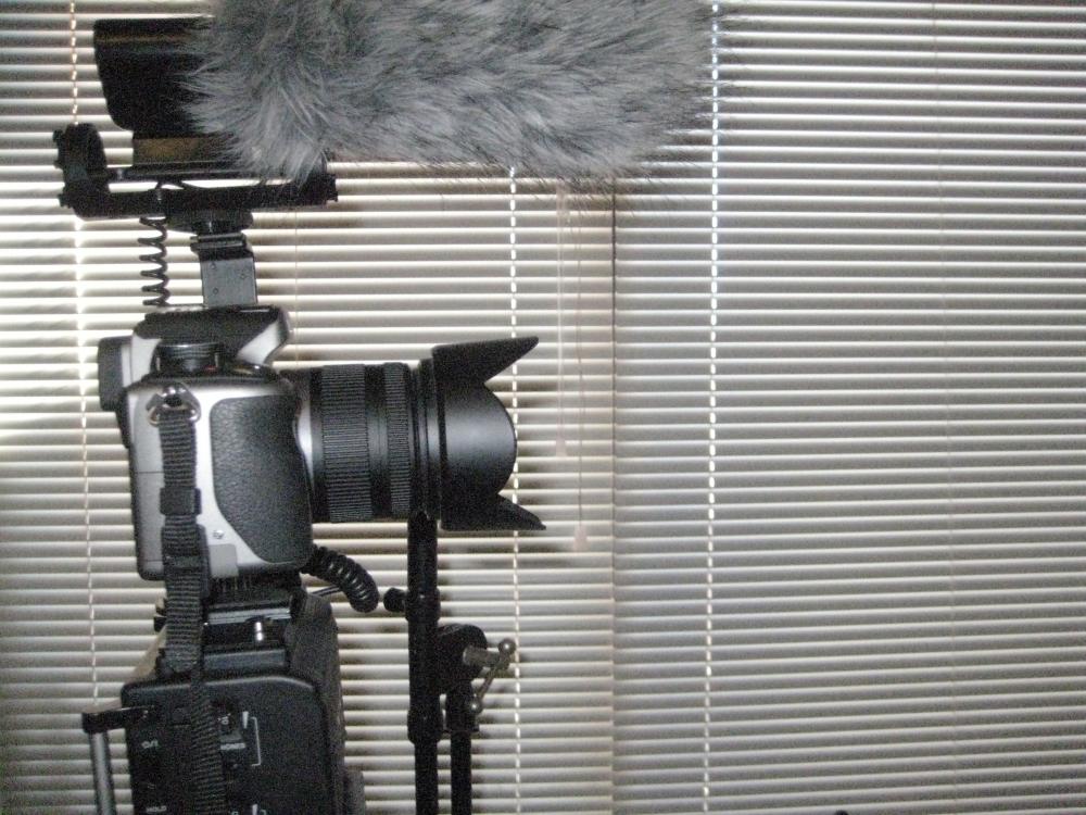

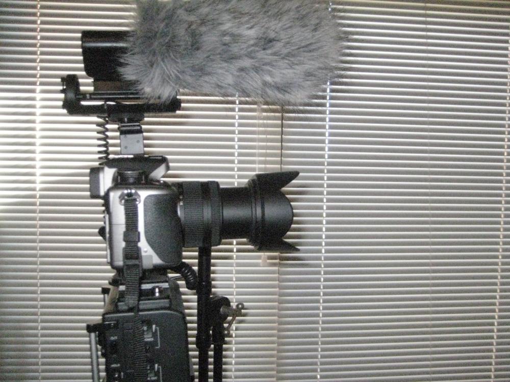

James Maynard Gelinas Posted January 11, 2015 Share Posted January 11, 2015 Push-pull lenses won't work well with a matte box and rails for a few reasons: 1. The length of the lens extends and retracts causing a shift in the matte box relative position and requiring a reset each time you change lengths. Also accidental fast zooming can break glass filters as the lens' forward extension can put significant pressure on them.Wait a minute. Is this what you mean by a push-pull lens?Panasonic Lumix 14-42 kit lens:2. The lenses typically cannot be used with a follow focus because the twisting action of the focus can cause the zoom ring to slide and thus change shot framing. Also you can't put a follow on the zoom if you would want to. 3. Most push pull zooms will if swung around slightly or significantly change the zoom position over time. This is unsuitable for anything but dead level static shots. 4. The finger position required to control zoom is more difficult with rails in the way than with a ring and adding a follow focus to the mix only makes changing your focal length even more of a pain. These apply even if you treat the zoom as a series of primes "all-in-one" so to speak. In short, it can be done but in practice they are usually such a bundle of frustration for a cinematographer that it's not worth it. Very helpful, thank you. Link to comment Share on other sites More sharing options...

andy lee Posted January 11, 2015 Share Posted January 11, 2015 Wait a minute. Is this what you mean by a push-pull lens?Panasonic Lumix 14-42 kit lens:Very helpful, thank you.thats not a push pull lens its a regular fly by wire Panasonic lens this is a push pull zoom lenshttp://kenrockwell.com/nikon/3570.htm James Maynard Gelinas 1 Link to comment Share on other sites More sharing options...
James Maynard Gelinas Posted January 11, 2015 Share Posted January 11, 2015 this is a push pull zoom lenshttp://kenrockwell.com/nikon/3570.htmOK. I have a cheap Canon FD mount 70-210mm f4. It works in a similar manner to the Nikon 35-70mm f2 you linked to. Now I'm on the same page. Thank you for your help.Given what StudioDC wrote, what's the best zoom type for use on rails with a matte box? Or are zooms such a PITA that sticking with primes remains the best solution? Link to comment Share on other sites More sharing options...

studiodc Posted January 12, 2015 Share Posted January 12, 2015 Given what StudioDC wrote, what's the best zoom type for use on rails with a matte box? Or are zooms such a PITA that sticking with primes remains the best solution?Well, some zooms have the remarkable qualities of both a non-rotating front element AND no length changes on focus OR zoom (internally focused, internally zoomed). I should note that as you've observed already, even non-push-pull zooms (those who zoom by turning a ring) can change length when they zoom. So be on the lookout for lenses which don't change length when focused OR zoomed and you'll have found an excellent candidate for a matte box with the least amount of compromises and frustration. Also, those with minimal length changes can sometimes be used, especially on the tele-end as you can just back them off the filter glass by the length they move, and use a sock or even gaff tape to block light off between the filter and the lens element. Link to comment Share on other sites More sharing options...

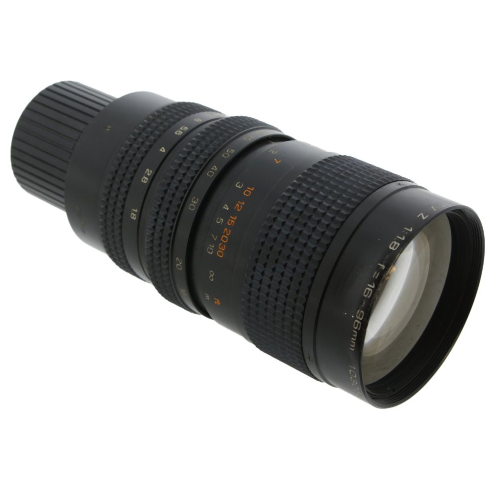

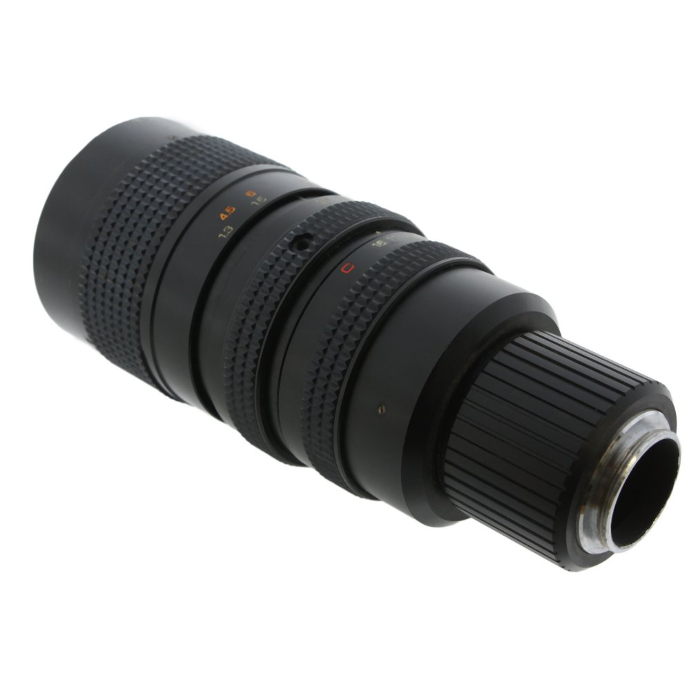

Hitfabryk Posted January 19, 2015 Share Posted January 19, 2015 Hello Andy,I do have an old Sharp TV cam ( model XC-35p) with a mountable lens a TV Z 1.1.8 f =16-96mm serie nummer '103276' Japan..It would be great to try it on my EM1, is that possible? ThanksSiep Link to comment Share on other sites More sharing options...
andy lee Posted January 19, 2015 Share Posted January 19, 2015 eerr - maybe!....it sounds like it maybe a B4 mount broadcast lens -if it is 2/3 inch format and has a x2 extender - then you can get a B4 - Micro 4/3 adaptor off ebayI have one I use on my Fujinon B4 TV Z lenses - they are superb super zooms post a pic of your lens so I can see the mount on it Link to comment Share on other sites More sharing options...
Hitfabryk Posted January 20, 2015 Share Posted January 20, 2015 Thanks Andy, here I got some pic'sSiep Link to comment Share on other sites More sharing options...
andy lee Posted January 20, 2015 Share Posted January 20, 2015 ok this looks like it is a c - mount lens (screw thread) with NO x2 converter on the back to flip inso it maybe for 1/3 inch sensor so will vignette on micro 4/3 - unless you have a Panasonic camera and can to EX TELE mode to crop in x2 . its hit and miss you will have to try it a c mount to micro 4/3 adapter is about £10 off ebay so have a go Link to comment Share on other sites More sharing options...
