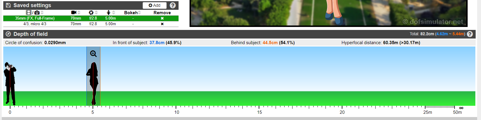

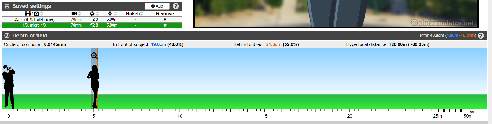

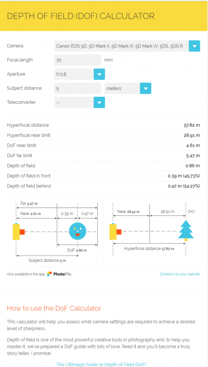

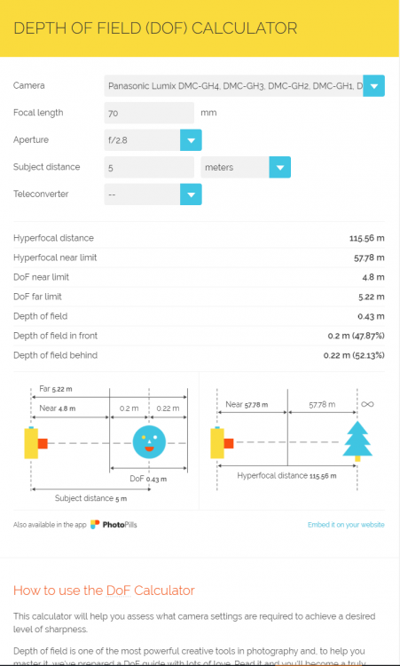

Stab Posted September 1, 2019 Share Posted September 1, 2019 Hey guys, just a quick question. So, I thought, when using the same lens, the same focal length, the same distance to subject and the same f-stop, the DOF will be exactly the same regardless of which camera or sensor size you mount the lens on. It's just the FOV that changes with different sensors, not the charataristics of the lens. Correct? Well, this DOF calculator shows otherwise. As you can see, I choose the same lens (70mm f2.8) on both sensors (Full frame and MFT), same distance to subject, same f-stop. According the DOF calculator the DOF is shallower on the MFT (0.43m) than on FF (0.86m). I expected the same DOF (but of course different FOV). Is this correct? Link to comment Share on other sites More sharing options...
Otago Posted September 1, 2019 Share Posted September 1, 2019 56 minutes ago, Stab said: Hey guys, just a quick question. So, I thought, when using the same lens, the same focal length, the same distance to subject and the same f-stop, the DOF will be exactly the same regardless of which camera or sensor size you mount the lens on. It's just the FOV that changes with different sensors, not the charataristics of the lens. Correct? Well, this DOF calculator shows otherwise. As you can see, I choose the same lens (70mm f2.8) on both sensors (Full frame and MFT), same distance to subject, same f-stop. According the DOF calculator the DOF is shallower on the MFT (0.43m) than on FF (0.86m). I expected the same DOF (but of course different FOV). Is this correct? I think you are correct - it's the same lens, how could the depth of field change ? They may be taking into account circle of confusion and resolution of the cameras, do they say how they calculate the limits for near and far limits ? It could also be that they are working back from the 2x crop and that is a problem with their methodology or code. I could see this error coming in if they calculate the depth of field based on it being a 140mm equivalent and working back, but that is wrong. Link to comment Share on other sites More sharing options...

Stab Posted September 1, 2019 Share Posted September 1, 2019 26 minutes ago, heart0less said: But OP didn't change the subject distance between the cameras, so.. @Stab, you are 100% correct. DOF should remain the same. Some great article about the issue: https://fstoppers.com/education/understanding-how-sensor-size-affects-depth-field-312599 Right, I thought so. But, that means the DOF calculator is wrong?? There is another one online, this one, at it shows the same values. Are they both wrong? https://www.dofmaster.com/dofjs.html Link to comment Share on other sites More sharing options...

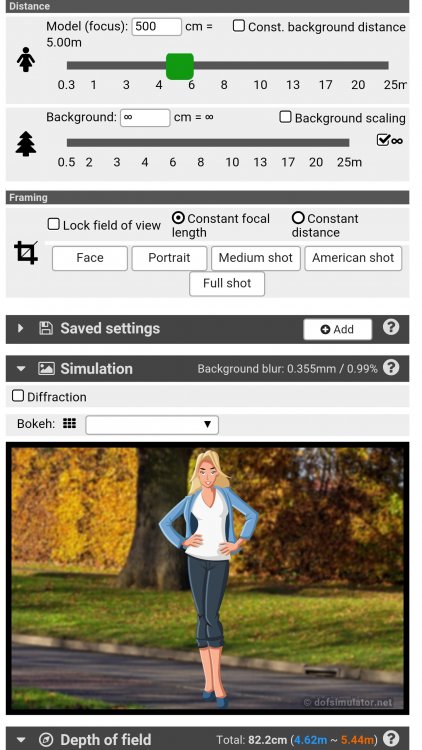

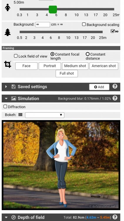

heart0less Posted September 1, 2019 Share Posted September 1, 2019 27 minutes ago, Stab said: There is another one online, this one, at it shows the same values. Are they both wrong? https://www.dofmaster.com/dofjs.html Funny thing is: the DOF calculator I use (https://dofsimulator.net/en/), shows it, too.. What's even more strange, the hyperfocal distance is different than what you get at PhotoPills. Link to comment Share on other sites More sharing options...
Stab Posted September 1, 2019 Share Posted September 1, 2019 Ok maybe we got it wrong after all? haha heart0less 1 Link to comment Share on other sites More sharing options...

kye Posted September 1, 2019 Share Posted September 1, 2019 The calculators are correct. The part that is giving you guys a headache is how you measure DoF. Something doesn't just go from being in focus and then you move it a millionth of an inch and it's now blurry. The way that these calculators measure DoF is called the Circle of Confusion, which is how blurry something can get before you can tell it's blurry. As the two different sensors you've chosen are physically different sizes but have roughly the same resolution, the smaller sensor needs something to be better in-focus before it is detectably blurry. https://en.wikipedia.org/wiki/Circle_of_confusion Quote For describing the largest blur spot that is indistinguishable from a point. A lens can precisely focus objects at only one distance; objects at other distances are defocused. Defocused object points are imaged as blur spots rather than points; the greater the distance an object is from the plane of focus, the greater the size of the blur spot. Such a blur spot has the same shape as the lens aperture, but for simplicity, is usually treated as if it were circular. In practice, objects at considerably different distances from the camera can still appear sharp (Ray 2000, 50); the range of object distances over which objects appear sharp is the depth of field (“DoF”). The common criterion for “acceptable sharpness” in the final image (e.g., print, projection screen, or electronic display) is that the blur spot be indistinguishable from a point. ie, if a tiny detail is being projected onto the sensor and it's one quarter of a pixel wide, then you move the object forwards a bit and now that object is slightly out-of-focus and it's now half-a-pixel-wide it will still appear to be perfectly sharp to that sensor, despite the fact that if you had infinite sensor resolution the DoF of any lens would be zero. Here's the circles of confusion from dofmaster: https://www.dofmaster.com/digital_coc.html Link to comment Share on other sites More sharing options...
