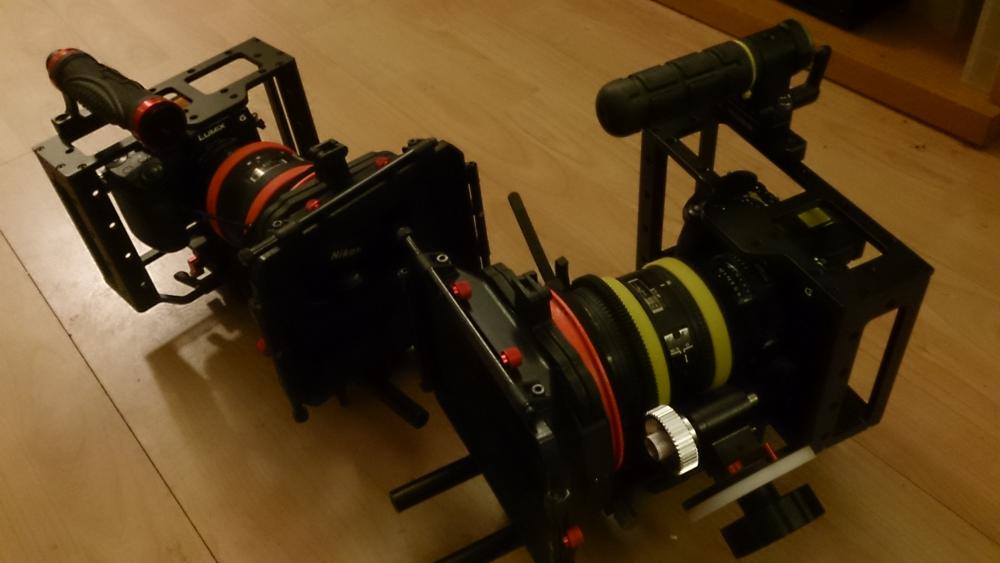

M Carter Posted February 9, 2016 Share Posted February 9, 2016 On 2/7/2016 at 3:57 PM, andy lee said: M Carter Im using the same Nikon 28-70mm on a similar rig but I have a lens support that also has the lens cable tied to it so you get no movement when using the follow focus thjis locks the lens front right down onto the lens support on the 15mm rods and no movement see pic below Expand That's pretty cool - does it release quickly? I swap lenses a lot during some shoots. On 2/6/2016 at 4:44 PM, mercer said: Hondo Garage makes a rig with an anti-twist design that looks brilliant. I cannot say first hand, because I don't use a follow focus. I find I can get a pretty good focus pull with a simple follow focus lever. Of course, Hondo Garage's 50 dollar follow focus looks like a great low budget design that I'm tempted to try. Expand It's not a twisting issue - still lens mounts don't seem to be designed for rock-solid connection, and adding an adapter gives you more points where motion can occur. What I've found is that the first twist of the FF will make the lens bump upwards (or down depending on focus direction). Using an adjustable lens support, if I'm going to do a focus move, I'll add a bit of tension, lifting the lens maybe a millimeter or less, but that takes up the range the lens would move and I get a good pull. I usually add a whip if I'm seeing any motion, the whip removes any vibration from your hand on the knob. This strategy (taking the upward play from the lens and mounts and adapters as a group) could be worrisome if overdone - you're adding some upward pressure to those points. In practice, I've found you're just taking out any available up-down play - just don't crank it up so far that it could warp something! And I usually dial it back off for static focus shots. By the way, get the Fotga DP focus is you're on a budget - really well made FF for the $$, very solid, with 2-point focus stops, main gear can flip to either side in seconds, and spares kits are on amazon (main gear, gear attach screw, and stop screws) for like ten bucks - handy to have just in case. TheRenaissanceMan and mercer 2 Link to comment Share on other sites More sharing options...
andy lee Posted February 10, 2016 Share Posted February 10, 2016 On 2/9/2016 at 6:21 PM, M Carter said: That's pretty cool - does it release quickly? I swap lenses a lot during some shoots. Expand yes it does the cable ties are quick release ties that unlock and the camera is on a manfrotto quick release plate so the whole system coems off the rig easily Link to comment Share on other sites More sharing options...
