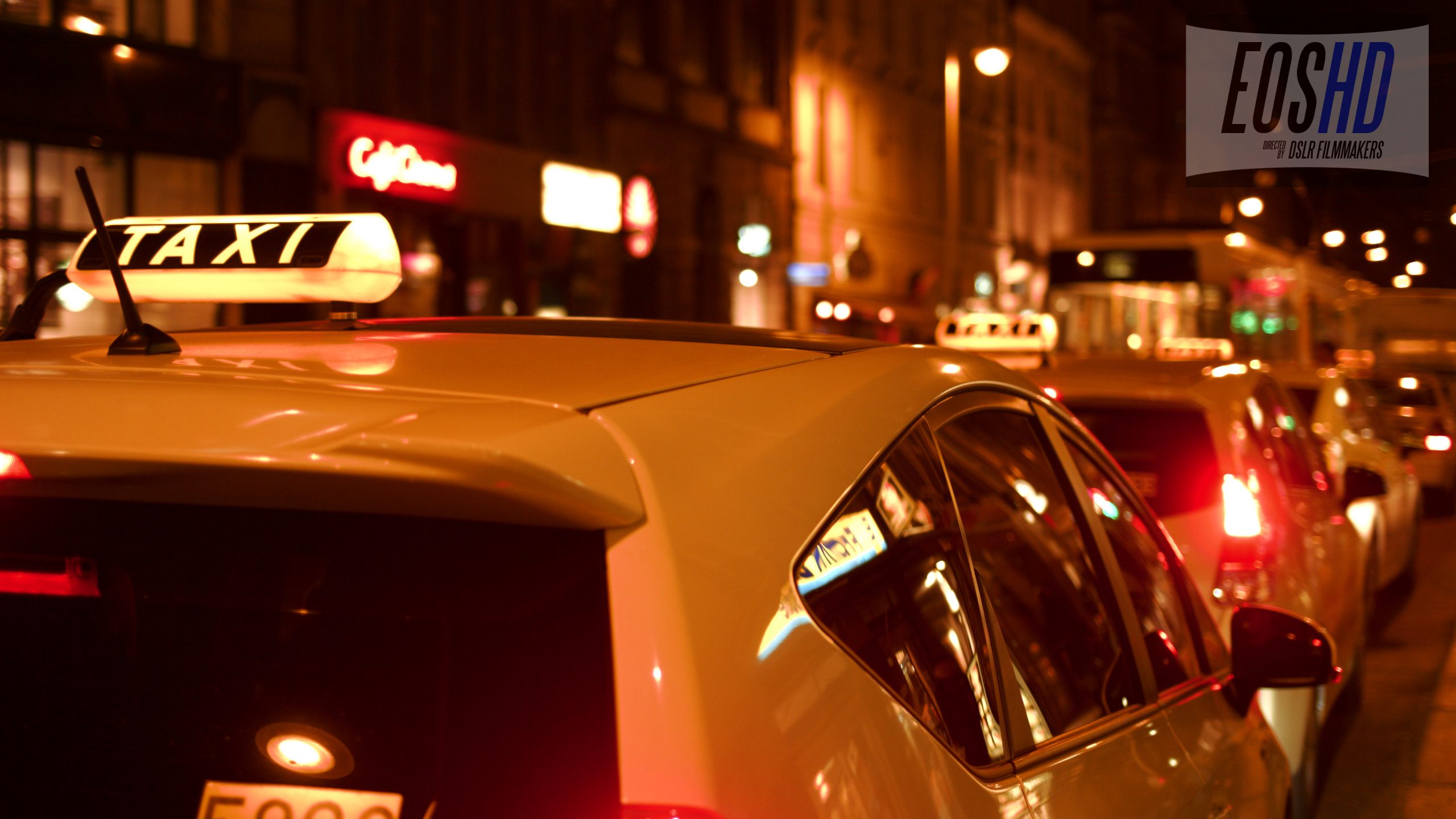

Administrators Andrew Reid Posted May 25, 2014 Administrators Share Posted May 25, 2014 Above: my sample showing no fixed pattern noise in low light at ISO 400 on the Production Camera - it's all about the grade Almost all Blackmagic Production Camera users have experienced fixed pattern noise - a banding effect or grain texture over the image - and they are quite upset at Blackmagic over the issue. But is the fixed pattern noise problem on the Blackmagic Production Camera a case of faulty cameras OR is it a limitation of the spec? This is a complex issue and every user seems to report something different. However in my own experience with the camera and of looking at the experiences of others I have to say that all units look to perform in the same way. It is a limitation of the spec, not a case of a large number of faulty units being shipped out. Yet many users - over 200 of them - are now putting pressure on Blackmagic to acknowledge a hardware or quality control 'fault' and to do hardware replacements. Sorry but I just don't think this is right. It is best to look at how to handle the camera in order to avoid the FPN in the first place...Read the full article here 1tkman 1 Quote Link to comment Share on other sites More sharing options...

Superka Posted May 25, 2014 Share Posted May 25, 2014 Some users says that FNP appear after some time of shooting, maybe when sensor heats up. I think you should have added one more point: "avoid shooting at air temperatures above 15 C". Cooling the sensor must work fine. Quote Link to comment Share on other sites More sharing options...

sunyata Posted May 26, 2014 Share Posted May 26, 2014 Just curious, has anyone tried recording the FPN against neutral grey and then using the footage in post to subtract out the noise? Quote Link to comment Share on other sites More sharing options...

Jairo Román Mukul Posted May 26, 2014 Share Posted May 26, 2014 Hi andrew, I want to buy a blackmagic camera, I want 4k, but i´m worried about fpn, so i´m thinking about buy the 2.5k model and pocket cinema camera as "b camera". But also i´m worried about the fact than blackmagic cinema camera is from 2012. I want to shoot in 4k, and i want to shot in raw, is a dream. For that reason i don´t buy gh4 camera. You are a colorist master, i´m learning, i don´t know how the fpn goes to affect mi shoots, and how reapair it in davinci, no yet. What happen with your video in the aeropark? Sorry for my english. What do you think? Quote Link to comment Share on other sites More sharing options...
Administrators Andrew Reid Posted May 26, 2014 Author Administrators Share Posted May 26, 2014 I did no noise reduction or FPN removal at all for Aerogirls yet it is clean. I shot Video Mode, exposed for Video and that's just the way it came out! Quote Link to comment Share on other sites More sharing options...
sunyata Posted May 26, 2014 Share Posted May 26, 2014 I did no noise reduction or FPN removal at all for Aerogirls yet it is clean. I shot Video Mode, exposed for Video and that's just the way it came out! Yea, that's awesome, only drawback is that it's rec709 in Video mode. It would be ideal to somehow negate the noise using Film mode too, I'm wondering if the pattern noise is static enough to take a test shot and subtract it in post. In Nuke I think you would just do a subtract and then do an expand on the noise to alter the amount to subtract. It might not be static enough to work though. If you wanted to post the footage to do this with I'd be happy to test it in flame or nuke, but you could use after effects too. Maybe Resolve's procedural cc window also. This is what supposedly the Axiom guys are doing with the same image sensor. They are trying to subtract the noise, but at the FPGA level. Your footage looks really good btw. I'd be interested to see a comparison with the GH4 and BMPC in Video mode since they would both be shooting rec709. Quote Link to comment Share on other sites More sharing options...

Dan Wake Posted May 26, 2014 Share Posted May 26, 2014 Yea, that's awesome, only drawback is that it's rec709 in Video mode. It would be ideal to somehow negate the noise using Film mode too, I'm wondering if the pattern noise is static enough to take a test shot and subtract it in post. In Nuke I think you would just do a subtract and then do an expand on the noise to alter the amount to subtract. It might not be static enough to work though. If you wanted to post the footage to do this with I'd be happy to test it in flame or nuke, but you could use after effects too. Maybe Resolve's procedural cc window also. This is what supposedly the Axiom guys are doing with the same image sensor. They are trying to subtract the noise, but at the FPGA level. Your footage looks really good btw. I'd be interested to see a comparison with the GH4 and BMPC in Video mode since they would both be shooting rec709. hello please can you thell me there did you get that image? thanks a lot I need info I wish to learn this technique! :) Quote Link to comment Share on other sites More sharing options...
sunyata Posted May 27, 2014 Share Posted May 27, 2014 That is a photo from the Apertus / axiom camera website, they are working on an open source 4k camera and it's using the same CMOSIS sensor as the BMPC, as best I can tell. It looks the same and has identical stats and FPN noise issues. They were explaining with the photo how they were subtracting the noise in the FPGA though, I want to try doing it in a compositor.. but I don't have the footage. The main project is about to start crowd funding: https://www.apertus.org/ Where they talk about the FPN issues: https://www.apertus.org/merry-christmas-2013 Quote Link to comment Share on other sites More sharing options...
