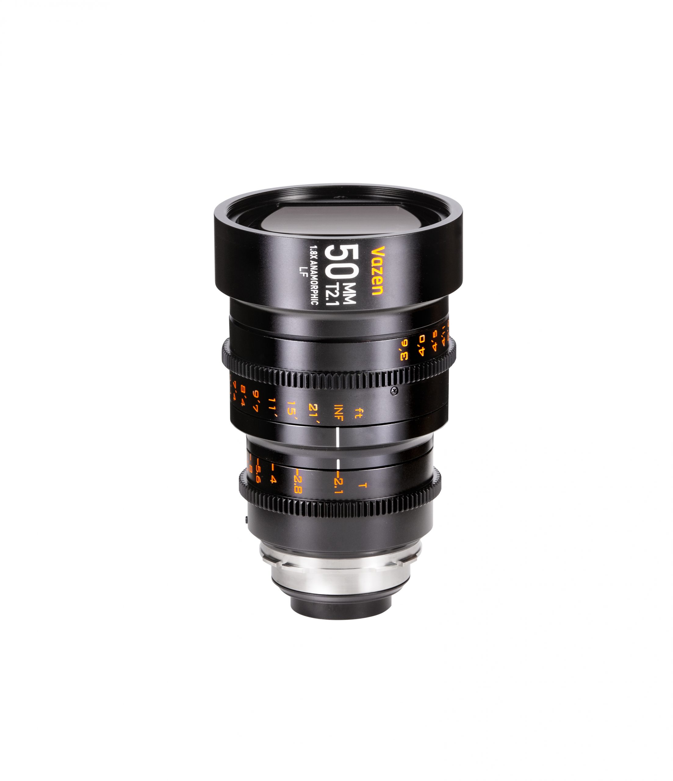

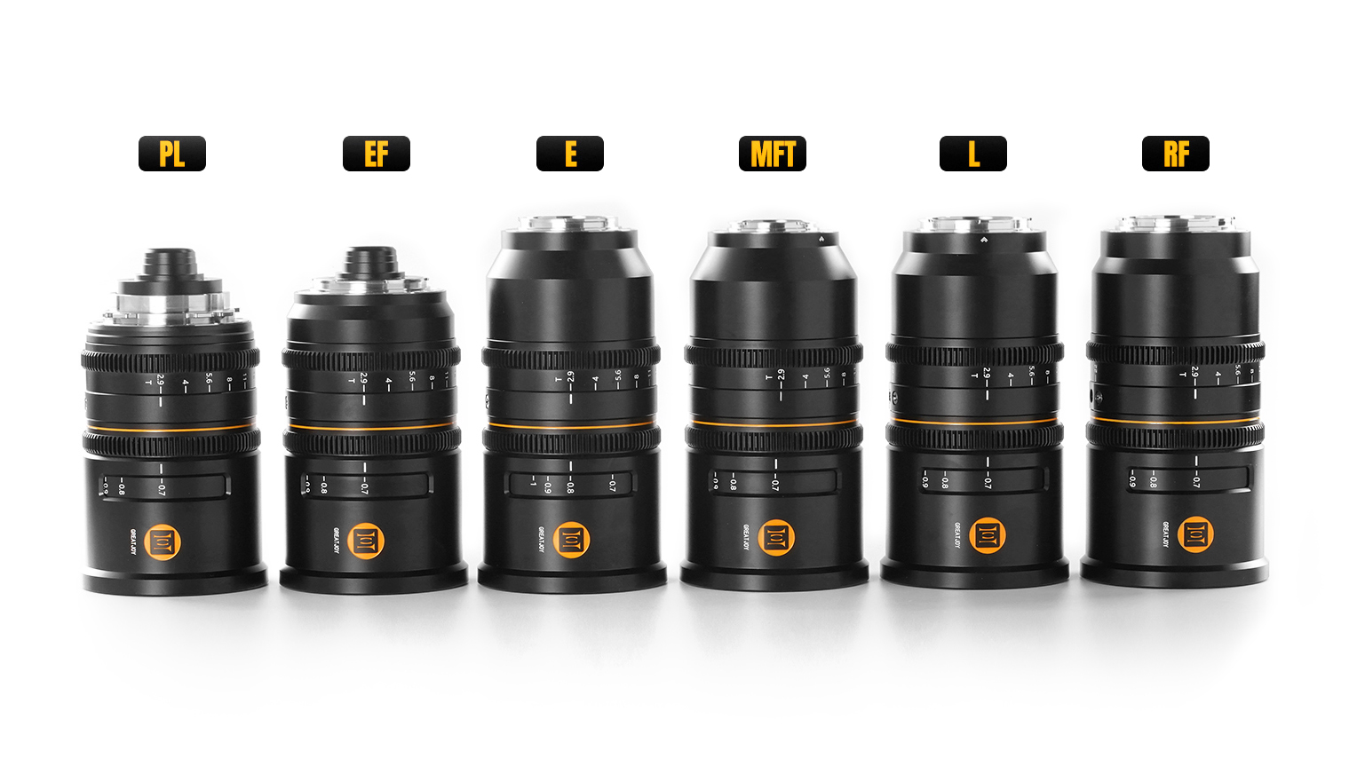

Super Members BTM_Pix Posted September 14, 2022 Super Members Share Posted September 14, 2022 On 9/9/2022 at 6:51 PM, mark100 said: Question. Can you use an APSC camera with speed booster and full frame anamorphic lenses? Tnx! You would have to check the extent to which the rear element protrudes on the lens that you are going to use to ensure that it doesn't hit the lens element of the speed booster. If you look at this Vazen 50mm for example, it has quite a large protrusion and Vazen state on their website that it will not work with all native EF mount cameras due to this - which will likely obviously make it a no go for putting it on a speed booster as well. You can see the comparison here of the protrusions for different mounts of the GreatJoy anamorphics and, whilst they don't make the same statement about native EF cameras they do state that it won't work with speed boosters. Its a conundrum because the EF version is the best option to buy this lens in because it can be adapted to all the other mounts so it immunises you against changing camera body types (or makes it more versatile if you have a few different types anyway) but it will only work on either a full frame cameras or with a dumb adapter on an APS-C camera if you don't mind not being able to reduce the FOV. Buying full frame versions will cover you if you do move to a full frame system but if you have no intention of doing so then I'd look at APS-C versions. Link to comment Share on other sites More sharing options...
IronFilm Posted September 15, 2022 Share Posted September 15, 2022 16 hours ago, BTM_Pix said: Its a conundrum because the EF version is the best option to buy this lens in because it can be adapted to all the other mounts so it immunises you against changing camera body types (or makes it more versatile if you have a few different types anyway) but it will only work on either a full frame cameras or with a dumb adapter on an APS-C camera if you don't mind not being able to reduce the FOV. Makes it far more logical by a country mile to buy it in the PL mount version instead of the EF mount majoraxis and BTM_Pix 2 Link to comment Share on other sites More sharing options...
Super Members BTM_Pix Posted September 15, 2022 Super Members Share Posted September 15, 2022 7 hours ago, IronFilm said: Makes it far more logical by a country mile to buy it in the PL mount version instead of the EF mount True as you can adapt PL to all of them. The adapters are considerably more expensive of course but unless you’ve got a few lenses and a couple of different body types then that wouldn’t be a massive issue. For me personally I’d want to use them on a native EF mount, E mount, L mount, MFT and likely soon Z mount cameras. Even using the cheap and cheerful Fotiodiox PL adapters that would be around €750 to bring that versatility whereas, because these are manual lenses and so only need the dumb adapters, it would be around €80 to adapt the EF version. I do have a PL mount camera but it has a swappable EF mount (as does the only other cinema camera I would envisage buying) so, for me personally, the EF still wins. Of course if someone envisages getting a PL mount camera without an interchangeable mount down the way then all bets are off ! Link to comment Share on other sites More sharing options...
IronFilm Posted September 15, 2022 Share Posted September 15, 2022 59 minutes ago, BTM_Pix said: For me personally I’d want to use them on a native EF mount, E mount, L mount, MFT and likely soon Z mount cameras. What cameras are there now in 2022 (no interest in using Canon DSLRs these days for me) that you'd want to use with an EF mount that a PL mount doesn't exist for? Very few, if any. Z Cam E2-S6? (or F6/F8) Can come in PL Mount as well. There would be the Pocket 6K, but that can be easily adapted to PL Mount. However I think very unfortunately the Pocket 6K Pro hasn't got an mods for PL mount yet? (if ever) 1 hour ago, BTM_Pix said: Even using the cheap and cheerful Fotiodiox PL adapters that would be around €750 to bring that versatility whereas, because these are manual lenses and so only need the dumb adapters, it would be around €80 to adapt the EF version. Eh? They're not €750, they're roughly a hundred ish bucks each: https://www.bhphotovideo.com/c/product/1470350-REG/fotodiox_pl_nikz_pro_pro_lens_mount_adapter.html 1 hour ago, BTM_Pix said: I do have a PL mount camera but it has a swappable EF mount (as does the only other cinema camera I would envisage buying) so, for me personally, the EF still wins. Not for me, EF Mount is a terrible mount to use on set (along with all other stills lenses). You just don't get to have the lenses firmly locked in like you really need them to be at critical moments when you're pulling focus remotely. If all things are equal (or only a marginal difference in price), it always makes sense to go with PL over EF mount. Link to comment Share on other sites More sharing options...
