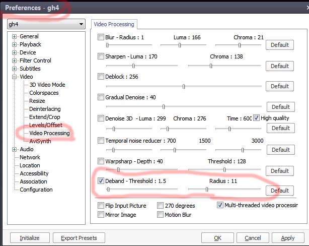

Vesku Posted March 24, 2016 Share Posted March 24, 2016 I found this topic after searching info about banding and dithering. I have got very good results with my GH4 by using dithering filter when playing GH4 4k videos. GH4 makes quite much banding in skies but when adding dither in playback the dither pattern is perfect because the is no re-compression when playing files. GH4 8bit 4k videos look almost like true 10bit videos because the dithering filter "rasterize" more tones for eye than a 8 bit file can record. It is just like a printing raster which is 1 bit but can still show perfect gradients. Mat Mayer 1 Link to comment Share on other sites More sharing options...
rs3d Posted March 24, 2016 Share Posted March 24, 2016 @vesku What filter you are using for dithering? Adding noise often adds to much until it "smoothes" out the sky banding... Link to comment Share on other sites More sharing options...
Vesku Posted March 24, 2016 Share Posted March 24, 2016 I use Potplayer in PC. It has "deband" filter in video processing section. It has two settings: treshold and radius. It makes clever dithering to smooth areas and bands. I made an example frame with heavy sharpening so that the effect is more visible: http://***URL removed***/forums/post/57489279 Here is a another sample frame. Look at smooth gradients in water: http://***URL removed***/forums/post/57494349 Link to comment Share on other sites More sharing options...
Vesku Posted March 25, 2016 Share Posted March 25, 2016 It looks like this: Link to comment Share on other sites More sharing options...
