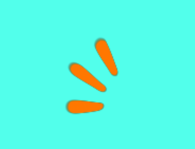

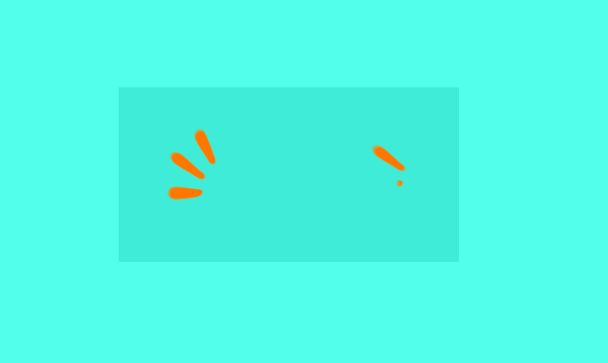

zerocool22 Posted October 16, 2022 Share Posted October 16, 2022 Hello guys, I am trying to use a video overlay in my video's. When I import and drag it over in Premiere it is instantly fine. But whenever I do the same thing in Davinci Resolve. The default clip Alpha Mode setting is "Straight", So I see these weird black edges. ==> https://postimg.cc/vDPZwMhG But whenever I change the Alpha Mode setting to "Premultiplied". The background color of the video overlay changes (even when it hasnt been scaled down). ==> https://postimg.cc/Wqtj1F8T So this is doing my head in, does anybody know a fix? Thanks! Link to comment Share on other sites More sharing options...
zerocool22 Posted October 16, 2022 Author Share Posted October 16, 2022 Ok found it Set alpha mode to Premultiplied and change Dominance to "Upper field" and make sure data levels are on "full data". Link to comment Share on other sites More sharing options...
