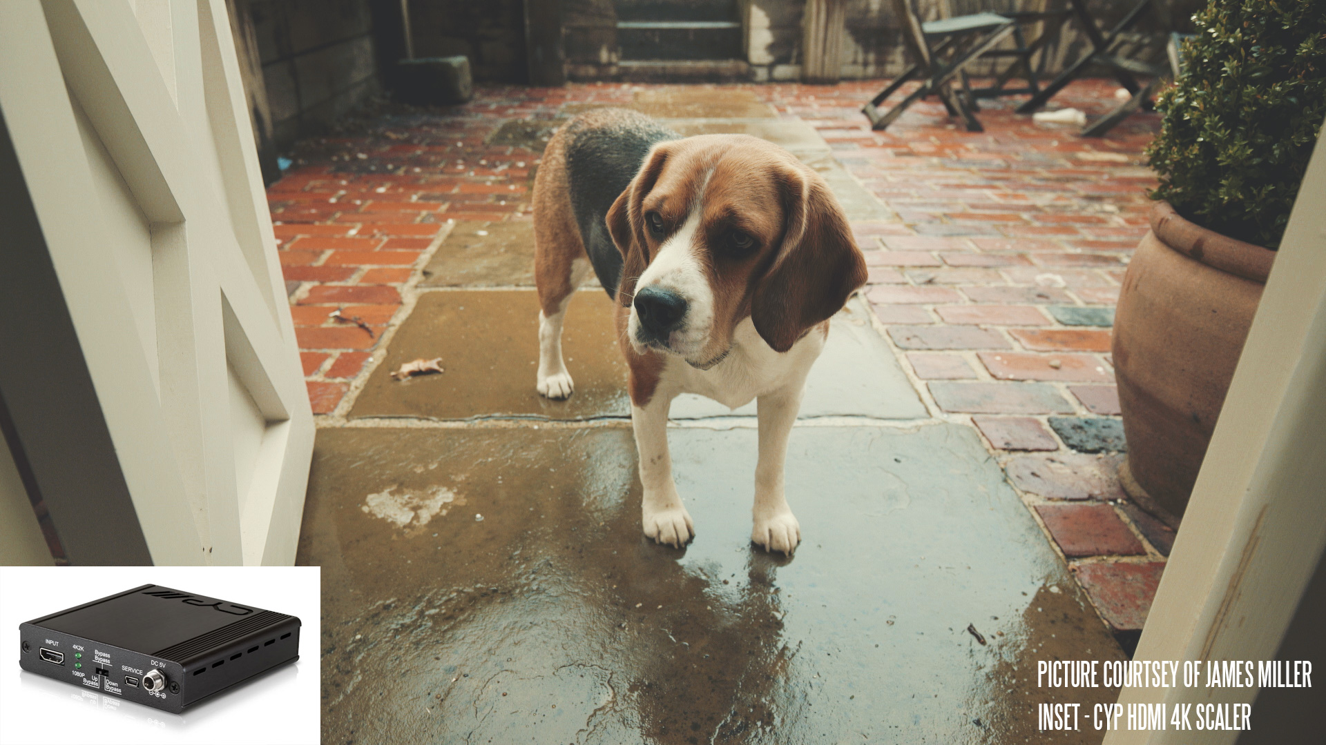

Administrators Andrew Reid Posted July 11, 2014 Administrators Share Posted July 11, 2014 Picture courtesy of James Miller, inset - the CYP 4K HDMI scaler The picture above (click for 1080p original) is from the 4K full frame sensor inside the Sony A7S (ISO 3200, S-LOG2). Internally the camera does a simple downscale of the 4K signal to 2K for standard 1080p XAVC or HDMI recording - but James discovered adding a hardware scaler on the end of the 4K HDMI signal results in a more detailed 1080p image which is light and day different. The great news is this scaler is only £167 in the UK. Add to that an Atomos Ninja Blade or Ninja Star for taking the image from the scaler and recording it to ProRes - and you have one of the best 1080p images available at any price.Read the full article here Link to comment Share on other sites More sharing options...

Marco Posted July 11, 2014 Share Posted July 11, 2014 Unfortunately there is visible aliasing in the clip Link to comment Share on other sites More sharing options...
Administrators Andrew Reid Posted July 11, 2014 Author Administrators Share Posted July 11, 2014 Unfortunately there is visible aliasing in the clip There is, but sharpening wasn't in minus setting I don't think, so might be down to that. Link to comment Share on other sites More sharing options...

CreationHacker Posted July 11, 2014 Share Posted July 11, 2014 It would be good to see if merely converting the signal into a superior codec, ProRes, accounts for the increased detail (after all the 1080 HD signal is downsized from 4K even when fed to the internal codec) or if it is superior downscaling. Please someone run a test with XVAC-S vs ProRes at HD resolution. Link to comment Share on other sites More sharing options...

Administrators Andrew Reid Posted July 11, 2014 Author Administrators Share Posted July 11, 2014 It would be good to see if merely converting the signal into a superior codec, ProRes, accounts for the increased detail (after all the 1080 HD signal is downsized from 4K even when fed to the internal codec) or if it is superior downscaling. Please someone run a test with XVAC-S vs ProRes at HD resolution. Likely no gain, I think it uses the same internal downscaling from the 4K sensor output to make the XAVC encoder and HDMI signal. But you do gain compression quality and a file that grades better. Also better motion blur with less macro blocking. Link to comment Share on other sites More sharing options...

hmcindie Posted July 11, 2014 Share Posted July 11, 2014 The aliasing gives the "apparent" sharpness look. Same thing as with watching 4k videos on a 1080p screen. The scaling is done so fast that it creates those aliased lines. A good scaler would make that look smooth but then we would miss the "OMG LOOK AT THAT SHARPNESS!"- effect. I'm more impressed by the colors. Link to comment Share on other sites More sharing options...
Guest d5f8611fa423d0e628c016f9d5c93b47 Posted July 11, 2014 Share Posted July 11, 2014 I'm confused. Why can't you just output 4K straight to the Ninja and record 1080, as with the GH4? Why does the A7s require the scaler and the GH4 doesn't? Link to comment Share on other sites More sharing options...
Julian Posted July 11, 2014 Share Posted July 11, 2014 Would this benefit the GH4 too when recording to a 1080p recorder? Link to comment Share on other sites More sharing options...
Administrators Andrew Reid Posted July 11, 2014 Author Administrators Share Posted July 11, 2014 I'm confused. Why can't you just output 4K straight to the Ninja and record 1080, as with the GH4? Why does the A7s require the scaler and the GH4 doesn't? It already does scaling for a 1080p output from 4K sensor feed, just like the GH4. However this external box takes over the job from the camera's image processor and does it better. Link to comment Share on other sites More sharing options...
Administrators Andrew Reid Posted July 11, 2014 Author Administrators Share Posted July 11, 2014 The aliasing gives the "apparent" sharpness look. Same thing as with watching 4k videos on a 1080p screen. The scaling is done so fast that it creates those aliased lines. A good scaler would make that look smooth but then we would miss the "OMG LOOK AT THAT SHARPNESS!"- effect. I'm more impressed by the colors. It does have more actual detail though. Look closely. Link to comment Share on other sites More sharing options...
Guest d5f8611fa423d0e628c016f9d5c93b47 Posted July 11, 2014 Share Posted July 11, 2014 It already does scaling for a 1080p output from 4K sensor feed, just like the GH4. However this external box takes over the job from the camera's image processor and does it better. Ah ok. So we need to see a comparison of straight to Ninja vs scaler+Ninja? I'd rather just have the Star attached than the scaler and battery too. The colours in James Miller's clip look like they could be better to me. Link to comment Share on other sites More sharing options...
