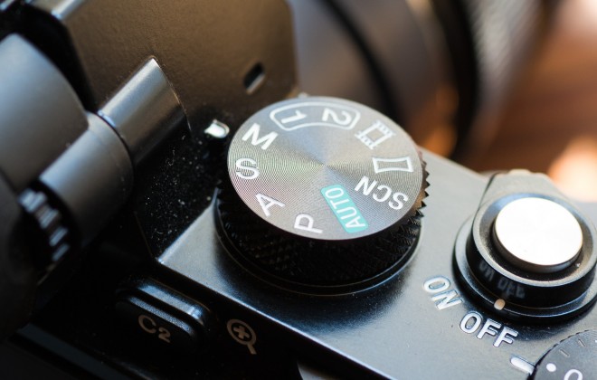

Administrators Andrew Reid Posted September 4, 2014 Administrators Share Posted September 4, 2014 After a while now shooting with the Sony A7S (final part of my review coming soon) I have found it's better to shoot video outside of the Sony movie mode on the dial. Here's how to set up the M stills mode on the dial for movie recording and get two important advantages over Sony's movie mode.Read the full article here Link to comment Share on other sites More sharing options...

Administrators Andrew Reid Posted September 4, 2014 Author Administrators Share Posted September 4, 2014 Curious as to why Movie Mode is more appropriate for scenarios that include an external recorder, such as Shogun. Because the HDMI output quality drops in stills mode and live-view doesn't always observe the right frame rate. Link to comment Share on other sites More sharing options...
blafarm Posted September 4, 2014 Share Posted September 4, 2014 Because the HDMI output quality drops in stills mode and live-view doesn't always observe the right frame rate. Very interesting. In my short time of tethering to a monitor, I hadn't noticed that. Thank you. Link to comment Share on other sites More sharing options...
jpangers Posted September 5, 2014 Share Posted September 5, 2014 Thank Andrew for the tip! It really does make a big difference for focusing in stills mode. But in stills mode it seems I loose the ability to access the audio level control. It works fine once I start recording. Did you find a workaround for this issue? Hope Sony will bring out a new firmware to fix those small annoyances. Link to comment Share on other sites More sharing options...
noone Posted September 5, 2014 Share Posted September 5, 2014 My normal A7 has the same (4x) zoom for video for checking focus both recording in the Movie mode or any other so that has improved for the A7s in other modes then. One thing though I cant use the Live View grading APP if not in movie mode and I assume the same applies for the A7s. I look forward to what the next round of "a7" cameras are going to be like. A8s, A8R and A8??? (not that I need or can justify them). Link to comment Share on other sites More sharing options...
alanpoiuyt Posted September 5, 2014 Share Posted September 5, 2014 Agree. I don't think i've touched the 'movie mode' since realising how bad the focus assist is. you can punch in double as close in stills mode. While rolling? It seems you still just get 4x zoom identical in resolution to movie mode while shooting manual but you do get that second option of 5.7x zoom when not recording. Let me know if I'm missing something - would love that extra punch in while shooting. A7r punch in is superior in resolution for some reason - more pixels maybe? Link to comment Share on other sites More sharing options...
Finn Schäuble Posted September 5, 2014 Share Posted September 5, 2014 Also, when using the Silent shutter mode, its not using the Picture Profiles, that way you can easily preview what the footage will look graded,, as soon as you hit that record button it switches back to SLOG2. Pretty Awesome! EDIT: it seems to be a Bug, You can not turn the Picture Profiles on when Silent shutter is enabled, BUT you can Enable PPs first and then enable Silent shutter after, When not shooting Video you can select all the picture Modes that you are used to, but as soon as you hit that Movie record button you are right back into your Picture Profiles, AWESOME! Link to comment Share on other sites More sharing options...

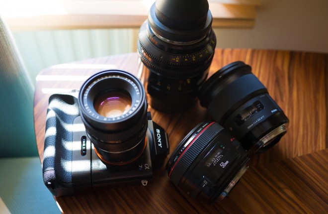

HappyCatFilms Posted September 6, 2014 Share Posted September 6, 2014 Hi Andrew; Which adapters did you use for each of the 'featured' lenses in the title image? (Leica-R 50mm F1.4, Cooke S4i Mini 50mm T2.8, Canon 50mm F1.2L and Sigma 50mm F1.4) Thanks, - Rob. Link to comment Share on other sites More sharing options...
