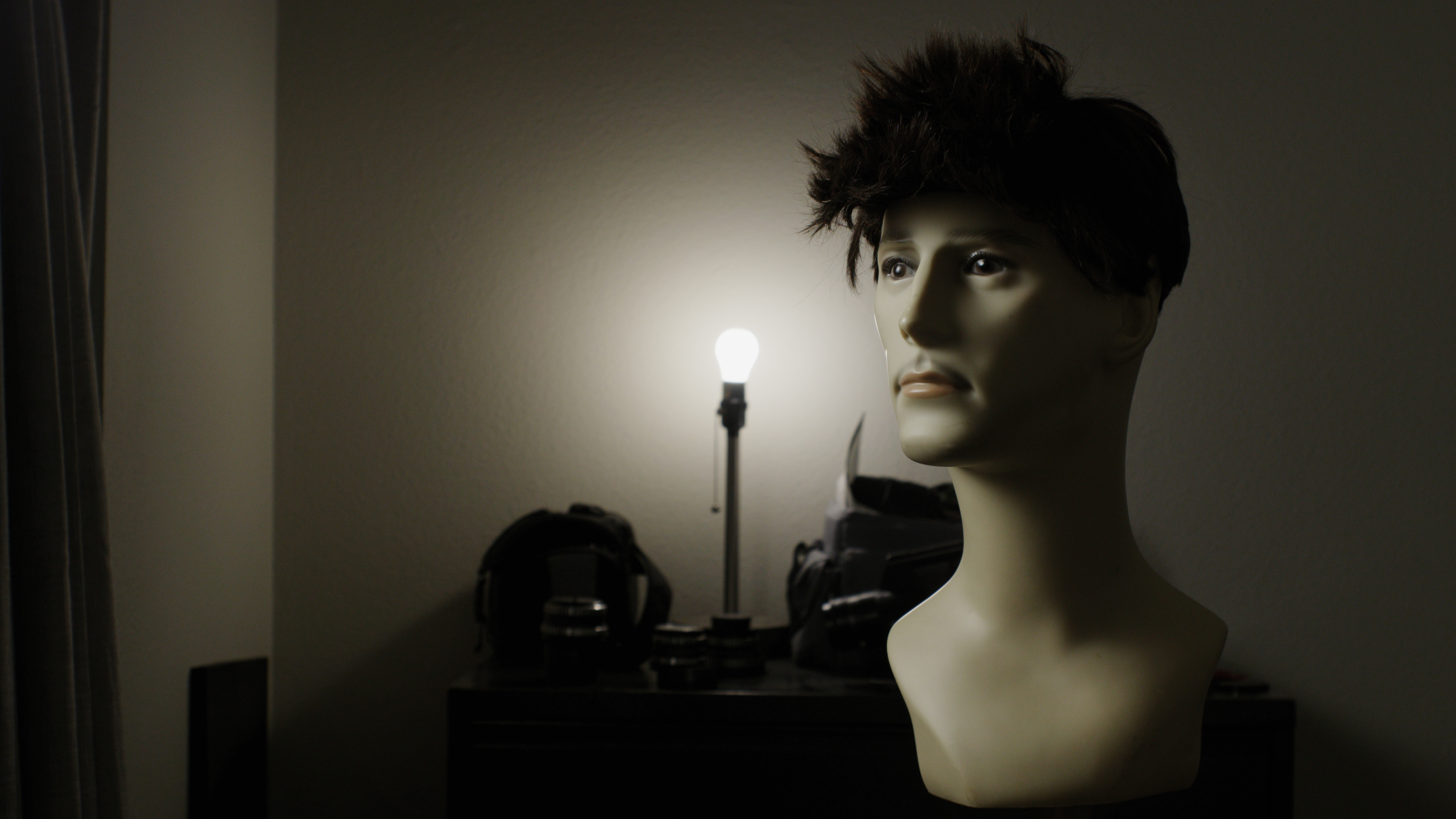

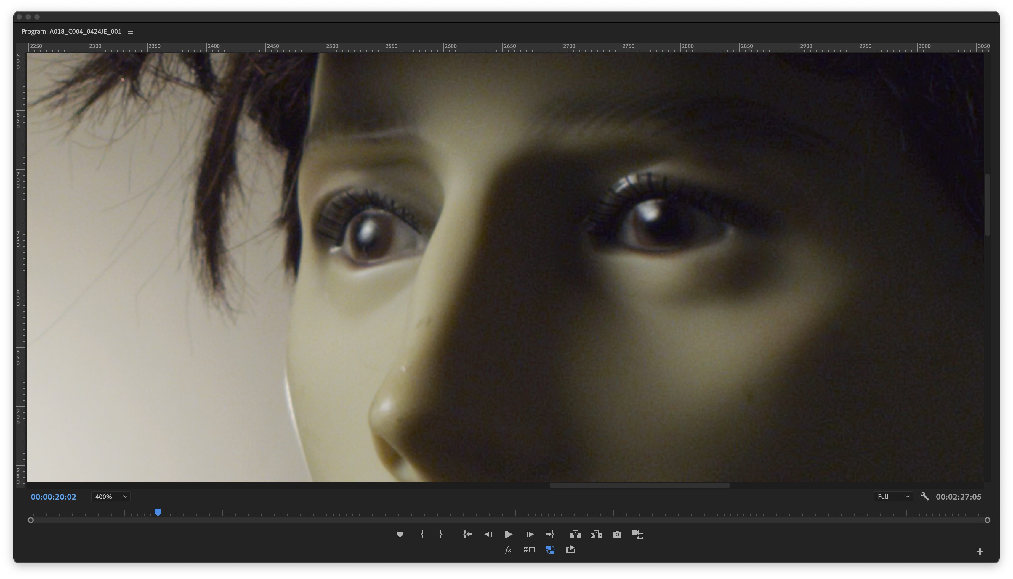

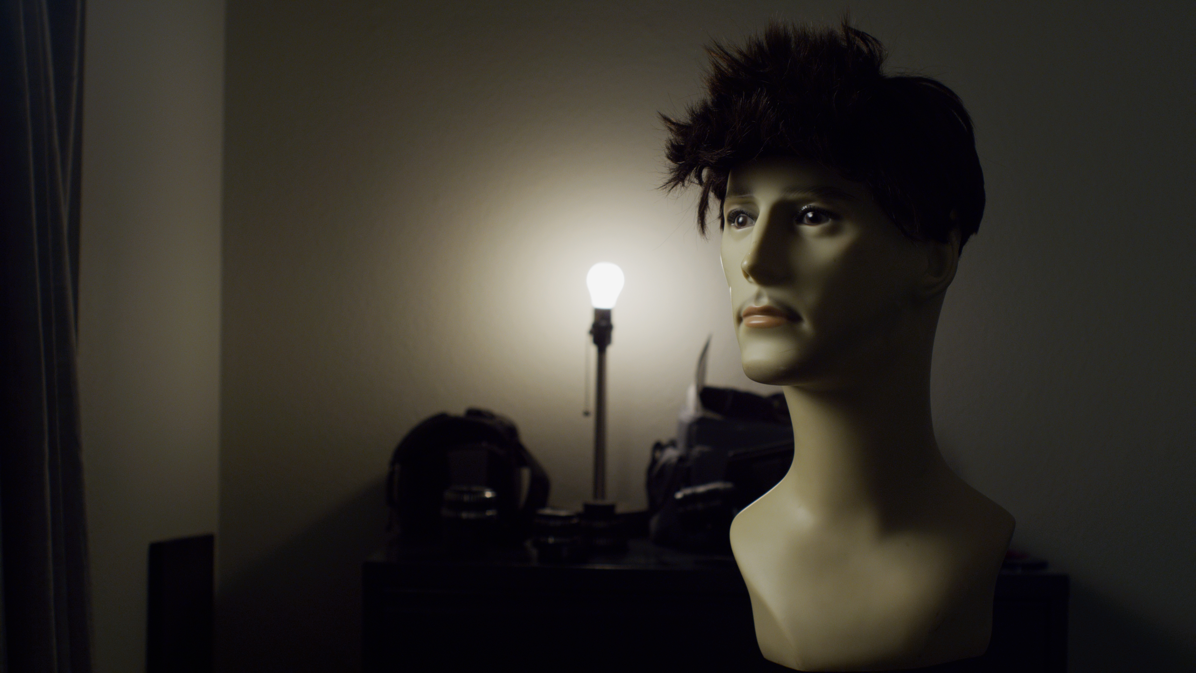

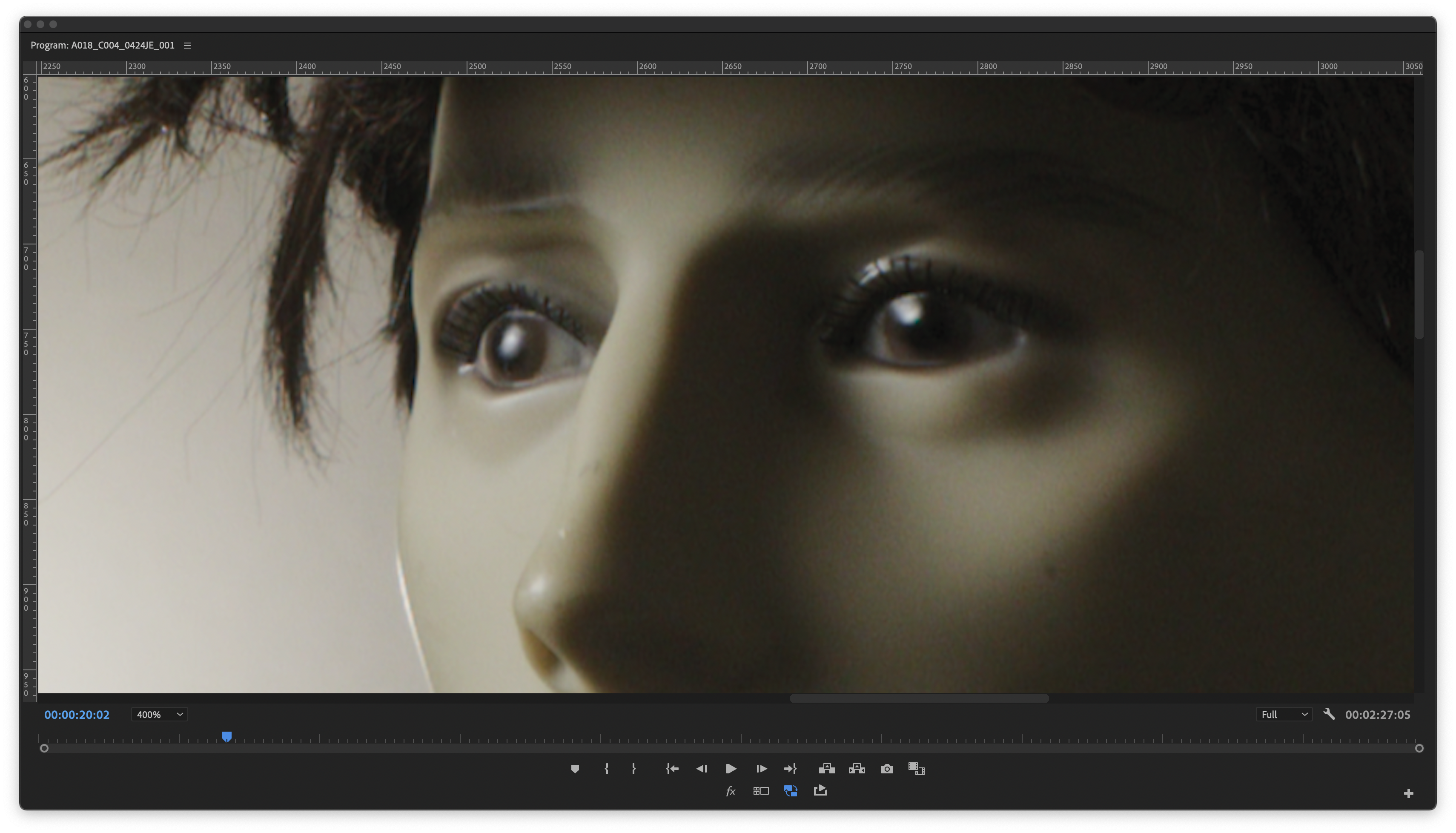

QuickHitRecord Posted January 19, 2023 Share Posted January 19, 2023 For reference, here are both cameras. Same lens and same camera settings. The C70, shooting Canon Raw Lite, is first and the R1MX is second. They weren't hard to match. It's so close that I wonder why I am bothering with the cumbersome R1MX. But once I see the moving images, I'm reminded of why I go through the trouble. solovetski and hyalinejim 2 Link to comment Share on other sites More sharing options...
