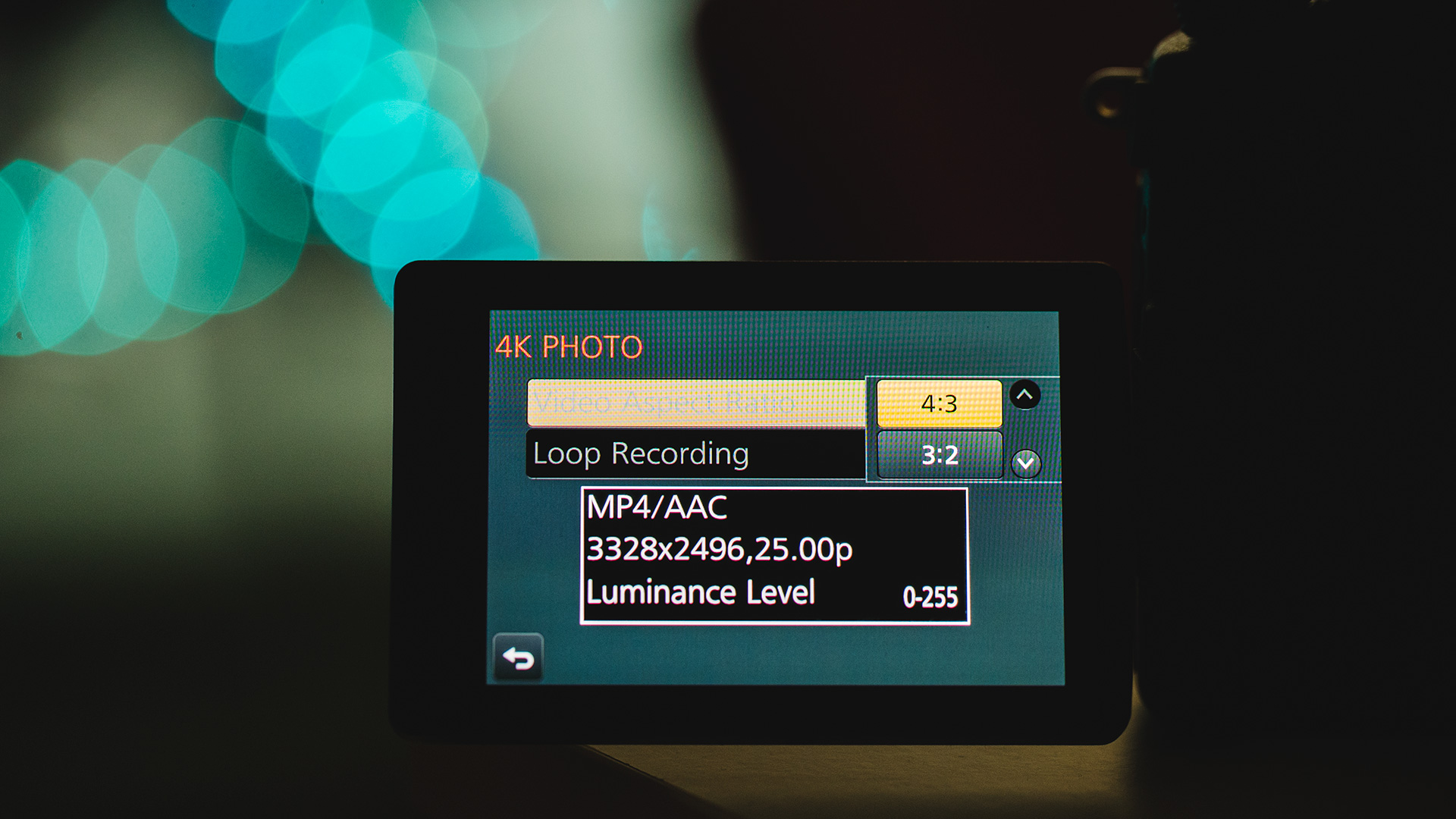

Administrators Andrew Reid Posted October 1, 2014 Administrators Share Posted October 1, 2014 New firmware for the Panasonic adds higher vertical resolutions in various aspect ratios, making further use of the camera's 4K video ability. For photographers an in-camera workflow to extract high resolution stills from "4K Photo Mode" is now available. For 4K video, resolution increases from 2160 lines in 16:9 for standard 4K to 2336 lines in 3:2, 2496 lines in 4:3 and an enormous 2880 lines in 1:1. By comparison the Red Dragon in 6K records up to 3160 lines vertically (2:1 aspect ratio). An anamorphic lens is needed to take advantage of the resolution gain in squarer aspect ratios such as 4:3 and 1:1. As a huge advocate of anamorphic at EOSHD, I'll be testing this out very shortly with my collection (below). I'm expecting the results to be stunning. I caught up with Panasonic recently to discuss the firmware update and more...Read the full article here Link to comment Share on other sites More sharing options...

Nikkor Posted October 1, 2014 Share Posted October 1, 2014 Great news. Here some size comparisons with 2x stretch preview. Personally I think the 1:1 would be my favourite, anamorphic look with realestate. Julian 1 Link to comment Share on other sites More sharing options...

drokeby Posted October 1, 2014 Share Posted October 1, 2014 It would be a nice addition for Panasonic to implement a Cinemascope aspect ratio right in camera using as much of the width of the sensor as possible. It is nice to have 2880 vertical resolution for anamorphic but the horizontal resolution suffers. (Not to deny the value of the special look of anamorphic lenses) The sensor is 4608 pixels wide. 4608 / 2.35 is just over 1960. 4608 x 1960 is a few more pixels than 3840 x 2160 (9,031,680 versus 8,294,400) and just a bit larger than 4096x2160 (8,847,360 total pixels). One would assume that they could do 4608 x 1960 at 24 fps at least. I would love to have that frame width! Or they could do 4512 x 1920 (8,663,040) or stick to their current pixel count at 4414 × 1878 (8,289,492) for 30 fps. David Xiong, ADC, johnnymossville and 1 other 4 Link to comment Share on other sites More sharing options...

Administrators Andrew Reid Posted October 1, 2014 Author Administrators Share Posted October 1, 2014 It would be a nice addition for Panasonic to implement a Cinemascope aspect ratio right in camera using as much of the width of the sensor as possible. It is nice to have 2880 vertical resolution for anamorphic but the horizontal resolution suffers. (Not to deny the value of the special look of anamorphic lenses) The sensor is 4608 pixels wide. 4608 / 2.35 is just over 1960. 4608 x 1960 is a few more pixels than 3840 x 2160 (9,031,680 versus 8,294,400) and just a bit larger than 4096x2160 (8,847,360 total pixels). One would assume that they could do 4608 x 1960 at 24 fps at least. I would love to have that frame width! Or they could do 4512 x 1920 (8,663,040) or stick to their current pixel count at 4414 × 1878 (8,289,492) for 30 fps. David Excellent suggestion! Link to comment Share on other sites More sharing options...

Administrators Andrew Reid Posted October 2, 2014 Author Administrators Share Posted October 2, 2014 Not implementing 24p is pretty dumb and kinda defeats the purpose. Hopefully they change that for US folks. It made sense as the feature is at the moment *really* targeted at photographers. Photographers need 30p and 25p to avoid strobing with light sources at shutter speeds other than 180 degrees. If you shoot at 1/200 and 24p under certain kinds of 60hz lights instead of at 30p, your stills aren't going to come out nicely. Panasonic in the US are pushing for the feature to made of use to filmmakers with 24p. For me it is still of use to us, just select 25p for the film look and make sure you set the right GH4 syncro scan rate depending on your lights. Link to comment Share on other sites More sharing options...
