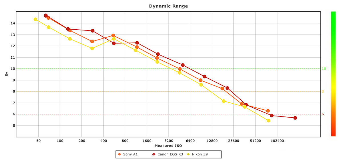

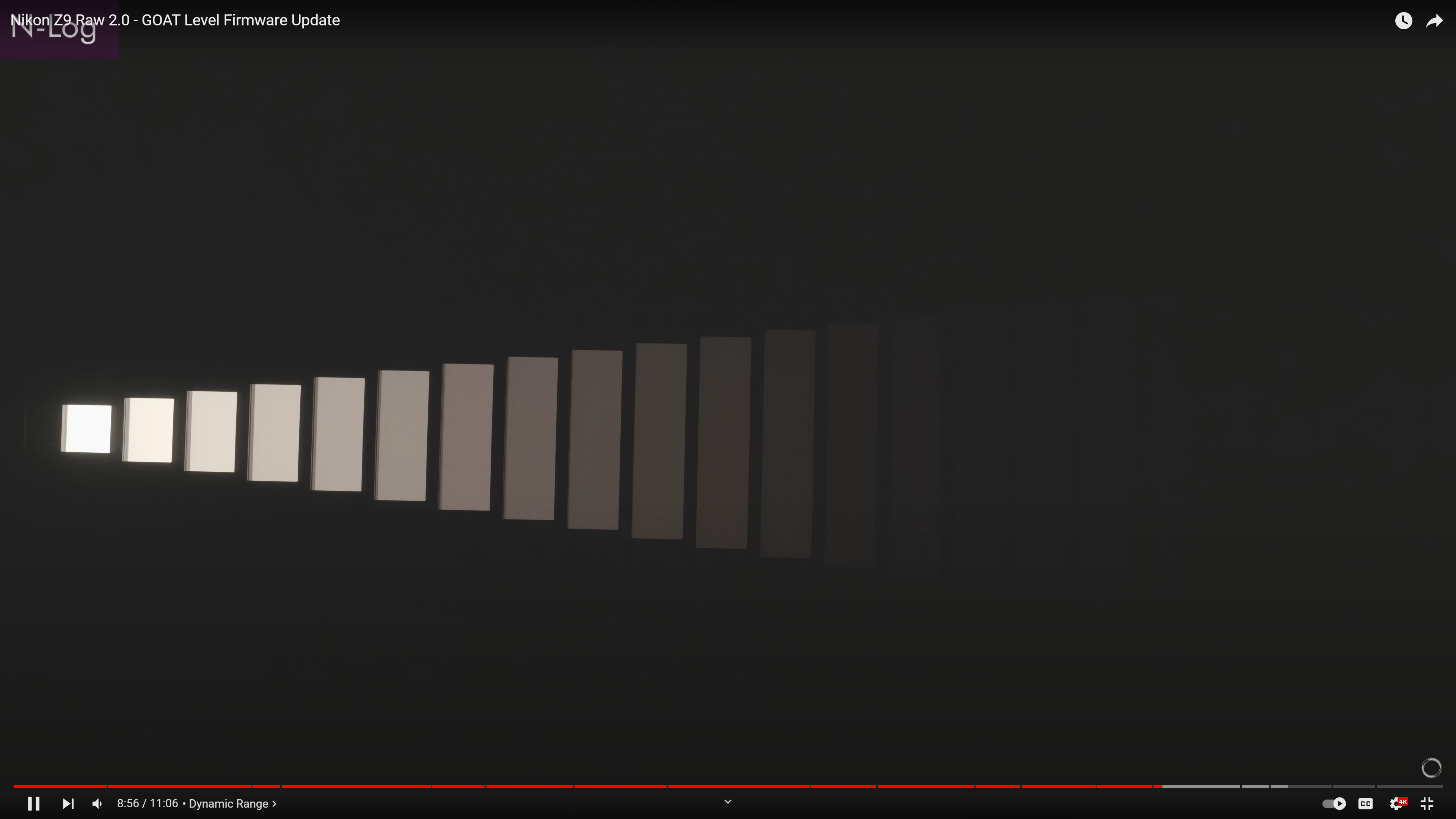

TomTheDP Posted March 23, 2023 Share Posted March 23, 2023 If it is 14 bit it should be identical to 14 bit RAW photos. Does the RAW video and photos have the same dynamic range? 12.5 stops with noise reduction isn't the greatest. Link to comment Share on other sites More sharing options...

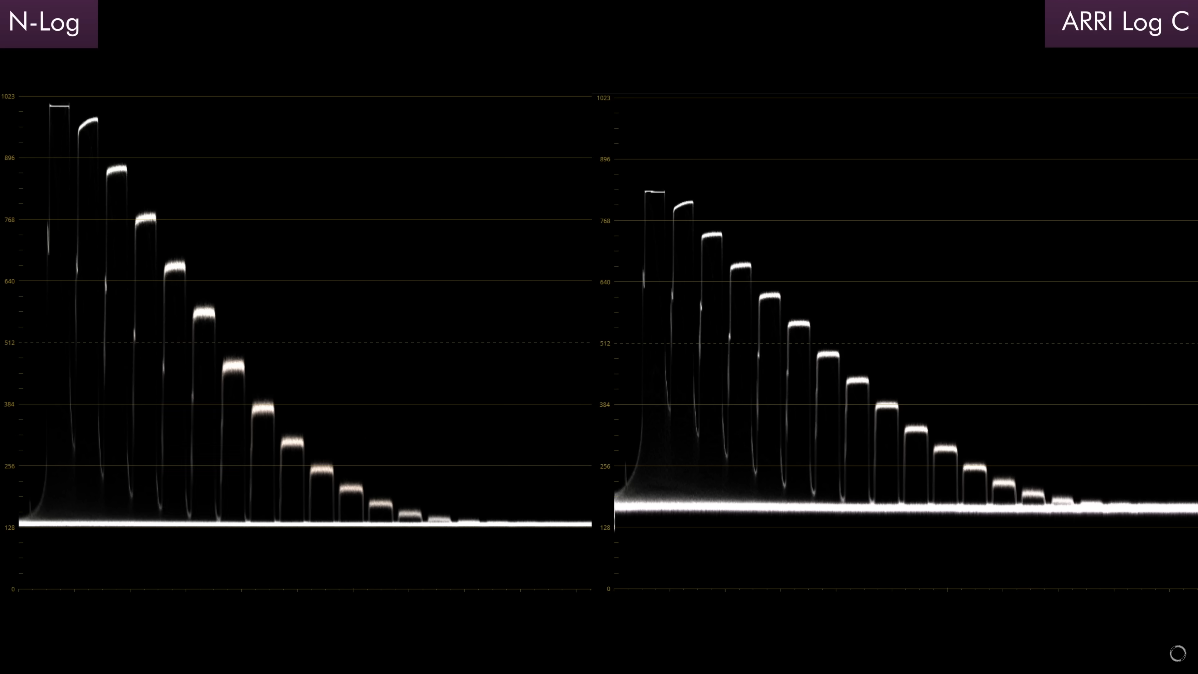

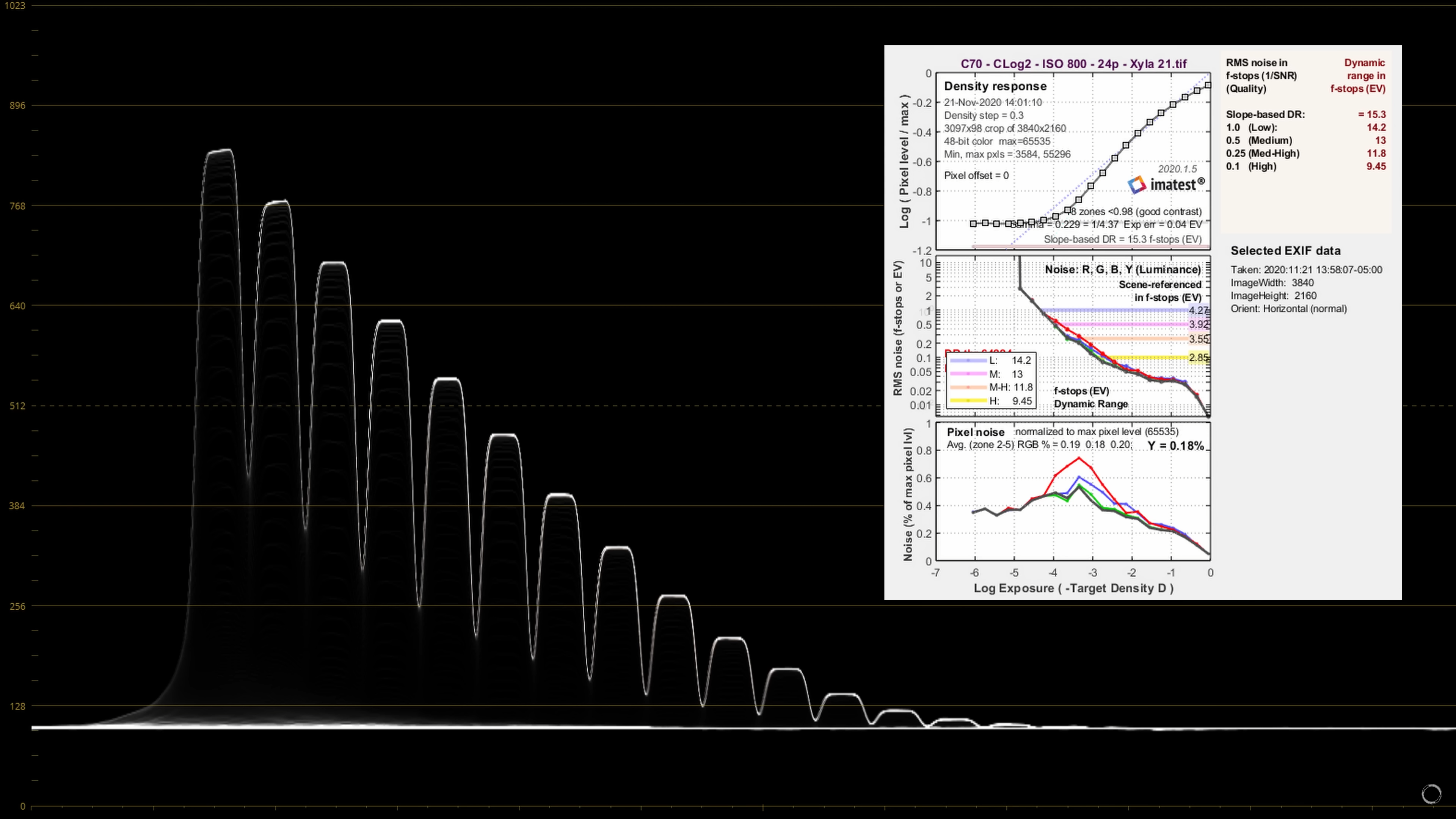

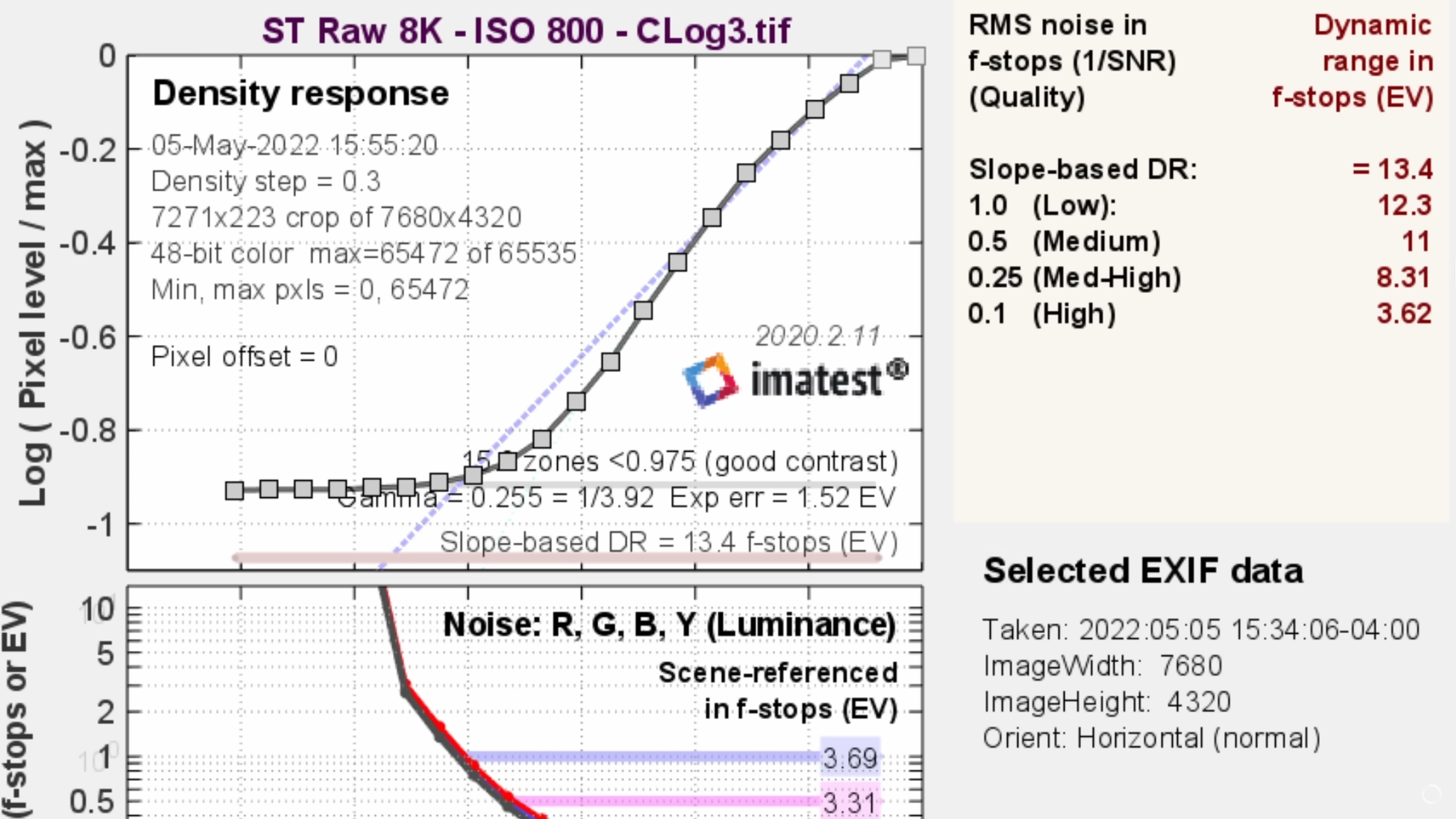

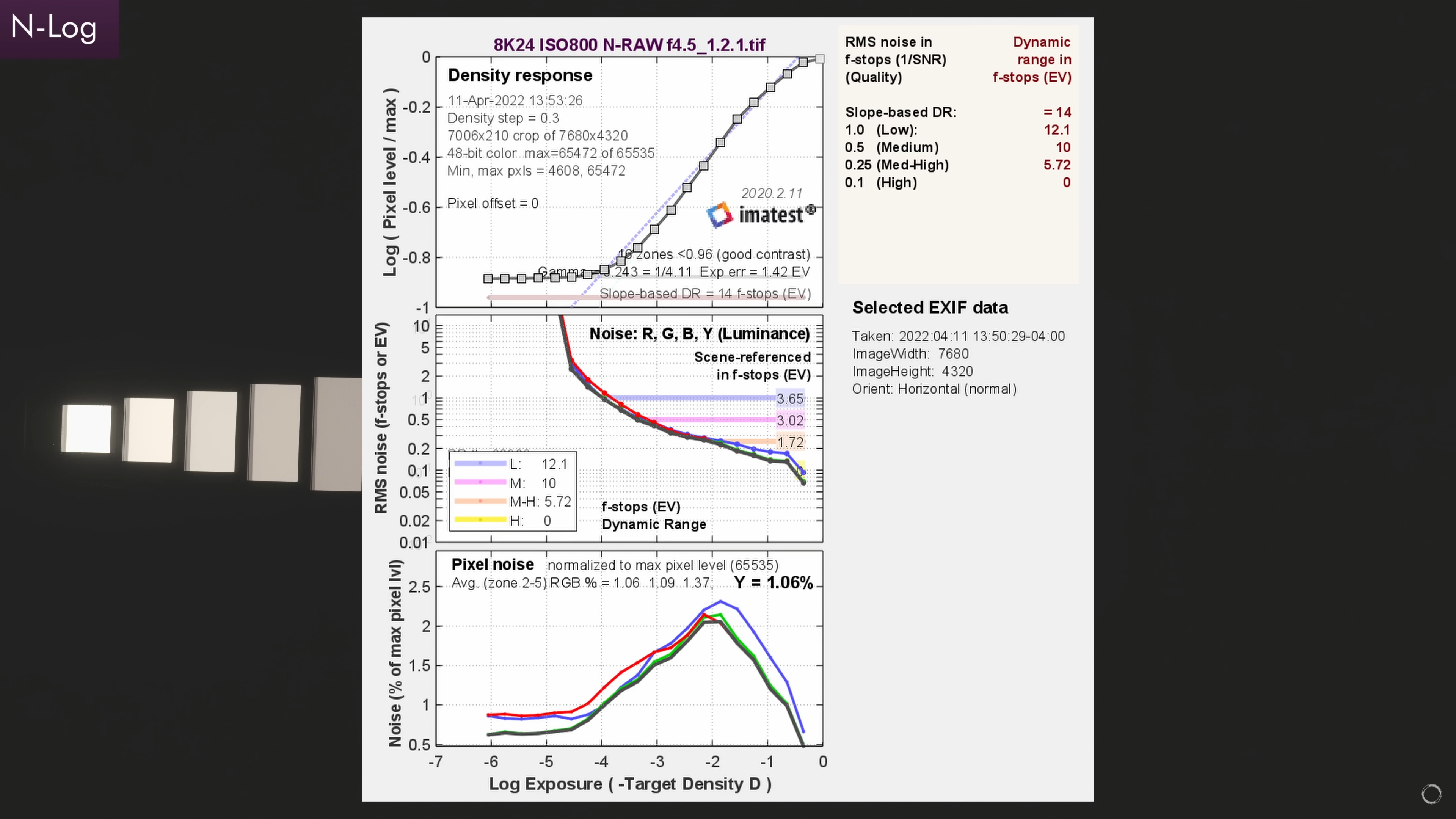

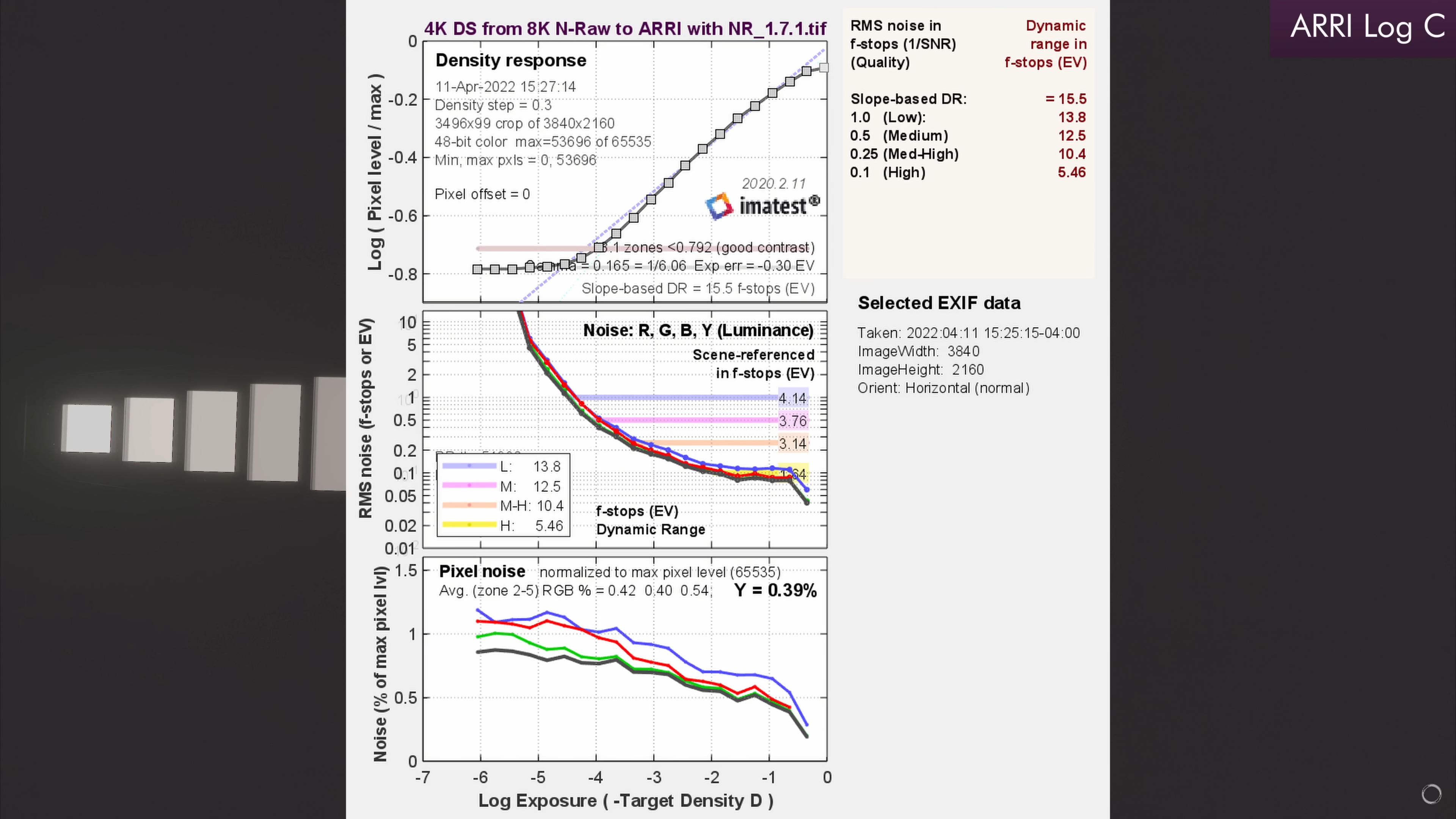

Kino Posted March 24, 2023 Share Posted March 24, 2023 33 minutes ago, TomTheDP said: If it is 14 bit it should be identical to 14 bit RAW photos. Does the RAW video and photos have the same dynamic range? 12.5 stops with noise reduction isn't the greatest. The Z9 test shows 12.5 usable from a possible 15.5 overall on an 8K timeline. That is not bad at all. NR can add only about half a stop. Compare that with the R5C in 8K RAW, which shows only 11 usable from a possible 13.4: If you scale 8K down to 4K, you can improve the Imatest result for both 8K cameras, so you have to keep that in mind when comparing with lower resolutions. For example, the 4K C70 with its DGO sensor attains 13 usable from a total 15.3 with NR applied in-camera: In terms of DR, Dxomark measured the Z9 RAW photo performance at 14.4 EV at its base 64 ISO and just over 12 EV at ISO 800, which is the native ISO for video: https://www.dxomark.com/nikon-z9-sensor-test/#:~:text=As for the individual scores,at the same ISO sensitivity. All that is very consistent with the Imatest DR above and very similar to other 8K cameras at the same ISO. What interests me more is the color depth comparison between photo and video, which is the only way to test whether the color information is retained in the 14 bit NEV files. Emanuel 1 Link to comment Share on other sites More sharing options...
TomTheDP Posted March 24, 2023 Share Posted March 24, 2023 3 hours ago, Kino said: This chart mentions NR. Is it just talking about the NR that comes from downsampling 8k to 4k? or is it adding noise reduction in davinci or other program.? If it is adding NR in post that means the actual dynamic range is about 12 stops. The Panasonic S1 has more without NR. 12 stops still isn't bad. The 8k Sony venice gets 12.8 stops when downsampling 8k to 4k in post. The RED raptor is getting 12.5 stops. So 12 isn't bad. The stills you posted do look fantastic though. Would be awesome if it was a 14 bit readout, though it seems like they would advertise that. Juank 1 Link to comment Share on other sites More sharing options...
Kino Posted March 24, 2023 Share Posted March 24, 2023 1 hour ago, TomTheDP said: This chart mentions NR. Is it just talking about the NR that comes from downsampling 8k to 4k? or is it adding noise reduction in davinci or other program.? If it is adding NR in post that means the actual dynamic range is about 12 stops. The Panasonic S1 has more without NR. 12 stops still isn't bad. The 8k Sony venice gets 12.8 stops when downsampling 8k to 4k in post. The RED raptor is getting 12.5 stops. So 12 isn't bad. The stills you posted do look fantastic though. Would be awesome if it was a 14 bit readout, though it seems like they would advertise that. It seems that he added the NR on the Z9 N-RAW 8K in post using Resolve, but it does not include downsampling. With downsampling to 4K, you should be able to get another .5 stop. So, if you take out the NR but downsample to 4K, you should be back at around 12.5 usable stops. As for why Nikon did not advertise the 14 bit NEV files, I'm not entirely sure, but I plan to find out . . . Juank 1 Link to comment Share on other sites More sharing options...
TomTheDP Posted March 24, 2023 Share Posted March 24, 2023 1 hour ago, Kino said: It seems that he added the NR on the Z9 N-RAW 8K in post using Resolve, but it does not include downsampling. With downsampling to 4K, you should be able to get another .5 stop. So, if you take out the NR but downsample to 4K, you should be back at around 12.5 usable stops. As for why Nikon did not advertise the 14 bit NEV files, I'm not entirely sure, but I plan to find out . . . I would definitely be considering it if it is a 14 bit readout. That would be very unique. 12.5 stops with the texture of 8k raw would be very nice. Still a heck of a lot pricier than my Sigma FP, but for a good reason. Juank 1 Link to comment Share on other sites More sharing options...

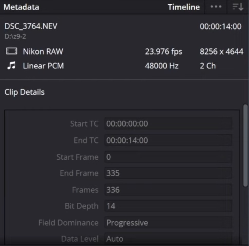

Kino Posted March 26, 2023 Share Posted March 26, 2023 I managed to download a few brief 8K 50fps NRAW NEV samples from another forum and view them in the latest version of Resolve (18.1.4): https://forum.grassvalley.com/forum/editors/editing-with-edius/572094-n-raw-from-z9-sample-download They are now listed as 12 bit according to Nikon specs. There must have been a decoding problem that has been solved since Resolve 18.0. Perhaps NEV files are captured in 12 bit log and Resolve previously converted them to 14 bit linear. It is hard to know what the issue was as TicoRAW compression is new to the camera world (hence the RED lawsuit). The same TicoRAW conversion that the Z9 utilizes when compressing for photos in the "High Efficiency" RAW mode at 14 bit readout is also utilized to create the NRAW files. In photo mode, this is limited to 20fps at full sensor readout (8256 x 5504). Although the video mode uses a crop (8256 x 4644), which produces a 38mp image, it doesn't seem possible that you could get 14 bit RAW video at frame rates higher than 24/25. The Canon R3 could do 14 bit RAW at 30fps with its 6K video, but Canon would never do such a thing! That would obliterate its current cinema line. In any case, the rich color tonality we were seeing in the Z9 footage is still there and the files edit nicely on a 4K timeline. They are perhaps not as optimized as R3D files, but they should be easier for editing than Canon 8K RAW Light. ND64 1 Link to comment Share on other sites More sharing options...
TomTheDP Posted March 26, 2023 Share Posted March 26, 2023 25 minutes ago, Kino said: I managed to download a few brief 8K 50fps NRAW NEV samples from another forum and view them in the latest version of Resolve (18.1.4): https://forum.grassvalley.com/forum/editors/editing-with-edius/572094-n-raw-from-z9-sample-download They are now listed as 12 bit according to Nikon specs. There must have been a decoding problem that has been solved since Resolve 18.0. Perhaps NEV files are captured in 12 bit log and Resolve previously converted them to 14 bit linear. It is hard to know what the issue was as TicoRAW compression is new to the camera world (hence the RED lawsuit). The same TicoRAW conversion that the Z9 utilizes when compressing for photos in the "High Efficiency" RAW mode at 14 bit readout is also utilized to create the NRAW files. In photo mode, this is limited to 20fps at full sensor readout (8256 x 5504). Although the video mode uses a crop (8256 x 4644), which produces a 38mp image, it doesn't seem possible that you could get 14 bit RAW video at frame rates higher than 24/25. The Canon R3 could do 14 bit RAW at 30fps with its 6K video, but Canon would never do such a thing! That would obliterate its current cinema line. In any case, the rich color tonality we were seeing in the Z9 footage is still there and the files edit nicely on a 4K timeline. They are perhaps not as optimized as R3D files, but they should be easier for editing than Canon 8K RAW Light. 12 bit log has a similar amount of info as 14 bit linear raw. But yeah the image definitely looks very nice regardless. Juank and Emanuel 2 Link to comment Share on other sites More sharing options...
