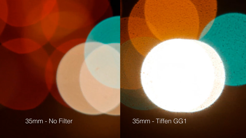

btw i noticed glimmer glass filter too but still don't have time to check the differences from other diffusion-contrast Tiffens
I did try underexposing but it didn't seem to be a much better result. It's just a bit inconsistent and fiddly to work with, whereas bounce board and ND grads just work.
All that post workflow stuff is way over my head, though. No idea. Ultra contrast is definitely more a contrast filter and glimmer glass more film look, though.

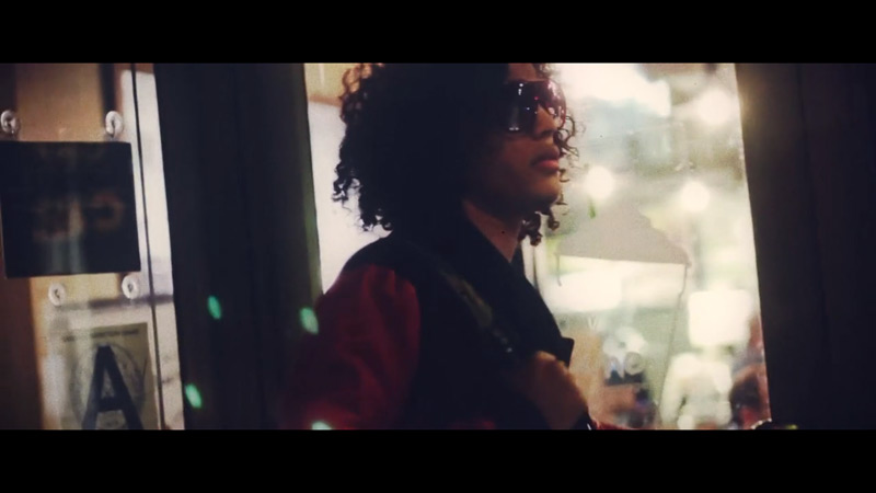

these are the green reflections I'm talking about. this guy was handholding the filters so it looks even worse here. but my problem was that the color rarely compliments the scene and if the camera is moving, the reflections move in the opposite direction (because science) which is a distraction I don't want in a movie. also, they don't look like flares, they are actual reflections of bright objects elsewhere in the frame. it's not a constant problem, but I like to use a strong backlight in many cases, and if that happens to be a practical in the frame, it becomes a restriction I'm not too keen on. That being said, you'll see in later clips in this same video, it is great at lowering contrast to different degrees.
yea, its visible at sewing machine scene. its because tiffen don't use multi coated glass. maybe putting contrast filter under multi coated clear filter or under multi coated ND filter can disable those green reflections? also additional lens hood can help
