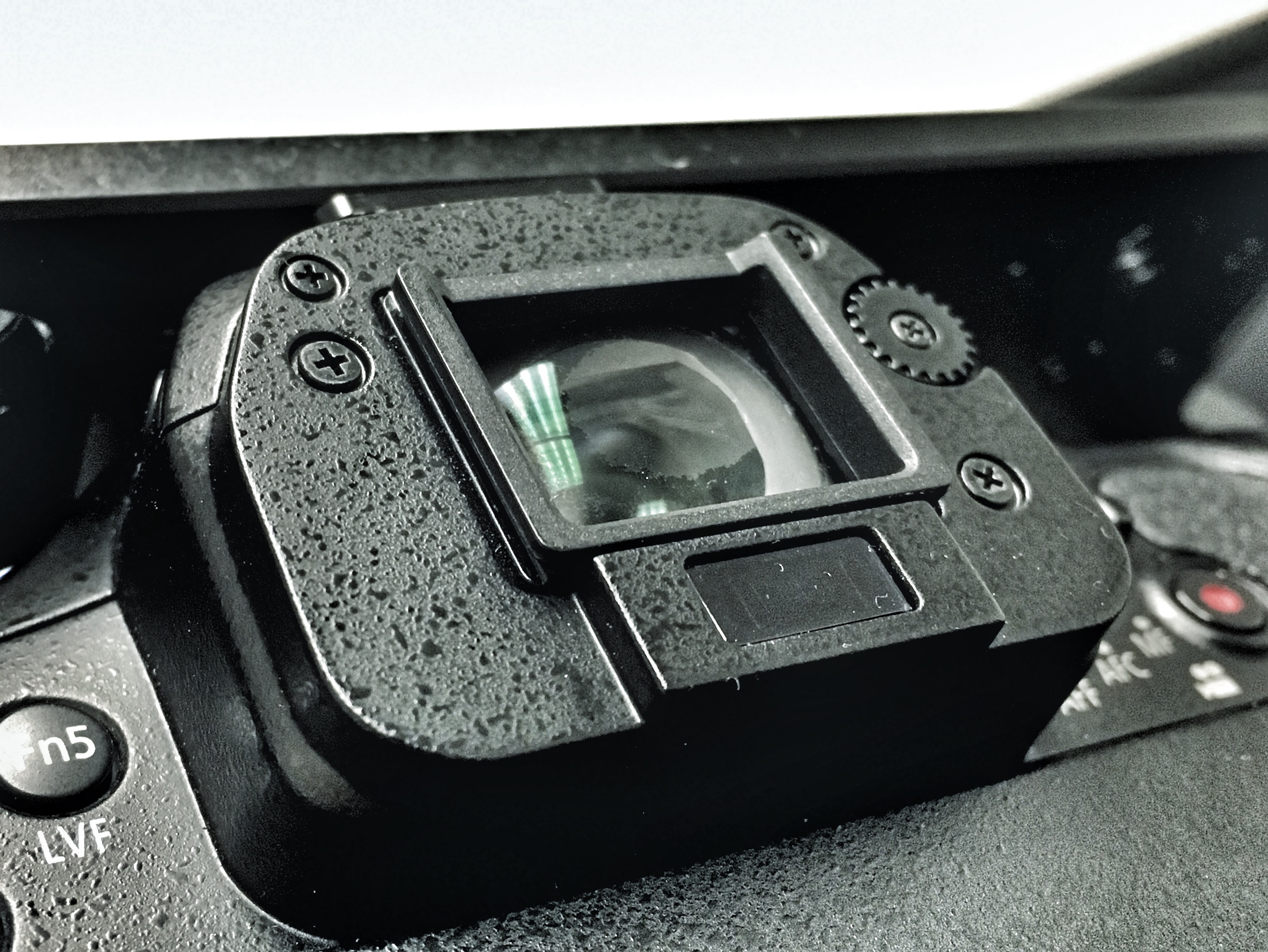

JuankyAlvarez Posted October 16, 2015 Share Posted October 16, 2015 Its been a year since this post but I have the same issue.I used a lens cleaning wipes (zeiss branded) and it sort of washed away the coating of the viewfinder.Now everything looks foggy and dreamy. Its really annoying. Link to comment Share on other sites More sharing options...
rikki Posted October 29, 2015 Share Posted October 29, 2015 that pic from juanky could easily be my own camera!out in the rain last week (briefly, i still don't trust it's supposed weatherseal), and i gave it a quick wipe down with a soft camera lens cloth, including the viewfinder glass.from then on, cloudy view.obv tried adjusting the diopter, and thought for a while it might be condensation, but on looking in bright light under a magnifying glass, it's clear the problem is on the external side of the glass, and looks absolutely exactly like the picture above.so, it seems this may be a weakness / manufacturing fault. i presume my camera's still under warranty - bought it just before xmas last year. but i use it very regularly, with jobs coming up, and can't afford to send it back to my ebay seller (in scotland i think) and have it out of my hands for days if not weeks.has anyone contacted panasonic and got results? i will do, but busy few days ahead so will have to cope. i'm really gutted! Link to comment Share on other sites More sharing options...
julianbruyns Posted November 10, 2015 Share Posted November 10, 2015 I know this is on other forums but wanted to let you guys know that using this (Plasitic polish) Novus # 2 worked like a charm.I lost the original eyepiece and since ordered the G-cup (custom eyepiece). The plastic also got scratched while the original was off. Read about this Novus polish went and got it and the result is really unbelievable. Its like new!! Link to comment Share on other sites More sharing options...
Gary Scrip Posted April 14, 2016 Share Posted April 14, 2016 OK....I had the foggy viewfinder. Tried the headlight polish............worked perfectly! It took about 6 applications. Link to comment Share on other sites More sharing options...
tdonovic Posted April 15, 2016 Share Posted April 15, 2016 I used furniture polish and mine is fine again. Put a bit on a cotton bud and wipe it around and it will fix it! Link to comment Share on other sites More sharing options...
