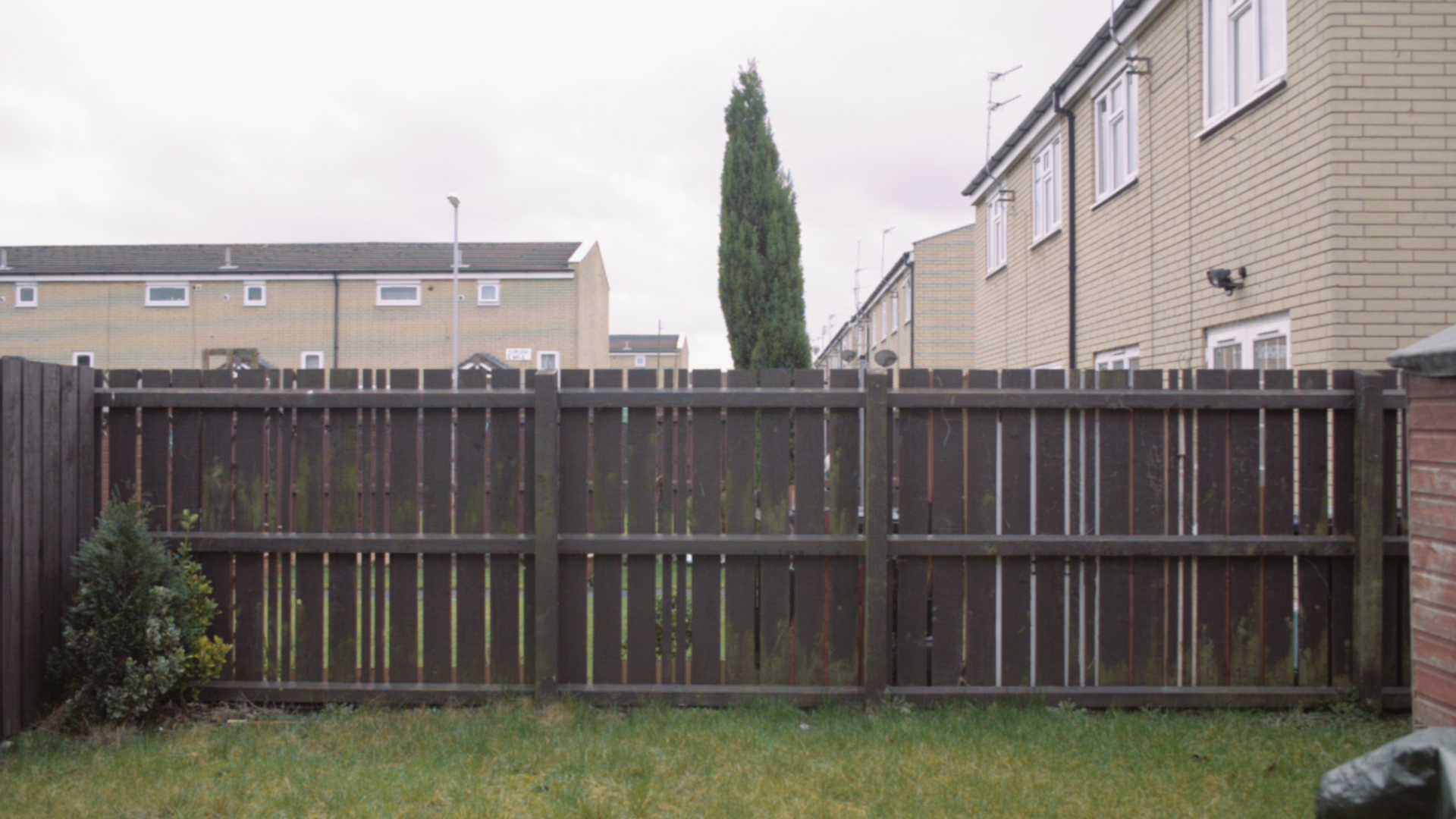

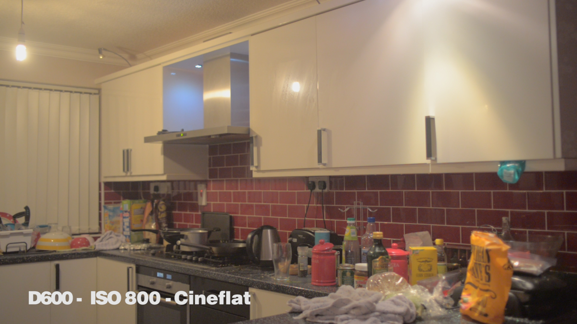

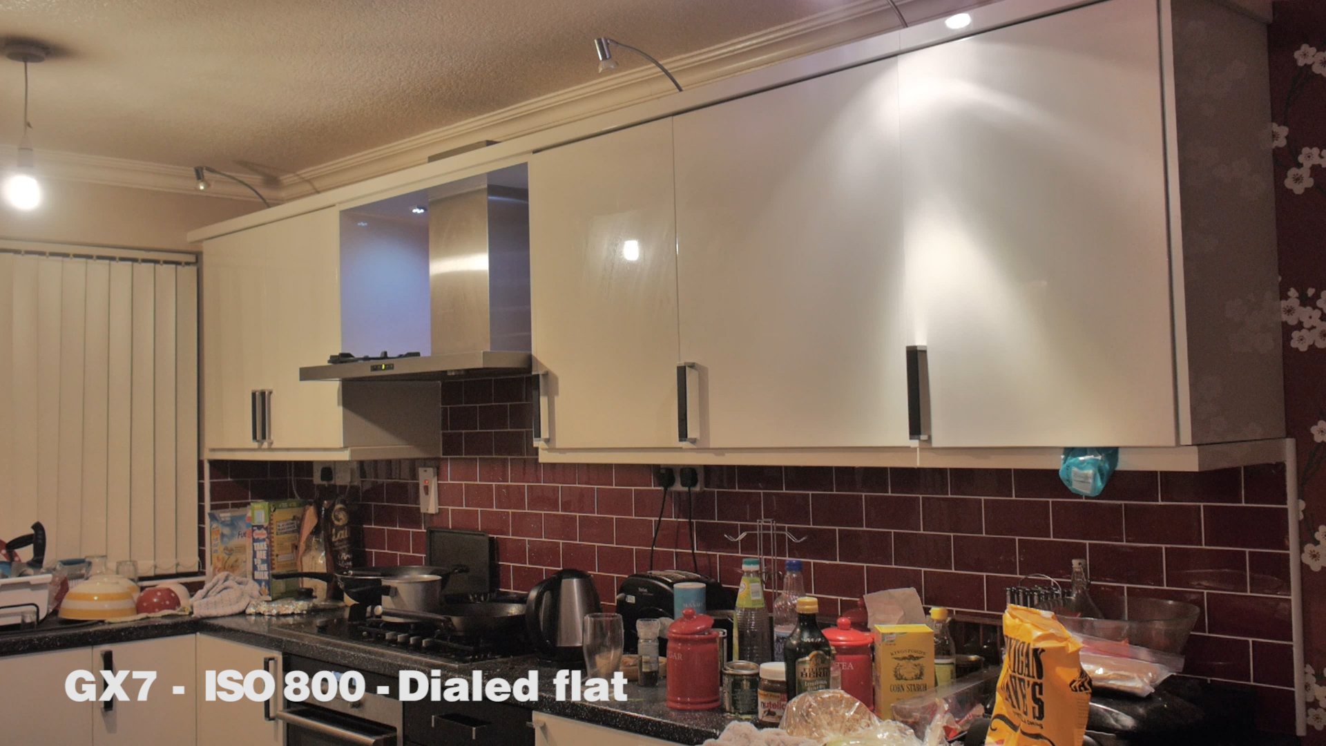

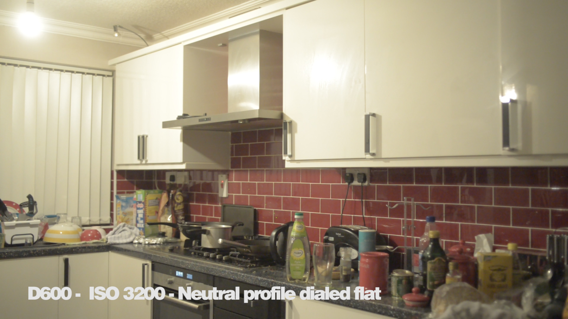

Inazuma Posted March 1, 2015 Author Share Posted March 1, 2015 Just an update to this post. I actually have ended up getting a D600 (for just £580!). Again just to reiterate it's mainly for photography as I have two nice AF lenses but I've been wondering about its capability in video.First of all, yes moire is very present. Haven't spotted any aliasing yet though.Noise is really bad. Very large and colourful 'grain'. With the same exposure settings, the highlight retention is worse than my Panasonic GX7.However things get a lot better when you load the Cineflat profile. You can use exposure values that technically mean you're underexposing, but in practice you're saving the highlights whilst bringing up the shadows naturally. With Panasonic cameras you can use iDynamic to raise shadows but the sensor never really 'sees' into the shadowed areas (because theyre underexposed), so the 'roll off' into blacks is quite steep.See attached images. Sorry about the boring subjects. I just had to do some quick tests because I'll be shooting a promo with the two cameras tomorrow. Link to comment Share on other sites More sharing options...
leeys Posted March 1, 2015 Share Posted March 1, 2015 iDynamic is horrible, I never use that on my Panasonics.The first image looks terrible though. It's looking rather mushy, and the moire isn't helping!That's a good price on the D600, it'd be worth it anyway just for stills alone. Link to comment Share on other sites More sharing options...
tdonovic Posted March 1, 2015 Share Posted March 1, 2015 You do realise that equivalence wise, its the same image. f2.8*2x crop = f5.6. So dof is the same. But you can shoot at one stop slower iso for a cleaner image, plus the sensor is actually good at video. Idk guys, the only place where the d600 would win is if you want to shoot at <5.6 for the dof. Otherwise the m4/3 camera wins, surely Link to comment Share on other sites More sharing options...
Inazuma Posted March 1, 2015 Author Share Posted March 1, 2015 The m43 camera wins for detail, punchy colour, fine grain noise and lack of moire/aliasing. The Nikon FF wins for dynamic range (only when using the cineflat profile), natural colour and shallow DOF. It's just horses for courses. Both types of camera have their uses. Welcome to the forum BTW :) Link to comment Share on other sites More sharing options...
